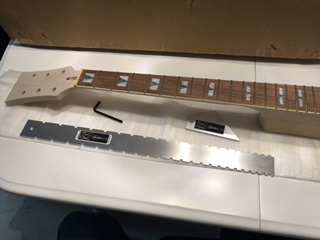

    Hello All,
    Stating to get at my ES-3 kit. I first wanted to get the Neck perfectly straight and do my frest work before anything else. That being siad the neck currently has a fairly significant back bow in it therfeore i am loosening the truss road 1/4 turn at a time to bring the neck back to straight. It is very very difficult to turn the truss road. Just seems very tight. I wanted to check in with someone who knows what this action should feel like so that i do not mess anything up.
    any suggestions?
    theres a photo attached to show what i am working with.

    1/4 turn at a time? I reckon you've stripped your truss rod.....
    Hey,
    i doubt it is stripped. doesnt feel like it anyways. if it is then it was stripped when shipped to me. i have barely touched it since getting it.

    Holding the neck in the playing position, turning the adjusting nut clockwise should loosen the truss then the double action truss rod should start to pull the neck forwards.
    If this isnt happening there may be a burr on the thread that is fouling the doings up or you just have a rather tight truss rod..
    Try clamping the neck (at the heel) onto your workbench then gently push the headstock end down whilst turning the adjusting nut.
    By doing this you are taking the pressure off the nut and it may just turn more easily.
    Hope this helps, keep us posted!

    The reason your truss rod is tight is because it is feeling some pressure between the fretboard and the neck itself.

    hey guys,
    thanks for the comments. i followed dingobass comments and the neck is now perfectly level and ready for fret work. when i put the strings on hopefully their tension will add a minimal amount of relief but well find out when i get there!
