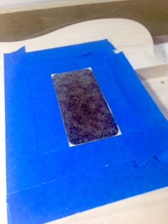

    Long before I decided to build guitars, I restored/refurbished boats. I've gotten pretty good at interior joinery as a result, working with marine products and finishes.
    I've decided to apply some of this experience to the latest build. The oversized neck pick up cavity needed filling and re-routing, so instead of filling it with a block and glue, I filled it with epoxy.
    I started by running a paper straw up the wiring hole, and sealing this off, to be discovered later.
    I then mixed up 100mL of 2 part epoxy, thickened with teak sawdust I kept from a recent yacht restoration. I poured it carefully into the cavity (it's 93mL) and used a lamp to keep it warm through what is still a chilly night.

    I'll finish with some Epiglass filler, which is very easy to sand, then re-rout with a telecaster neck template.
    I wonder if the dense surround will have a favourable acoustic result?

    just seen your post Moose, think the epoxy should work well. If they make epoxy body guitars sure it will sound fine.
    Love the cool spray booth idea, nice cheap option
    wow, nice fill Moose!
    I personally doubt that it will have any effect other than what you want
