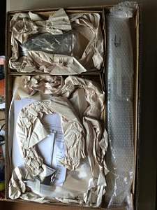

    So this is an ST-1 I bought in the 3rd Anniversary Sale. Seemed like a good excuse to buy another kit.
ID:	5000Click image for larger version.
    Still figuring out what I'm going to do with it.

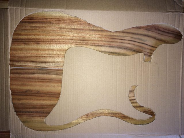

    So learning new build skills. I wanted to do a veneer. The basswood ST-1 is a bit plain, so it seems like a good candidate.
    I have some camphor laurel bookmatched veneer.
    Cut a cardboard template to see what it might look like strat shaped...
    And again, slightly moved over.
    hnnng...
    Hopefully there'll be some veneer left to do the headstock as well.
    Things I don't know about applying a veneer? Just about everything.
    Questions I've thought of so far:
    • What sort of glue?
    • How to cut the strat routes, before or after gluing the veneer down?
    • Should the veneer be soaked to flatten it or just pressed flat when glued?
    • When veneering a headstock, glue it before or after shaping?
    - Sam
