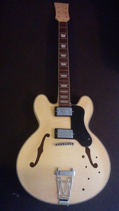

    Received my ES-1GT kit a few weeks back now, but only just got around to mock assembly and hopefully starting the sanding and fixing this weekend (In between language study and Elite Dangerous... Yet to see if I do make a start)

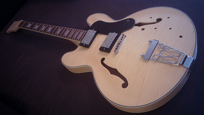

    Mock build & Problems to fix :
    As I have seen in other build threads of this guitar, the cavity for the heel is a bit too small and needs a tidy up overall in the area due to the wood being very 'sandy' and choppy in texture. The neck pickup here also does not fit into the slot which user Eric overcome on his ES-1GT by simply sanding a small amount off the pickup, you can see his amazing build here : http://www.buildyourownguitar.com.au...ead.php?t=6244
    I didnt take a close up picture of this but I did find a small blood dot seeped into the surface of the guitar? Hopefully the person didnt hurt themselves too much when that happened *Sending thoughts out*.
    Color plans:
    The body will be the fun part, Im thinking a bright deep orange color with a single cream/white stripe running parrellel from the neck across the guitar.
    (As for the white stripe, it may look better with 2 black lines encasing it, or 2 white lines just outside of it. Think racing car sort of stripes).
    Im planning on doing the neck with Minwax Satin, the same I have done on my TL-1TB build.
    The paint choice will be duplicolor touch up cans, followed by the duplicolor gloss coats, then polished out.
