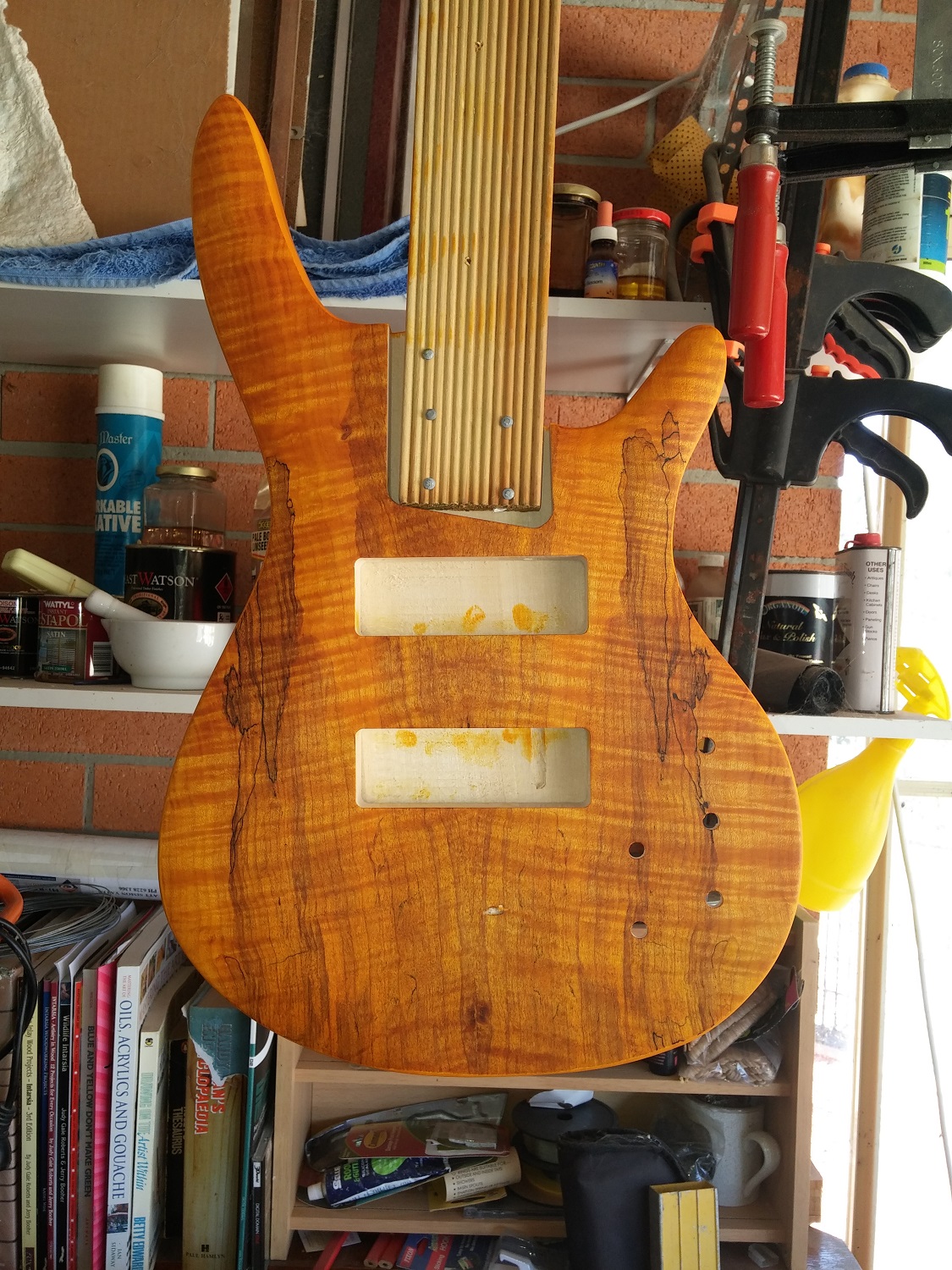

    Some progress pics, did the staining today. The Coolangatta Gold has turned out much more orange than I expected it to, but I'm happy with it. Decided not to stain the back and sides different, might save that for another kit.
    Neck finished in clear Dingotone and looks great, and the headstock is finished in the same gold as the body

    In hindsight I'm actually not particularly happy with the finish, it's gone incredibly orange. Looks a lot more gold in photos.
    Is there any way of changing it at all, adding another colour etc or am I more or less stuck with this?
    Hi Brett, what colour are you looking for a lighter yellow ? Not much you can do with the cap as they are thin I'd leave it. DB may be able to send you out a white mix that you can add to the CG to make it lighter.
    The only way to lighten the back/sides is to sand it back a bit. I'd use the grit you last used so probably around 320 grit so you don't leave any marks.
    I've built one of thse kits with the pre-amp and it sounds great with the stock gear
    I was hoping for a slightly more gold colour, like in the demonstration videos and the example pictures. I was pretty happy with the cap actually, but the basswood is very, very orange. That could just be the wood and my expectations being incompatible though! I'll try sanding the back and sides down a bit, and see if that helps, thanks Wokka!
    I saw your build and what you'd said about the SBK pre-amps and how good it sounded, so I figured I'd go for one too
    no worries Brett. Not sure why the CG has gone orange on basswood. The colour of DT changes a little as the oils take a few days to cure. Maybe see how it looks in a couple of days and post a pic and we'll help you make a decision.
    As more coats go on you may end up coming around to the colour.
    I was a bit surprised at the colour too, haha. I think it will benefit a lot from not being quite so matte, so after the final coats go on and it's a little bit glossier it will be nicer. I'll give it a few days and see how it goes. It's not so much that I don't like the colour, it's just not quite what I was expecting!
