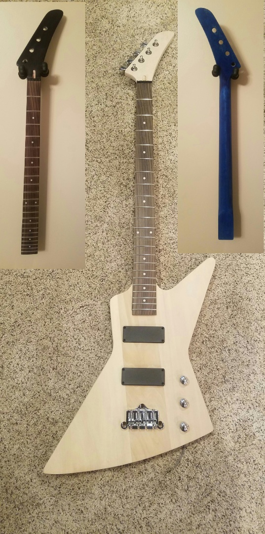

    Got my kit in the mail today everything fits perfectly!
    Might as well start with an overview of what my build will end up as.
    Ex-4 specs:
    Color: Behlen Solar lux "Sea Blue" on the body and neck
    Black headstock
    Black custom pickguard
    Brass nut
    Hipshot machine heads with drop D "Bass Extender"
    Stock humbuckers with split coils and a 6 way switch
    2 tone pots
    1 master volume pot
    I figure nothing says 1984 better than a black n blue explorer! Pics coming soon

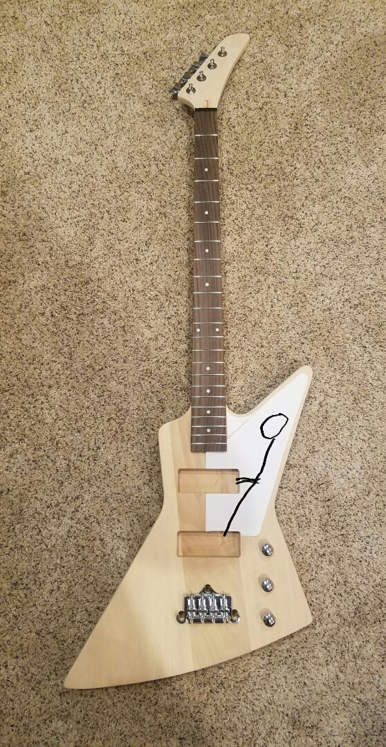

    Got lots done this week, the neck is almost finished it just needs a few more coats of lacquer and my custom headstock logo. I'm loving the way the blue stain turned out because it still shows the grain from the maple neck and it kind of gives it that worn vintage feel with the satin finish. I also traced out a pickguard on a piece of paper, and the black lines show roughly where I will have to rout in order to install my 6 way toggle switch.

    Thanks! I really want to start on the body but I can't really do anything until I get the extra bits routed. I don't have a router so I'm going to have to wait until my buddy is free to let me use his Woodshop for a weekend.
    Ok, so you are going for a traditional 6 stringer looking scratch plate & 3 position switch.
