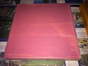

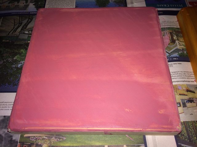

    After some sanding, applied the grain filler as per the instructions on the tin.
    Lumped on and spread with a rubber edge spreader diagonally to the grain.

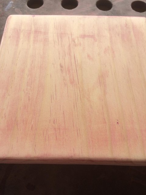

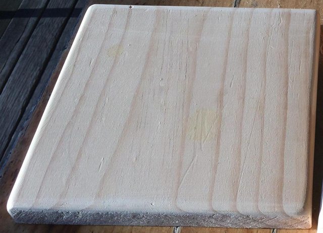

    Left to dry for a week (not intentionally that long), then sanded it back.
    The grain filler sanded off into a fine powder much easier than I though it would as it seemed to have dried quite hard.

    Is this what it should look like?

    Looks good to me.
    As long as you cant see any holes, valleys or bomb craters I would say it was a success
    looks good.
    A test my Dad taught me for checking smoothness (this was for painting cars): Shut your eyes and run your hands over it. If it feels smooth , it is.
    If you can feel an irregularity, you will see it when you paint it.
    And if it's still not smooth, repeat the grain filler?

    yeah, but be realistic too, and the paint will fill a little too
