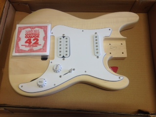

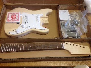

    Received an ST-1JR today and will be building it for my daughters 8th birthday in July. I would be interested to hear from anyone who has built this kit as I can't see any thing on the forums. That being said I will post progress photos as we go.
    So for those that don't know the ST-1JR is a 3/4 strat kit mine has a 4pce basswood body maple neck and a rosewood fretboard. I'm impressed with the body has very little routing tearout, only a small 2mm piece at the back which will be no problem. The timber is not grain matched but it will be fully painted so again no problem there. Also got lucky with the fretting on this neck it is the best I've seen on a Chinese kit, have had 2 others in the past one needed 2 frets replaced the other needed a heap of fret dressing to get it playable..Not from you Adam so don't worry!
    The guitar will be painted Red and my daughter loves Teen Titans so will have them painted on the front with Posca Art pens, they are a water based paint texta tha'ts used on surfboards and skateboards so should be fun.
    Here's a couple of photos today from the box

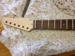

    Did a test fit today all looks fine. Sanded the neck down and cut the headstock shape, it will just have an oil finish (can't mention
    t-oil can I?)
    Thought the body looked a bit thick for the size of the guitar, so took about 5mm off the back and reshaped and sanded it today.

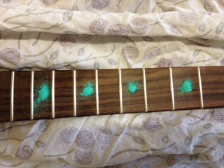

    My miss 7 going on 17 said she wanted pink fret markers so after looking on the forum (thanks DB) took out the white mots without much problem... then she says she wants white ones! Now we've settled on aqua!
    Found some Z**g embossing powder and mixed it with clear epoxy, once its set will scrape it back and see how it looks.
    When I took 5mm off the back discovered I only had about 2mm of timber in the control cavity so glued in some veneer for extra strength. We have now chosen sunset orange for the body, so if nothing else it'll be bright!
    Photos show all the above with a photo of the back trimmed down 5 mm and sanded

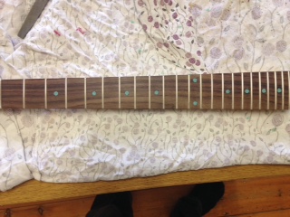

    fret markers
    And heres a pic of the headstock and fret markers
    Chisel and scraper did the trick but took 1 1/2 hrs
