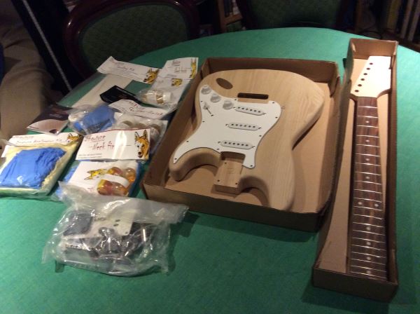

    That's what is inside

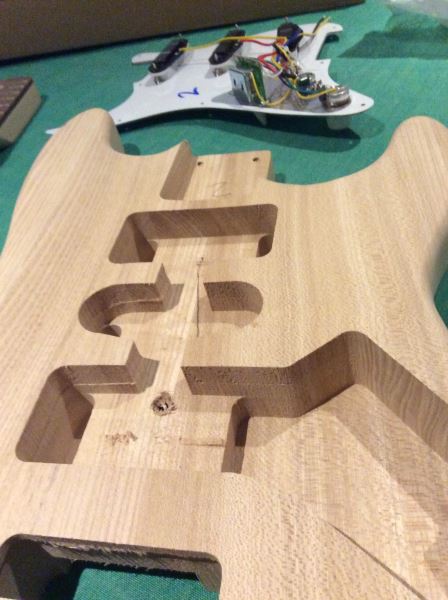

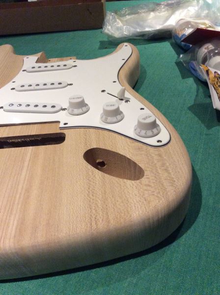

    Nice Ash body

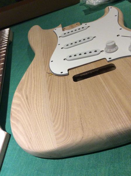

    Weird grain on the right
    With it's top off - not suitable for minors

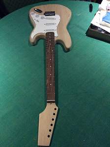

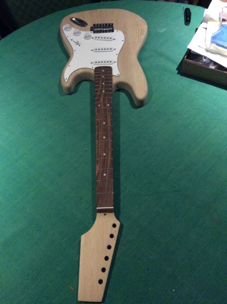

    The headstock with quick mock up
    mock build from this end
    and the other end - badly focused

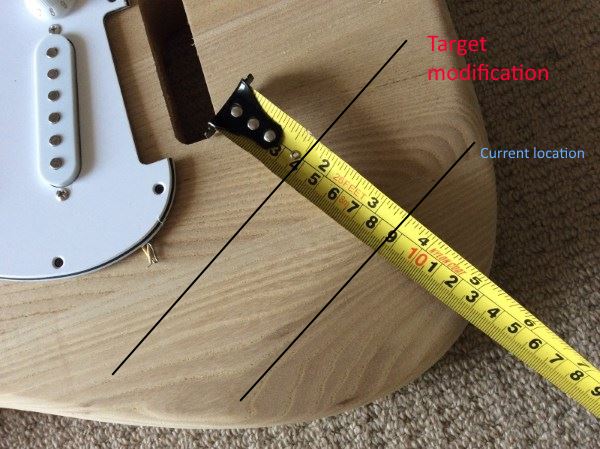

    I opened some threads and spoke to the fine people here about some ideas on modification.
    I thought the forearm shaping was too short and steep. I would extend it as per this pic
Name:	side profile.jpg

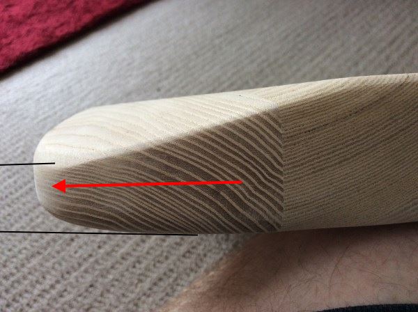

    and the thickness of the edge could be reduced as well to about here.

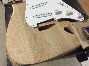

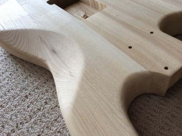

    And while I am at it, this backside shaping could do with some extension as well
    Member ScoopD's Avatar
    Oct 2014
    52

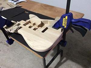

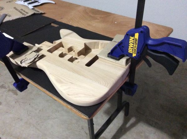

    Lets get going

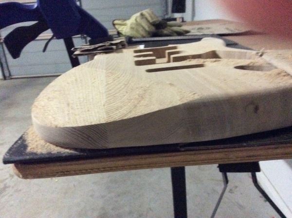

    So lets get to it.

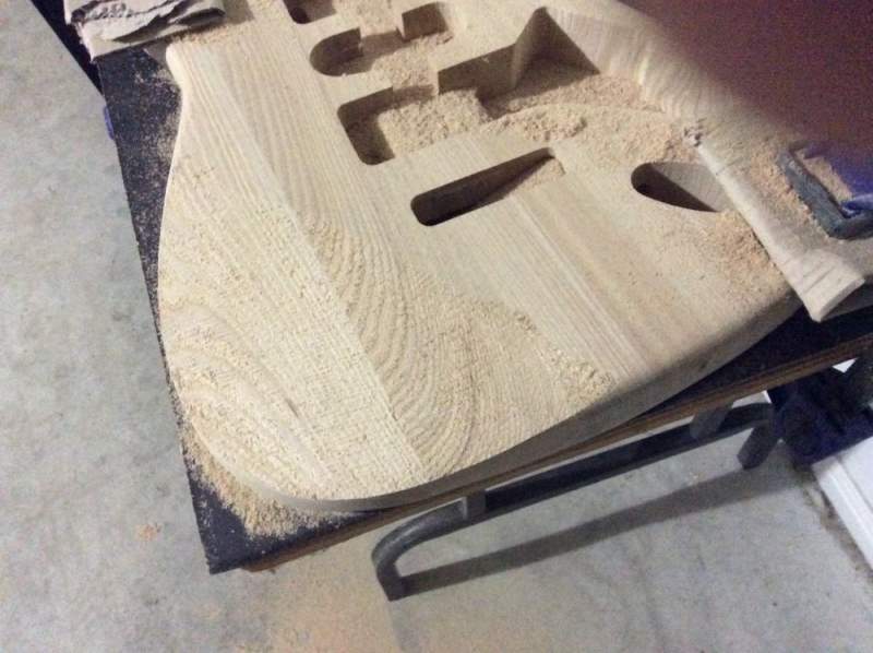

    Clamp her down.

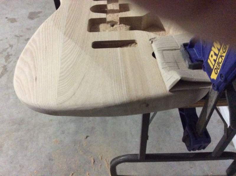

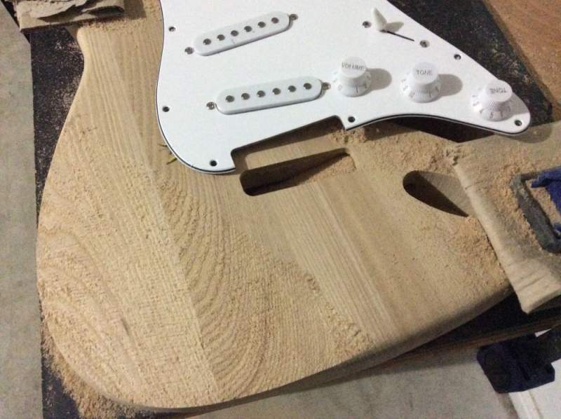

    Attack with the rasp
    Check the edge to see if I have taken enough off
    Drop the scratch plate into place to check
    Go at it with the orbital sander to remove most of the rasp detritus.

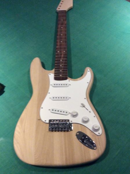

    Awesome! Great pics.
    Off to a great start. First build & hopping into the woodwork straight off the bat.
    I do enjoy watching customised kits develop. Keep at it . . .
    extended elbow cut looks great Scoop, plus it would have lost a bit of weight too after you enlarge the tummy cut.
    Looks like you scored some nice ash grain !

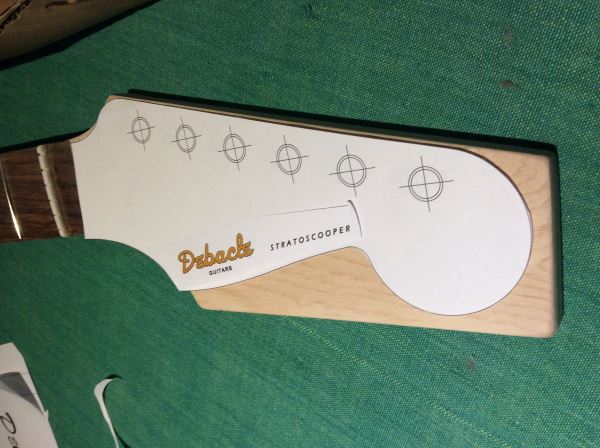

    The plan is a natural finish on the body. For the neck I bought the "Acacia" finish, but I would like to get it to more of an "vintage amber" colour. Not sure if I will need to add something to the Acacia yellow (some drops of the new Brown or maybe the outback sunset?) or it just means more layers. I don't have any scrap maple to test on unfortunately.
    something like this -
    http://www.themusiczoo.com/images/4-...Z9544775_c.jpg
    good stuff Scoop,
    think if you put enough coats of acacia (I've not seen or tested this stain yet) you should get a deep enough yellow. You may find that the stain may go a bit darker after a few days curing time as the oils cure.
    See how you go after a few coats. Nice looking image !
