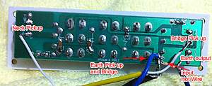

    So there are the images of the circuit board.
    This is how it comes.

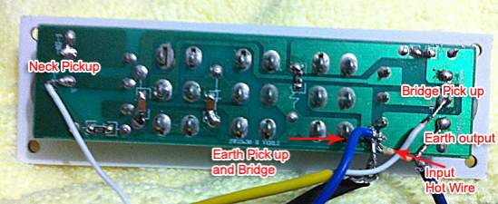

    This is how you wire it up.

    I try different combos but the only thing that work OK is to connect the bridge and pickups earths together and leave them floating. Doing this the guitar is has quite as a mouse and all controls seen to work OK. Any ideas are welcomed.
    Peter H

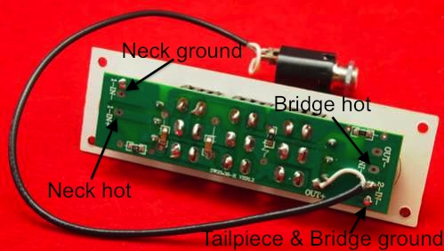

    If you've currently some of the ground wires linked to the output 'hot', then that will cause the hum when you touch the strings/hardware. The circuit board layout is slightly different to the PBG kits, but the connection setup appears to be essentially the same. From what I can see the connections should be like this:
    The Bridge pickup ground and tailpiece/bridge ground wire can connect together on the same point which links them to the output ground. Have you tried this configuration?
