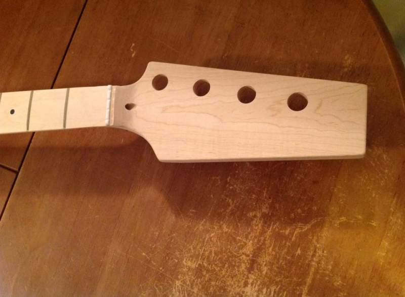

    Here's the first entry of my next build. It's an ash body Jazz bass, with a maple fingerboard.
    Finish is going to be a blue/green burst with a white pearloid scratch plate. Possible mods are a set of Entwistle JBX Neodymium pickups, and a high-mass bridge unit.
    I notice that the pre-drilled holes for the machine heads are out of alignment with the nut. I am going to get these filled and re-drilled as opposed to regrooving/replacing the nut. Anyone know if there are maple blanks available to plug these holes?
    Mentor
    Jan 2013
    Talawa, Tasmania
    1,173
    Photo of the alignment issue here.
    Moderator dingobass's Avatar
    4,491
    BG, the easiest workaround would be to adjust the headstock to suit the holes.
    Mentor
    Jan 2013
    Talawa, Tasmania
    1,173
    If I leave the holes where they are, the break angle of the strings will not be straight. Recutting the nut won't work as it'll play with the fingerboard string spacing. Plugs are the way to go in this instance.
    perhaps if you trim to shape, you can make plugs from the off cuts?
    Mentor
    Jan 2013
    Talawa, Tasmania
    1,173
    That's a good point, stan! I will save the offcuts and see what I can do.
    the only issue I see will be having enough, but I'm sure the PBG community will have some more...
    Moderator Brendan's Avatar
    Apr 2013
    3,444
    Maple veneer. Use whatever to plug the holes, then maple veneer over the top. The back will be covered by the body of the tuning machines. Maple veneer sheet ~$10 delivered from our friends on eBag. http://www.ebay.com.au/itm/Size-18cm...item339e5980f7
    Apr 2013
    3,444
    In fact - I may have a sheet of maple veneer spare here - if you're interested - I work in the city - could bring a sheet in to work this week. Depends where you are based & if I can get it to you.
    Mentor
    Jan 2013
    Talawa, Tasmania
    1,173
    Have PM'd you Brendan! Thanks muchly.
