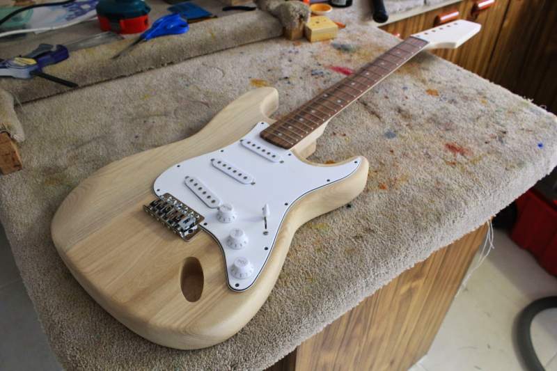

    The mock build went together very quickly. As you all know, the assembly of the strat kit is very straightforward, with only the position of the bridge to be established. To be honest, the tremelo cavity really doesn't leave much room for error here either. There's only a couple of mm play vertically and horizontally within the cavity, and with the pickguard also taken into account, it's pretty easy to see where the bridge should go. Anyway, just to be safe I consulted the Stewmac Fret Position Calculator to validate the distance of the mounting screws from the nut, and used the two E strings down the length of the neck to determine the optimal horizontal position. In no time I had the neck mounted, the bridge screwed in, and the tremelo spring claw installed. Choice as bro!
    And now for some sanding...

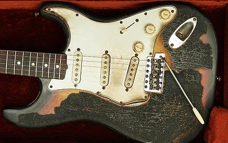

    Easy Gav, you like a tribute guitar (don't forget the lefty bridge...):
    @stan - that's a bit hardcore for me . My playing would never in a million years be able to do it justice. But while we're on that same train of thought, what about building the Hendrix Monterey fire strat?? Ha! Awesome.

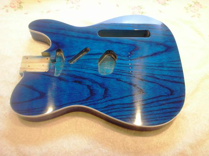

    With my musings on blue, I am now leaning towards a trans-blue finish with blue grain fill. Something like this:
Name:	trans blue front.jpg
    I've never done a trans finish before, but putting the Colortone into lacquer sounds like something I could stuff up spectacularly. Must be worth a try . Whaddaya reckon?
    absolutely worth a try, the blue looks good

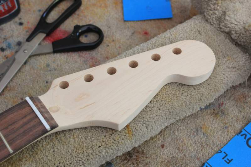

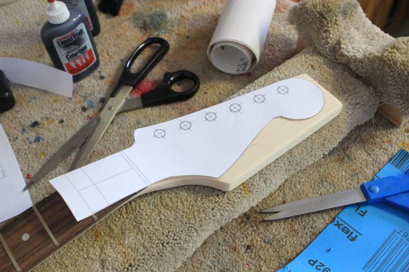

    Headstock
    Today I got stuck into the headstock. For a template I used my standard 50s Stratocaster shape that can be sourced from here: http://pdfcast.org/pdf/fender-headstocks.
    With the template printed out at 1:1 scale, I could get to work cutting the bugger out. This involved tracing around the template in pencil and then roughing the shape out with the jigsaw. Once the I had the rough shape, it was a simple matter of taking the curves down to the line using a combination of sanding wheel (for the convex curves) and a flap wheel mounted in my drill press (for the concave curves). I changed the inside diameter of the tight concave curve a little so that it fit my smallest flap wheel and negated any fiddly work with the half-round file.
    She's now ready for sanding down to 800 grit. Yay!
