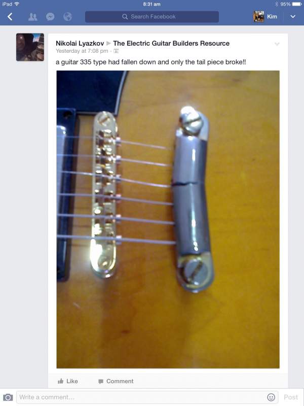

    This fortunate guy only broke his tailpiece when dropping his Gibson 335

    I assume there must have been a crack of flaw in the metal already if that was the weakest link.

    I agree with Fretty, that could only be the result of a fault in the casting.....

    Must of been , mind you when I cast sometimes porosity marks small ones on the surface when you start to clean them out theres a massive hole underneath your totally unaware of which has to be filled . I'm sure they must do the same ref bridges stop pieces

    Dunno, Kimball... I would assume that with hard metal castings they would ditch them if they had visible faults..
    My money would be on a carbon inclusion being present internally, invisible until the casting fails.
    If this Guitar is a fairly recent model the casting would have been made in China... Our Chinese friends are still a bit behind the pace with quality control on casting and steel making..
