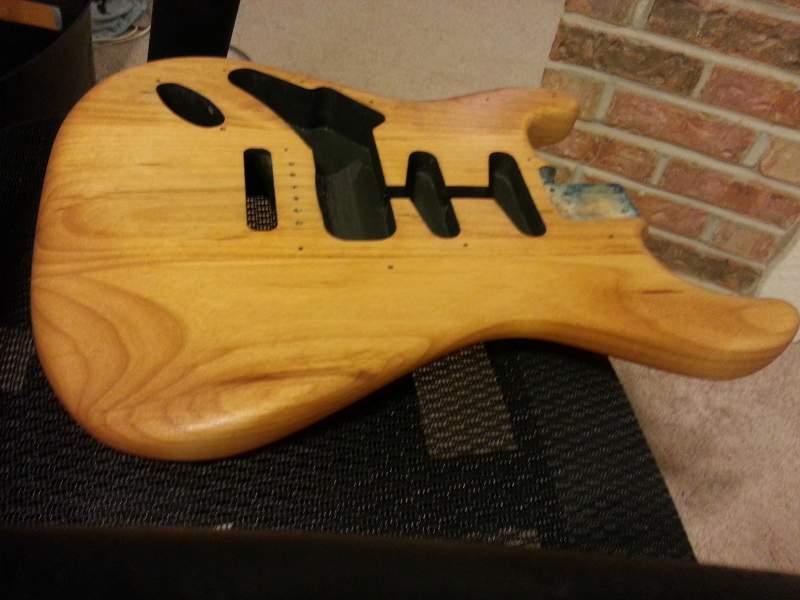

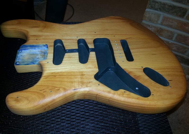

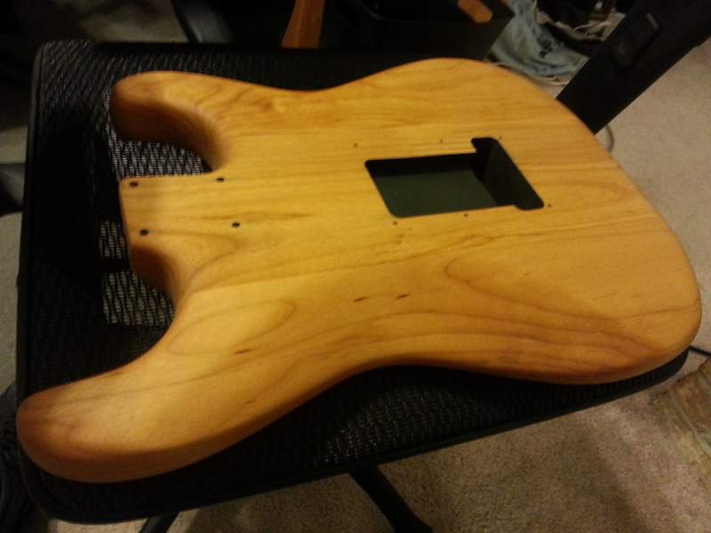

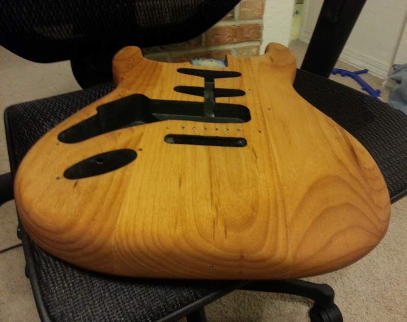

    I'm refinishing a 2003 Mia Fender Hwy-1 Lefty Strat.
    You really never know what you'll find under the paint I've stripped this down and it seems it has some nice grain hiding under there i want to do my best to bring that grain out and make it pop
    The kits that come with a Deep colour coat this is the coat that fills in the grain first ?
    I'm not really clear on exactly how Wudtone works?
    Do you have a choice of fill color ?
    What color combos do the best job bringing out the grain ?

    Hi Markee,
    so are you going to rub this back to bare wood and re-stain it ? It's got beautiful grain for an alder body. I would recommend any of the Dingotone colours. Have a look on the online store at the colours, I've tried most of them and they all look excellent
    http://www.pitbullguitars.com/dingotone/
    With DT you apply the stain coat first to get the colour to soak in then the intensifying coats make the colour deeper again. I think any of these colours will look great on that body.
    How it works you apply the stain with a rag (wearing a glove), let it cure and give it a rub with super fine steel wool between coats.
    Thanks for the reply wokkaboy
    Its already sanded down and ready to re-stain in those pictures just trying to choose a color is all

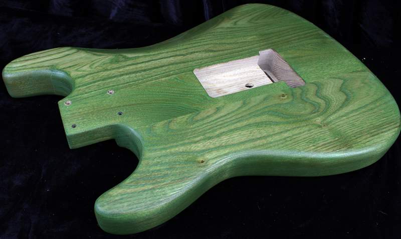

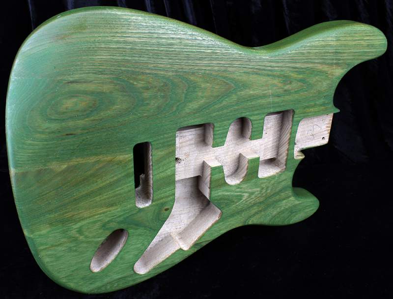

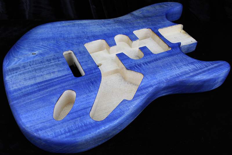

    Markee which DT colours are you interested in ? I've tried most of them and can post some pics here. Click on each colour and there may be more samples of each colour
    How about Bondi Blue and Tarkine Green ?

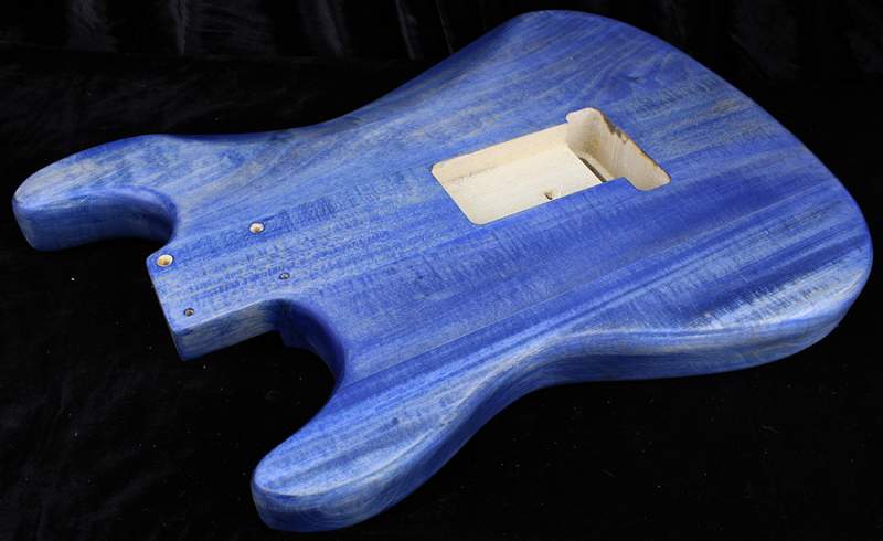

    Hey Markee, here's pics of tarkine green on ash and bondi blue on basswood. They have since had a couple more coats and are a bit darker
ID:	1203   Click image for larger version.
