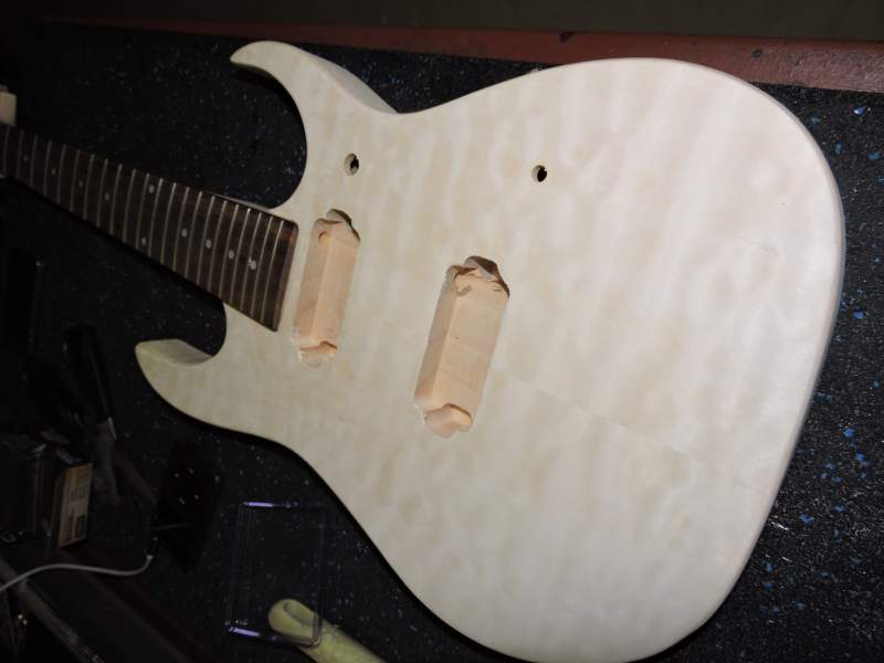

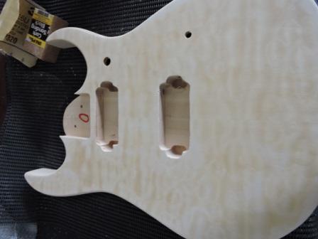

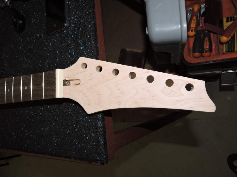

    Opened the Quilt IB7 box tonight and really pleased with the quilt on the body. The neck fit is tight as and solid. There is some cool grain on the headstock and back of the neck.
    Already have a Lace Alumitone neck and Deathbar bridge pickup to be fitted and will probably do a new nut. Still looking at hardtail bridge options ( would like a tight end R7 bridge but you have to buy a prestige ibanez to get one)
    Have no ideas on colour yet or topcoat ( bit over TO at the moment.)

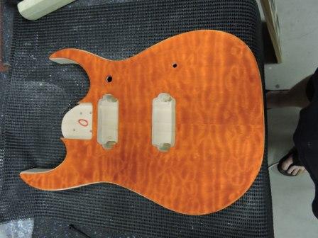

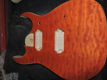

    Had a chance to do some more work again ( back from hols) and gave a quick wipe over with alcohol to suss the quilt and then coloured with a vintage amber colourtone with a drop or two of orange. Happy with the colour but now trying to figure out what colour the rest of the body should be and should it burst to the final colour. Going to put a flamed maple veneer on the headstock with flame running along the head to sort of match the front of the body.
