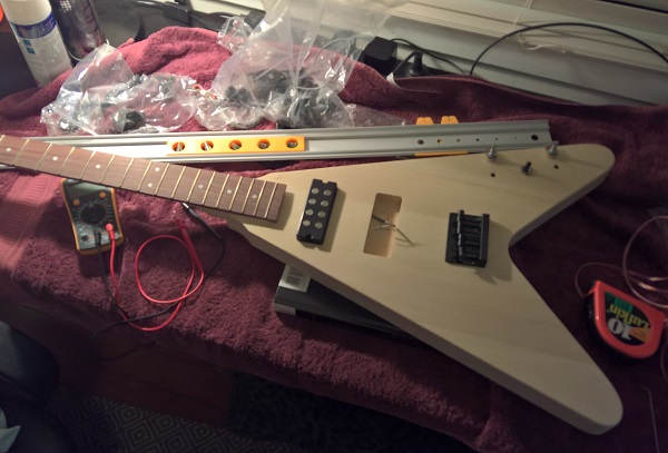

    I'm kicking off the build diary for my Flying V bass. Below is shot of half way through my mock build.
    My initial observations/notes:
    • I was blown away by the build quality and finish of the wood. There's no rough edges or jaggies to tidy up, there's just a velvety fuzz that needs to be taken care of.
    • The pocket is a VERY tight fit for the neck... I had to give it a bit of 'tough love' with my palm to get it in, so I'm a bit worried about how it would fare after a couple of coats of paint/clear coat. I suppose I'll have to be careful about making sure I get just enough paint in the area to 'seal' it without going too thick.
    • It's the lightest solid body guitar I've ever held... and I love it! It will be so easy to just pick up and jam with.
    As for design, my inspiration is The Joker from Batman. So my main colours will be metallic purple, green and white. I was blown away by the results Jarrod got with his cut & polish method, so I'm going to give that a go on my finish. I have already built myself a a mini battery-powered, twin jack amplifier. I just need to assemble the casing for it. The main purpose of it is for quiet practice where it's loud enough for me to hear my playing without pissing off my neighbours (and embarrassing myself), but will also be useful for some bonfire jamming in the back yard our when camping. The amp will be metallic purple and dark green with a yellow carry strap (yep, Robin themed...). If all goes well, I plan to buy a 6 string kit down the track to build a 'Batman' guitar with gun-metal and black colours.
    Before I plow on with my build, I had a few questions I hoped could be answered:
    • Do I need to shield the component cavities if I'm using humbuckers and grounding the bridge? The answers I find online tend to be "Yes", "No", "Depends on your pickups" or "It's not a bad idea". I'm just using the standard pickups that come with the FVB-4 kit.
    • Is it OK to pre-drill the holes for the bridge before sanding/painting? I would only be using wet/dry on the body once it has a coat of glossy paint on it, which I imagine would protect the wood. In Jarrod's glossy finish tutorial, he suggests doing the holes after the finish is complete to avoid any puckering or swelling around the bridge mounting holes. However, I'd feel a lot more comfortable about fitting the bridge if I can mark up everything with pencil while the wood is raw.
    • The guide calls for grounding the bridge, but it is coated in a heavy coat of paint (I tested with the multimeter- it's insulated, definitely not anodised). Do I need to scratch up the back of the bridge to ensure a good grounding contact? Do I also need to make sure the strings are grounded through the bridge?
    Thanks in advance for your help!

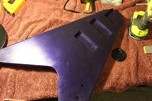

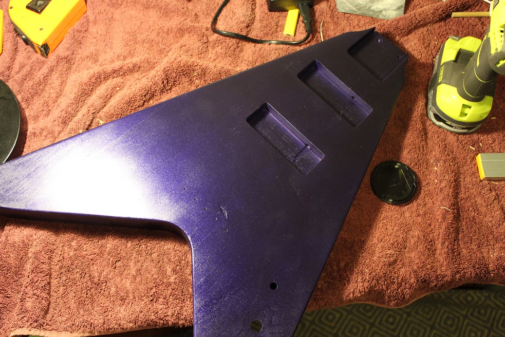

    Hi guys, just an update on my build so far. I've done a few coats of paint on the body, as per the image below. It's hard to capture the look of the colour (my phone makes it look very blue, so I had to whip out my trusty SLR to capture the purple).

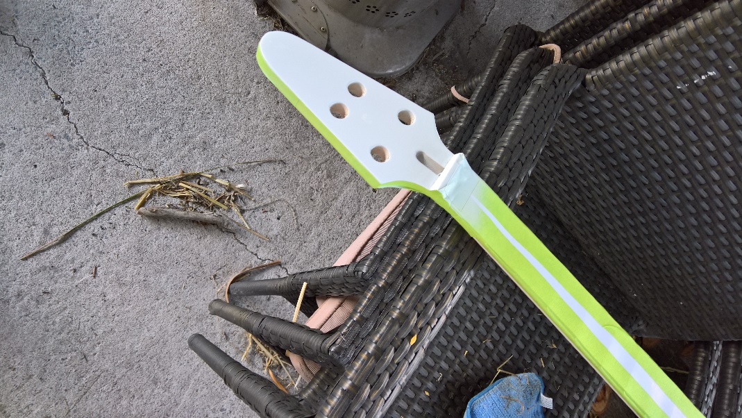

    I learned that glittery paint does not stream out of a rattle can very evenly, so I had to give the body several light dustings of paint to achieve an even colour. I also taped up the fret board with some cardboard and good quality painter's tape. You'll notice I taped around the sides of the head, as I only wanted the front of the head to be white. I'm going to leave the rest of the head and neck natural.
    My next step will be stenciling some graphics onto the body before proceeding to applying a clear coat. On that front, is there a brand of spray gloss in a rattle can anybody can recommend?
