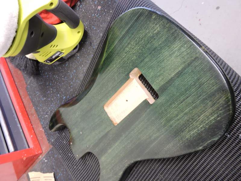

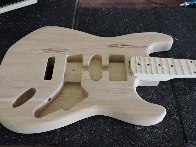

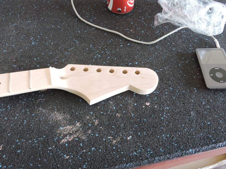

    Started an STA1 this week and after the obligitory headstock shaping ( still to be cleaned up) and a bit of colour on the body the "Green Manalishi" is born.
    Have ordered a black upgrade kit to compliment the colour.
    At this stage looking to keep fairly standard but I do have some SD Single coils floating around somewhere in the garage and may upgrade if i can find them.

    nice colour Tony, did you stain it black before the green stain ?
    Mentor vh2580's Avatar
    Cleveland Qld
    1,184
    @wokka No didnt stain black. Made up a green colourtone mix to get it as close to a forest green as I could and gave it a good 3 continuous coats of green. Added a bit of black to the mix and did a darker burst around the edges over the top. When it dried i gave it a really good steel wooling and blended the burst ( can hardly see it now at all) then made up another green mix and probably coated another 4-5 times until it didnt seem to take any more colour. Using Isophropinal alcohol as the base and seems to get more colour in. Also was a nice piece of Ash.

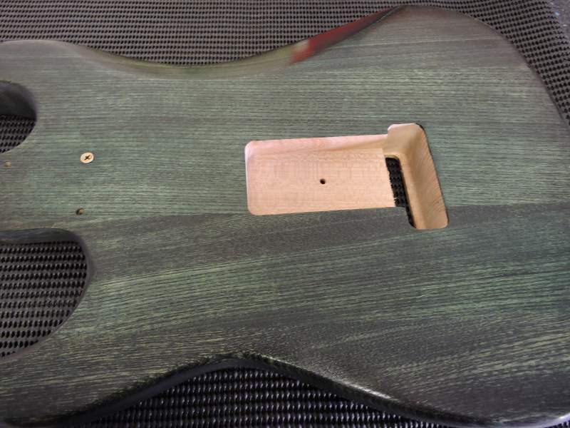

    Finally unpacked some pitbull parcels and got the black upgrade for the ST.
    Starting to get a good shine on the body.

    looks unreal with the black hardware Tony, is that naughty oil you using ?
    Cleveland Qld
    1,184
    @Wokka yep is the product that shall not be named.
