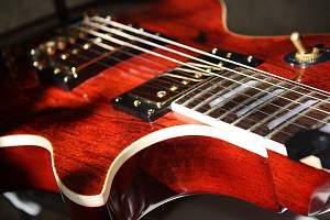

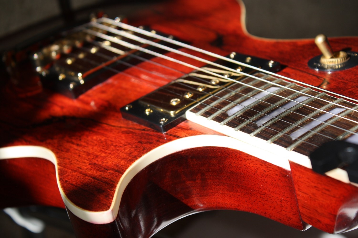

    Hi Milty, the neck angle on my LP1-SS looks like this
    I should say that i did almost no modifications to the neck heel or neck pocket. Its pretty much PBG standard
  4. Liked by: Milty
