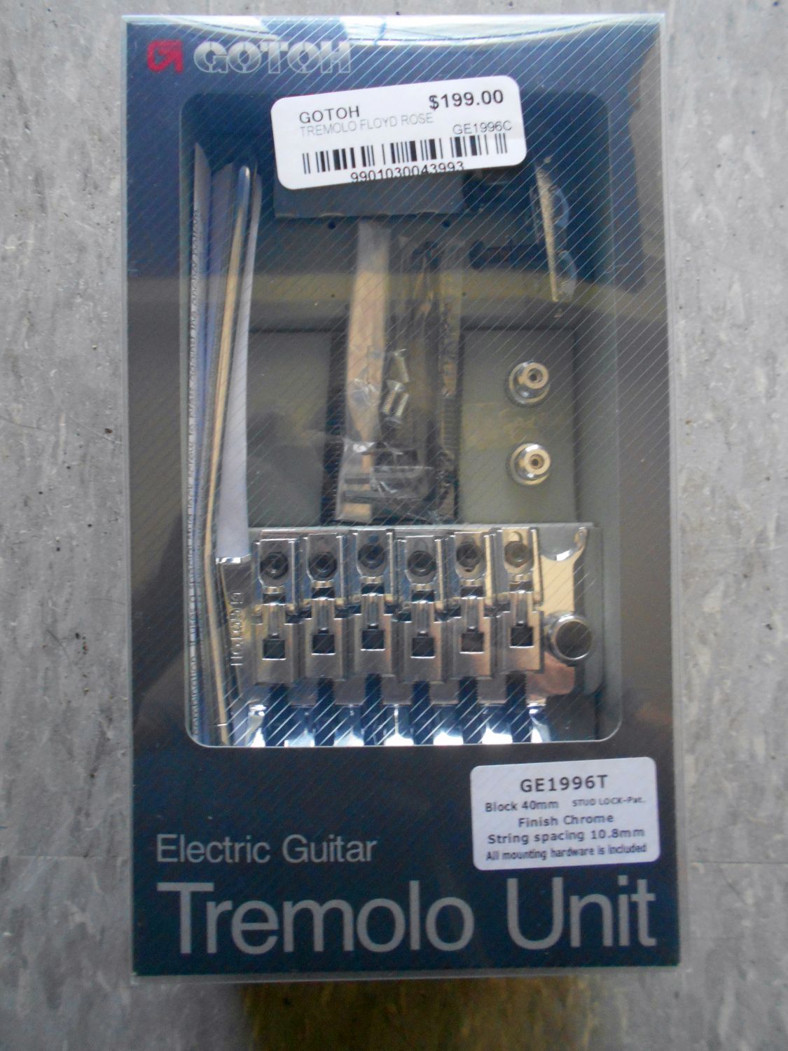

    I just scored myself a new Gotoh GE1996T Floyd Rose Trem for my Hot Rod Strat, I ordered it a fortnight ago and just picked it up from Sounds Of Music today, I also ordered a couple of Eagle Locking Nuts with it, I did a preliminary test fit of the bridge in the body routing and it seems to fit fine, even the new pivot posts fitted in the existing threaded bushings so I didn't have to take the existing ones out, I can use the new ones as spares if I need to at a later stage, the Locking Nut I've chosen to use needs some work to get it to fit though, but hopefully i will be able to get the Hot Rod Strat up and running again, here's a pic of the new Gotoh Floyd hardware, apparently these are supposed to be pretty good, even better than an original Floyd Rose, anyway:

    Things didn't exactly go according to plan, I encountered an issue with the length of the Brass sustain-block on the Gotoh Floyd, the issue is that the sustain block is 40mm long and the body of my Hot Rod Strat is not thick enough to accommodate it easily with enough clearance between the sustain block and the cover plate for the trem-spring cavity, now I do happen to have a 34mm Brass sustain-block, But, it doesn't fit the Gotoh Floyd, so what I'm going to try doing is try fitting the chrome string-saddles from the Gotoh Floyd on the Schaller Lockmeister because the Schaller Lockmeister works with the new pivot pins.

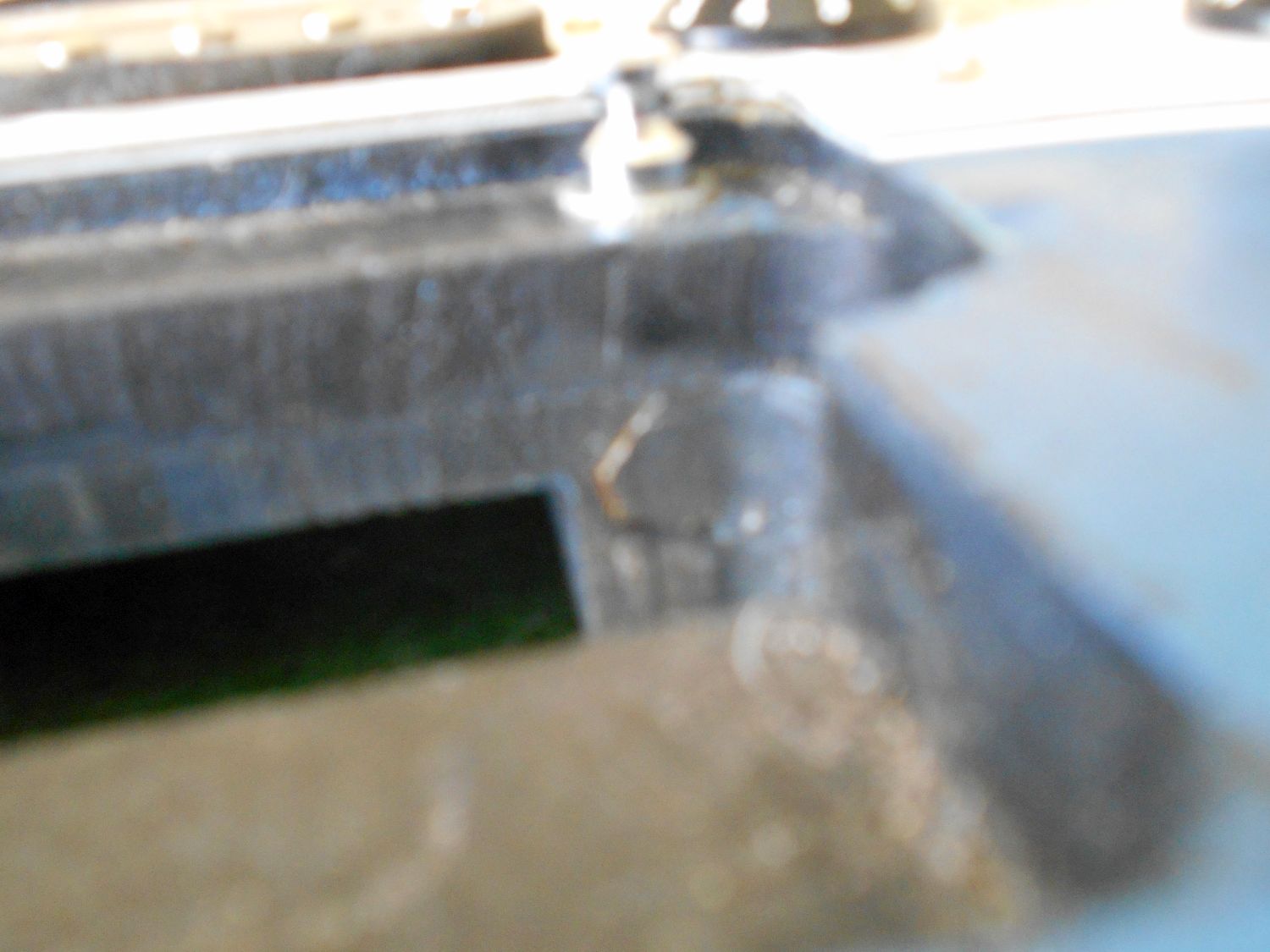

    I've just discovered a major issue with the body of my Hot Rod Strat, basically the body-routing for the Floyd Rose bridge has been positioned too close to the bridge pickup, this means I have to move each string-saddle back in order to get each string's intonation at the 12th fret accurately set, but even if I move the low E-String saddle as far back as it can go, the 12th fret intonation is still sharp, so, I may need to order a new body for the Hot Rod strat or scrap the body and neck altogether and start again from scratch.

    I thought about that, but there's not enough wood left and there's a crack in the wood where the pivot post for the high e-string side of the bridge is, so it's not going to be strong enough, I'll have to start completely from scratch again.

    Here's a pic of the crack in the wood next to the pivot post, I tried to get the camera to focus on it but this is the best I could do, hopefully you can see it clearly enough:
