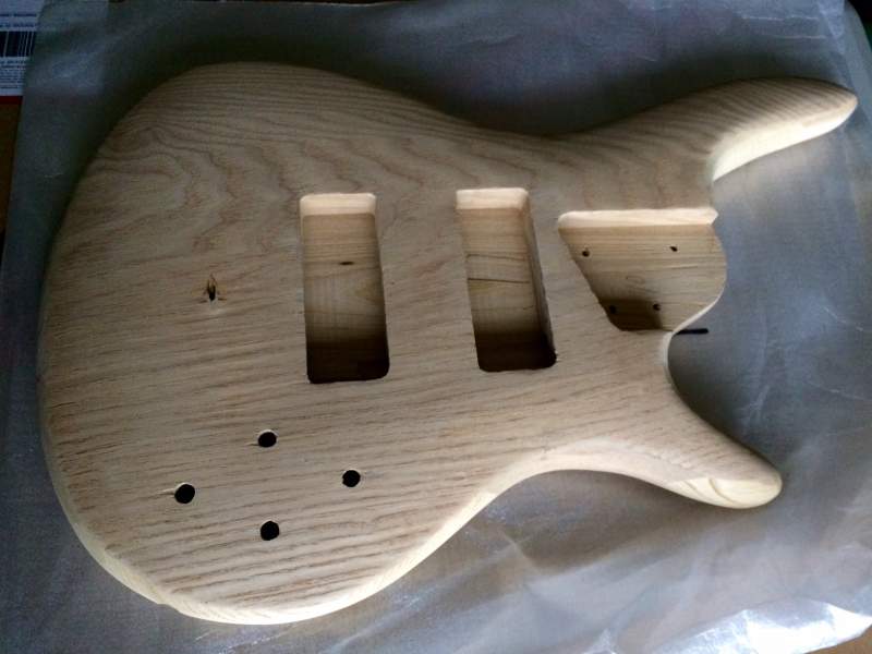

    Kit arrived last week, here's the body:
