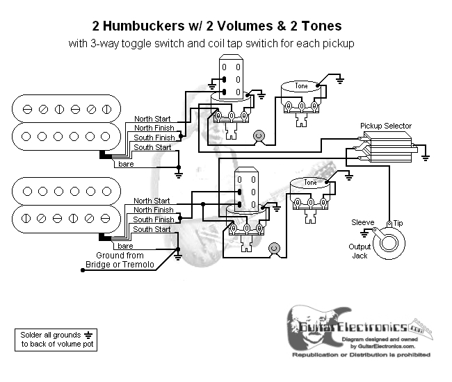

    here is a diagram for a typical LP style wiring with splits on push pulls
Name:	2 hum splits.jpg

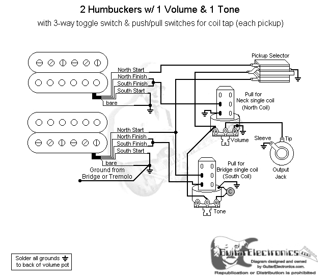

    and for single vol and tone pots
Name:	2 hums 1 vol tone.jpg
    http://guitarelectronics.com has diagrams for a LOT of combinations, if what you are trying to do isn't there, hit up Weirdbits here on the forum.
