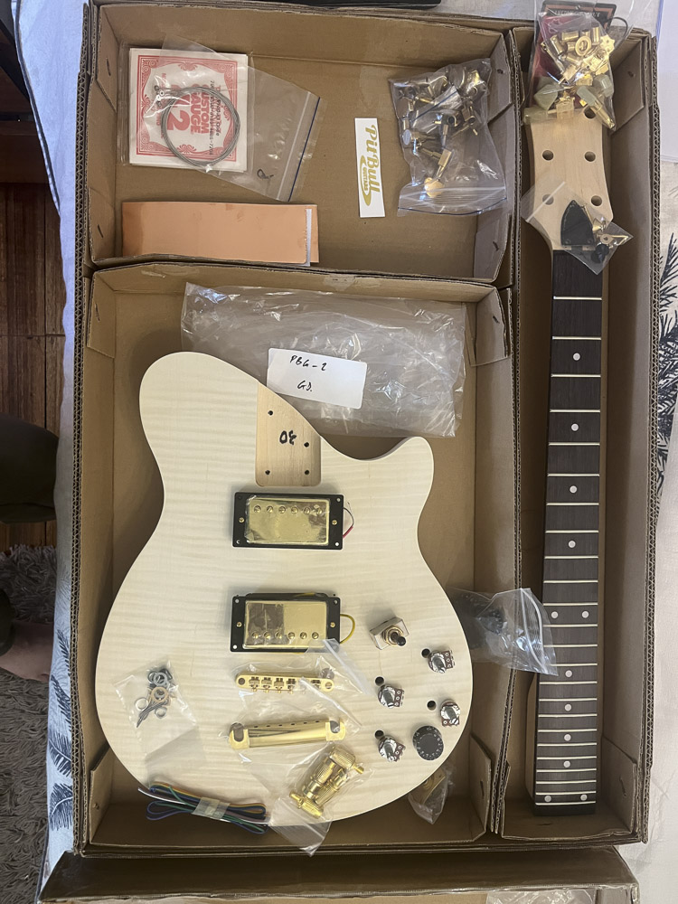

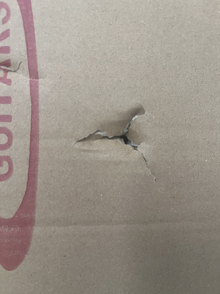

    PBG box arrived with a large centrally located puncture - first 0.0 pucker moment was hoping all the vitals were missed, which fortunately they were!

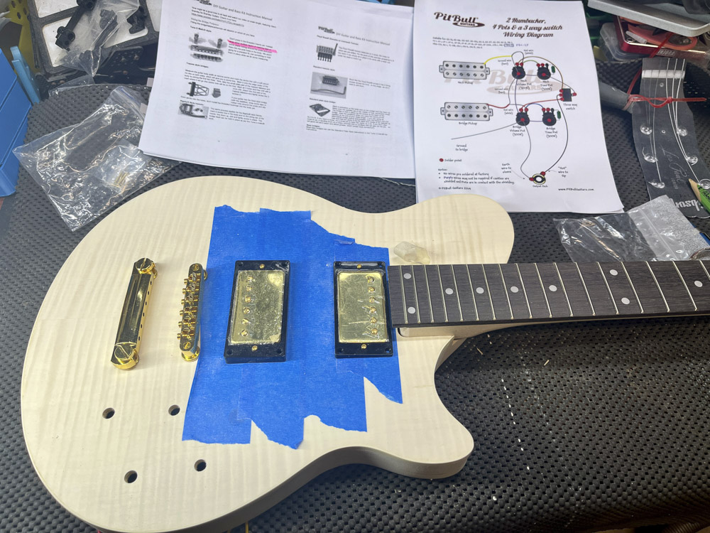

    After laying everything out, noting missing bits, and tweaking pickup openings for fit there was some chin scratching on how to shape the head. On the table is a paper template that was used to shape the head with a jigsaw.
    Fitting the neck to the body took a little fluffing around but I anticipate I'll have to do it again after getting some finish on the neck.

    I think these are some of the coolest kits. IIRC he PBGs are unique to PB, so you won't see them elsewhere. The closest I have seen to them are the Tomcat series from Sublime Guitars. I think that the PB guitar design may actually predate Sublime's design. It was a great little company that, unfortunately, went under during Covid. At least Tim won't need to send them a cease and desist letter ;-)
    Yours looks great out of the box. Glad the puncture spared that beautiful top! Is is 24.75" scale or 25.5?
    Will be looking forward to seeing what yo do with it!

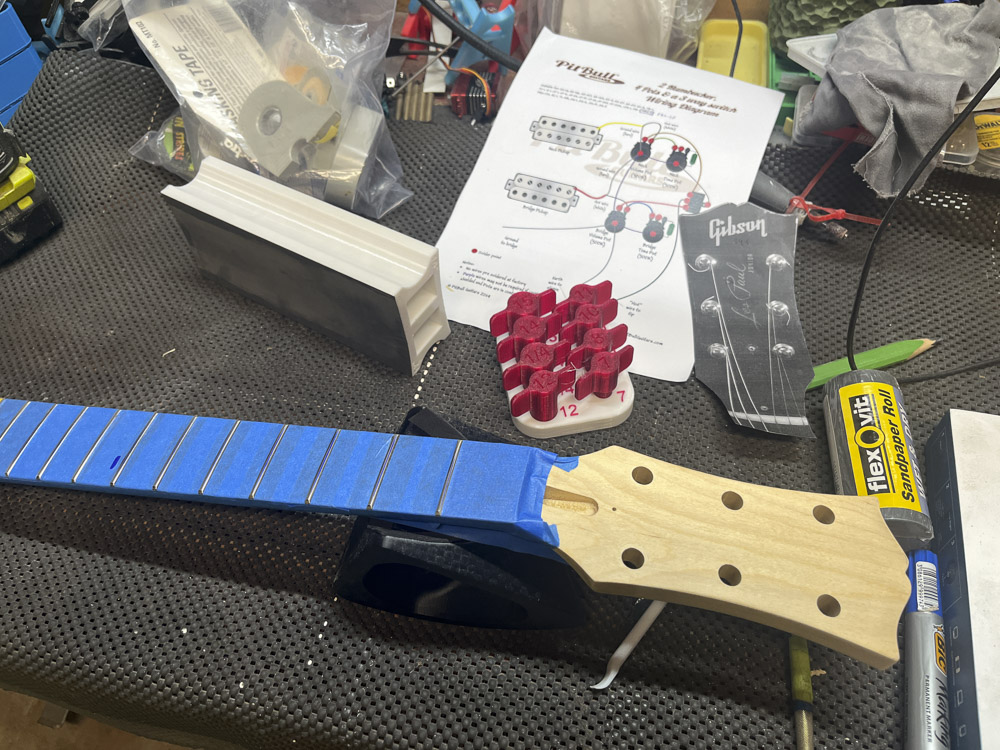

    3dprinted fret sanding blocks were very helpful for leveling everything out - only thing is...i might need another guitar kit to use them a little more ;-)

    3D Sanding block? Now I am intrigued. Please put up a pic of that ;-)
