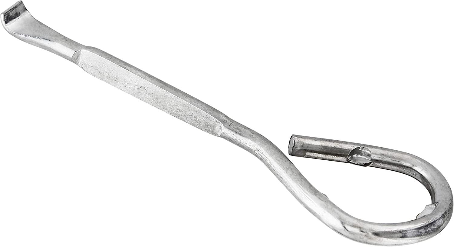

    I like the hardwood dowel approach better than what I did. I tried to pull it out by screwing the post in and pulling on that. That can get the post out, but can also strip the threads. Later I used the sophisticated device in the pic to pull it out. That was slow, but worked without stripping anything.
    Brad Angove's video is the one I wish I had watched...

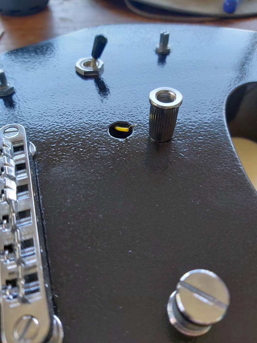

    Hi there I'm just finishing my build. I have 3 of the 4 posts for the bridge etc. I have my ground wire stuck through into the hole where I'm going to hammer the last bridge screw mount....
    ....but do I just poke the wire through and hope some of it connects with the bridge post as I hammer it in?
    Is there more to it than that?
    I've attached a photo if that helps - suggestions / advice welcome!! thanksClick image for larger version.
