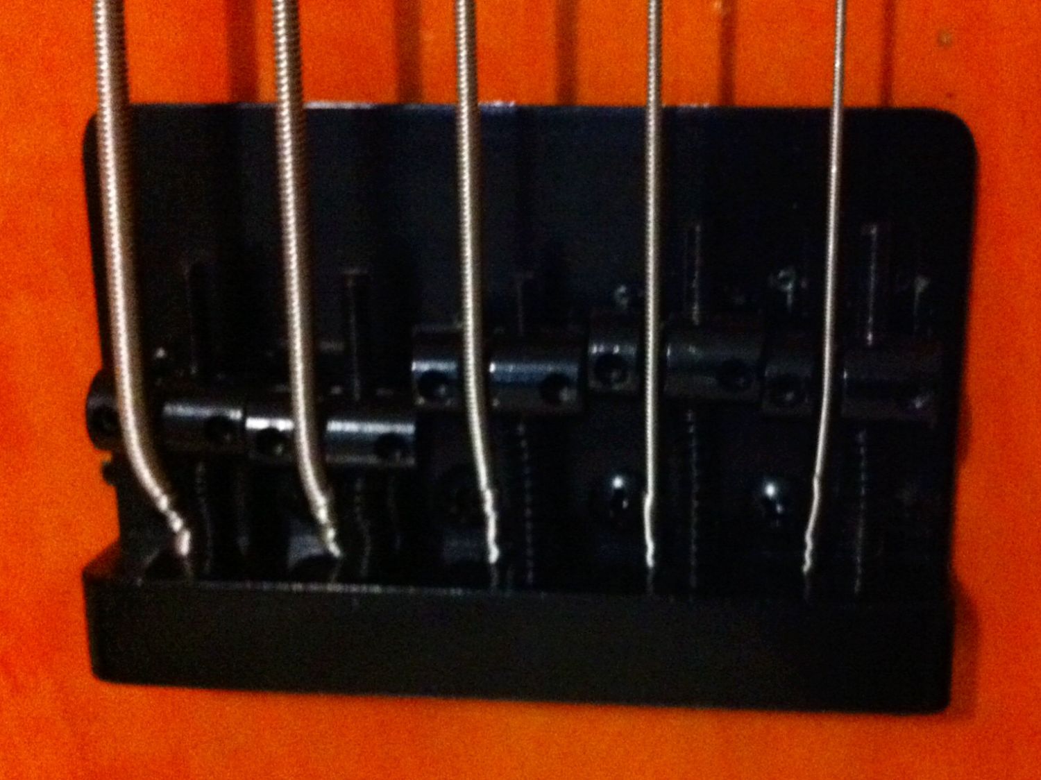

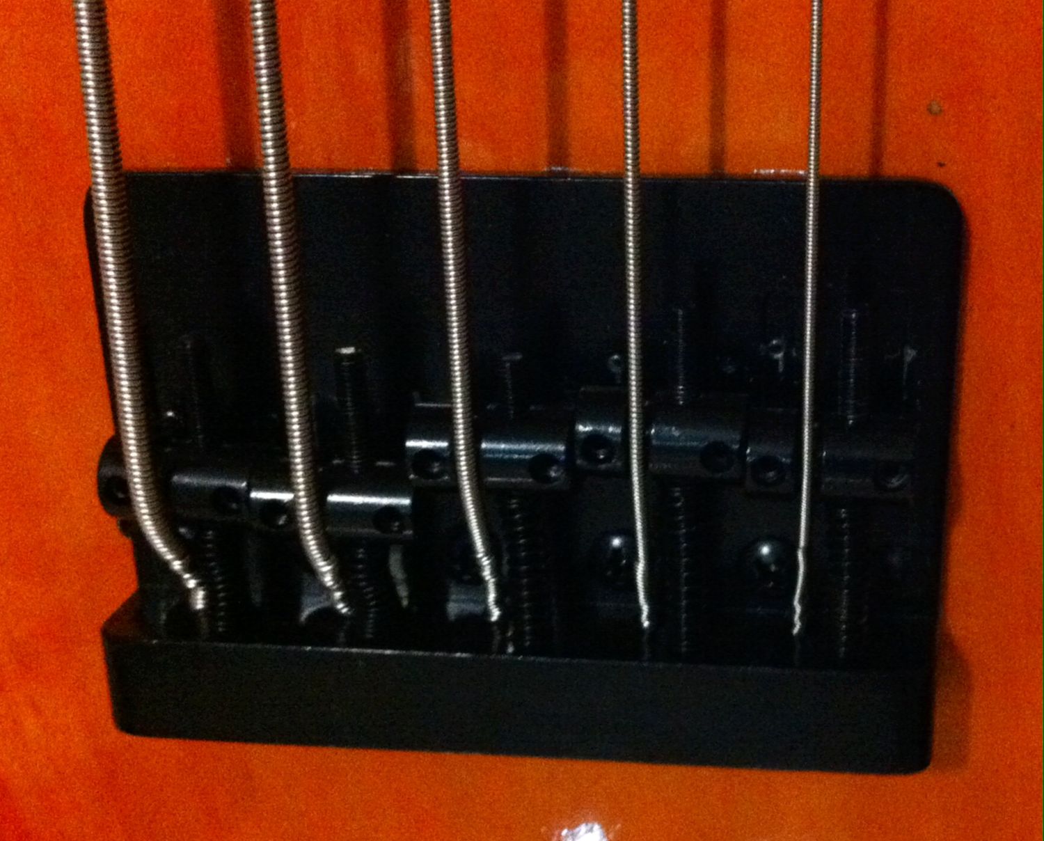

    I have just taken a couple of shots of my EX-5 bridge where Low B saddle is about 5mm further away from the nut when compared to G string. Being such a low frequency these things are hard to tune and intonate if using an electronic tuner and you may need to tweak things a bit through tuning by ear.
