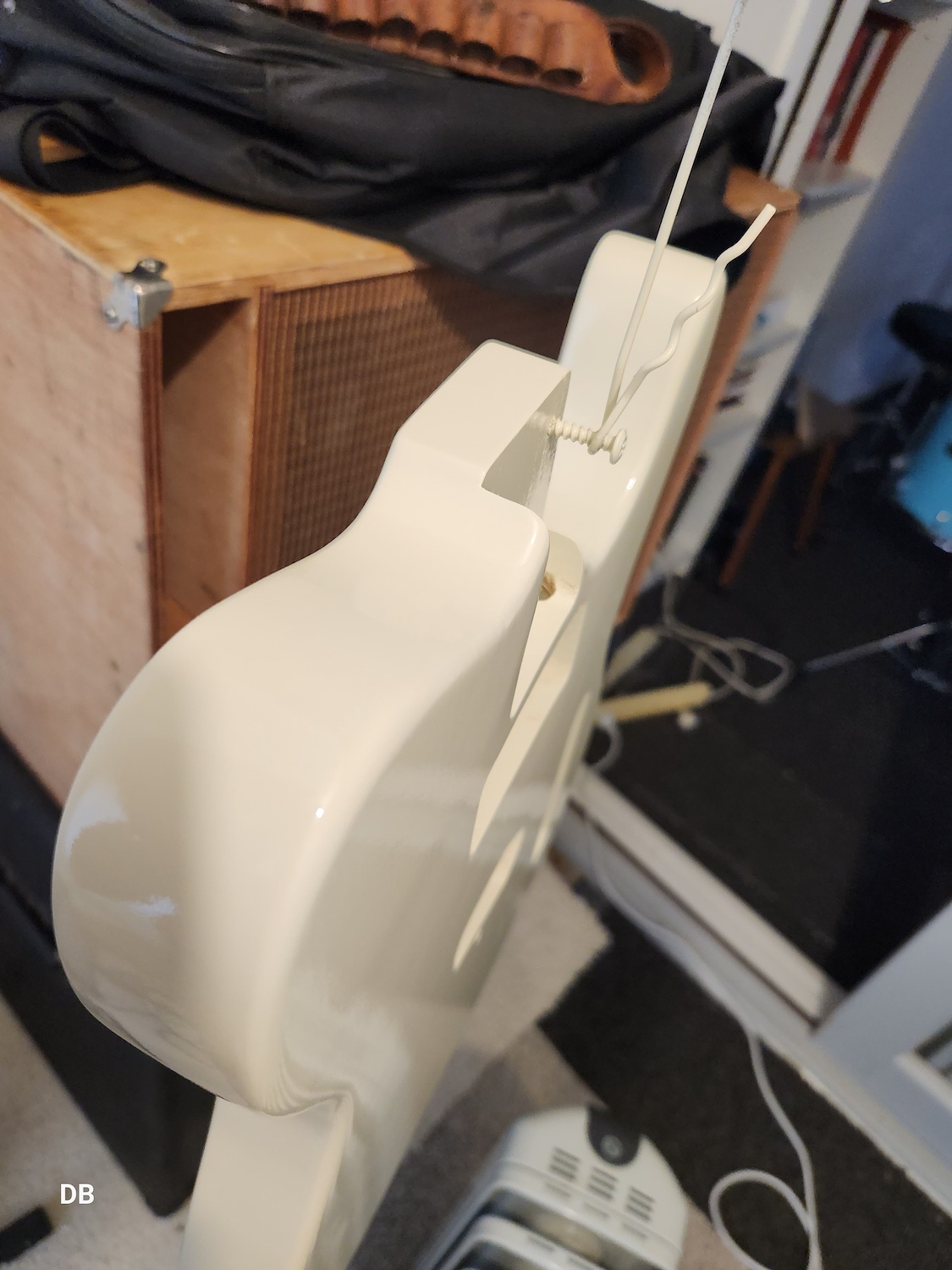

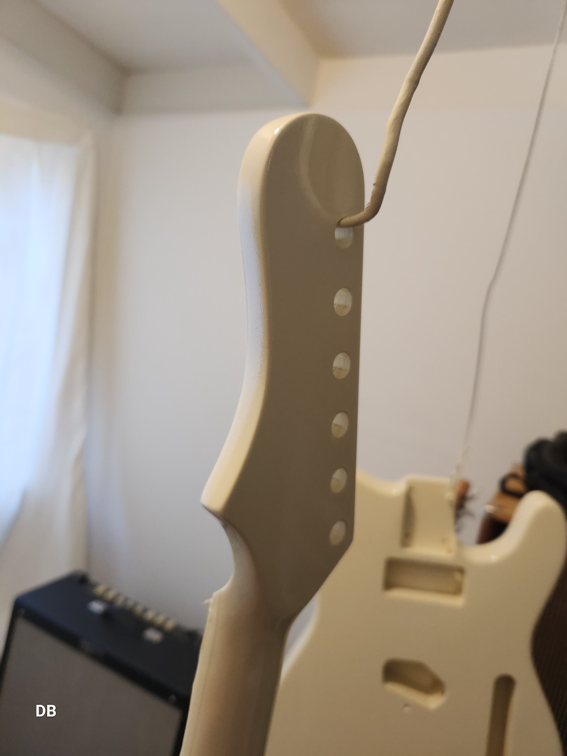

    Ive done the undercoat and several top coats and its going ok, had to sand out a few runs, there are some minor flaws i can live with,

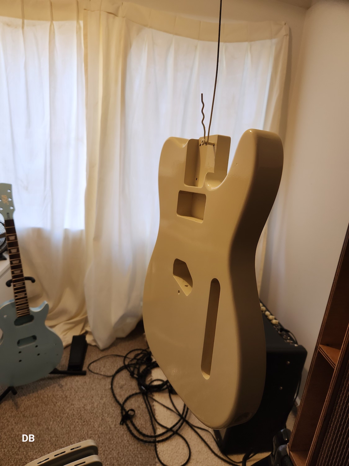

    See how we go have to do the clearcoat next now, this lot of paint cost 11$ a can instead of 50 for the nitro. Its just "Squirts' some dinky di quick drying enamel. Im happy with it for a smash out job.
    Its Ivory White, i think my sprayings getting better.

    Its only a 100something dollar guitar thats my excuse for not prepping it a bit more thoroughly. I should have bothered, i have a feeling this little Telecaster will turn out to be an ok guitar, well see.
    Got it warming with an oil heater in a small room on lowest to help it cure.

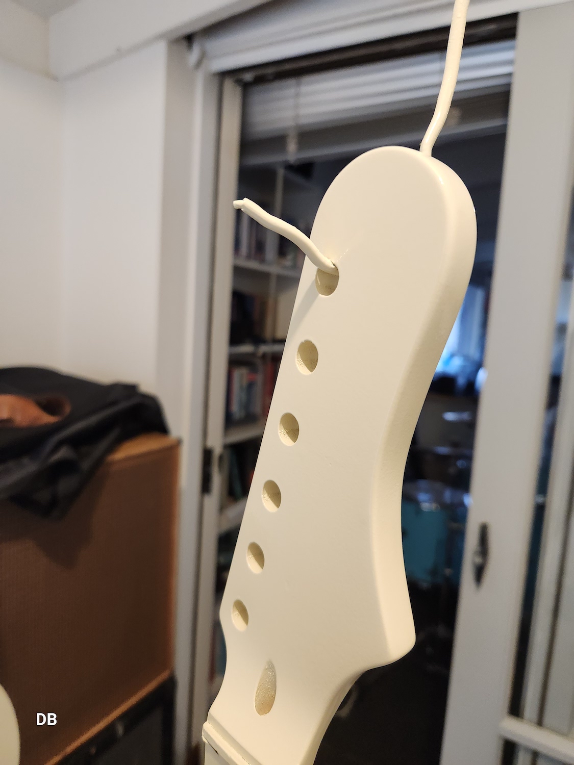

    Looking good to me.
    I can't tell from the photos, but it's definitely worth putting a disk of masking tape over the end of the truss rod nut, otherwise you may need to scrape it out before the truss-rod key fits in it properly.

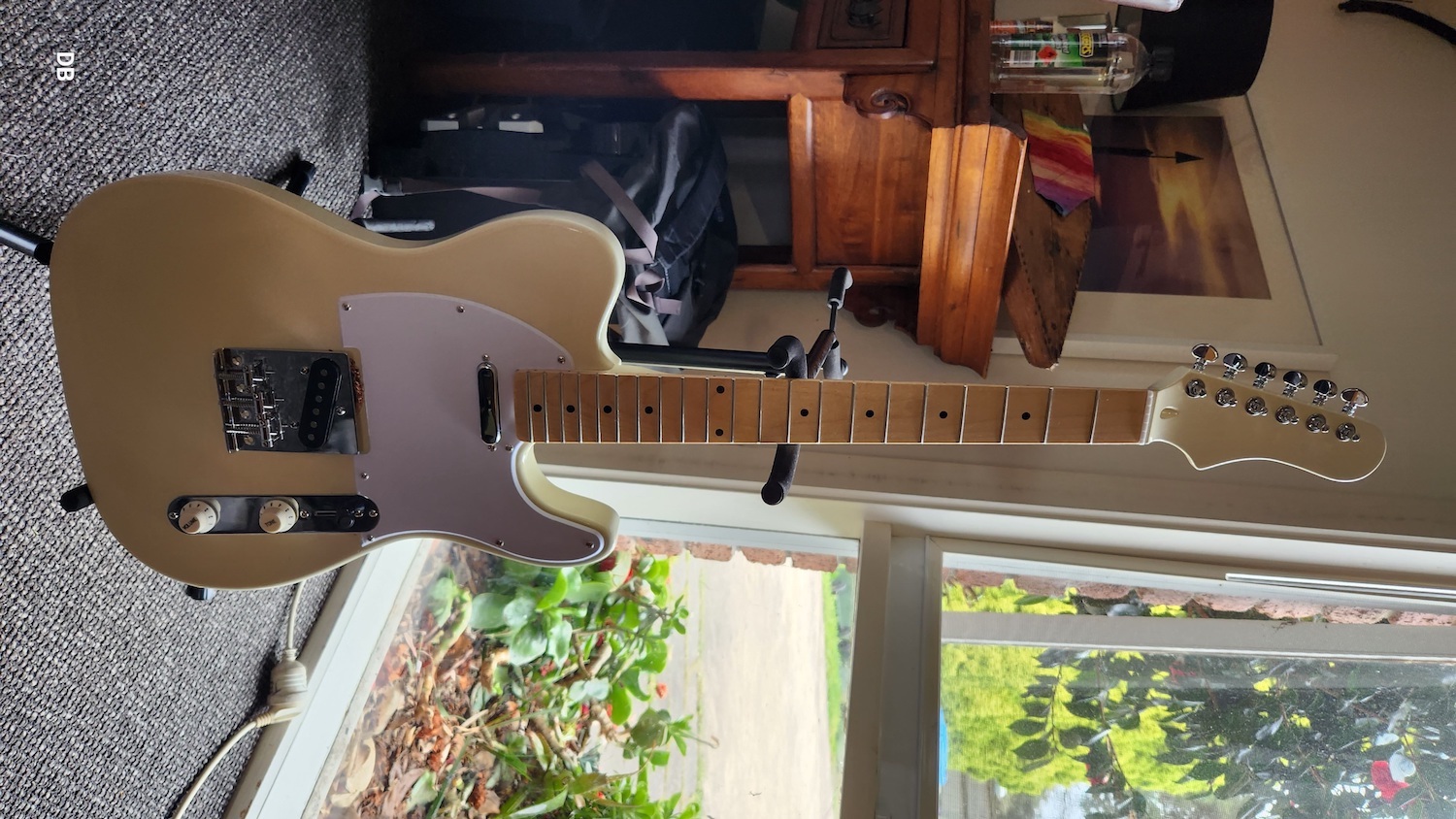

    Im almost done i could have been a bit more careful but its a players anyway hopefully.
    The truss rod access seems fine @SimonBarden however, i will file that for the next ones.
    @Fenderx yeah who cares the labels its how it plays and sounds that matters, if playing for 40 years has taught me anything its just that, to a degree anyway.
