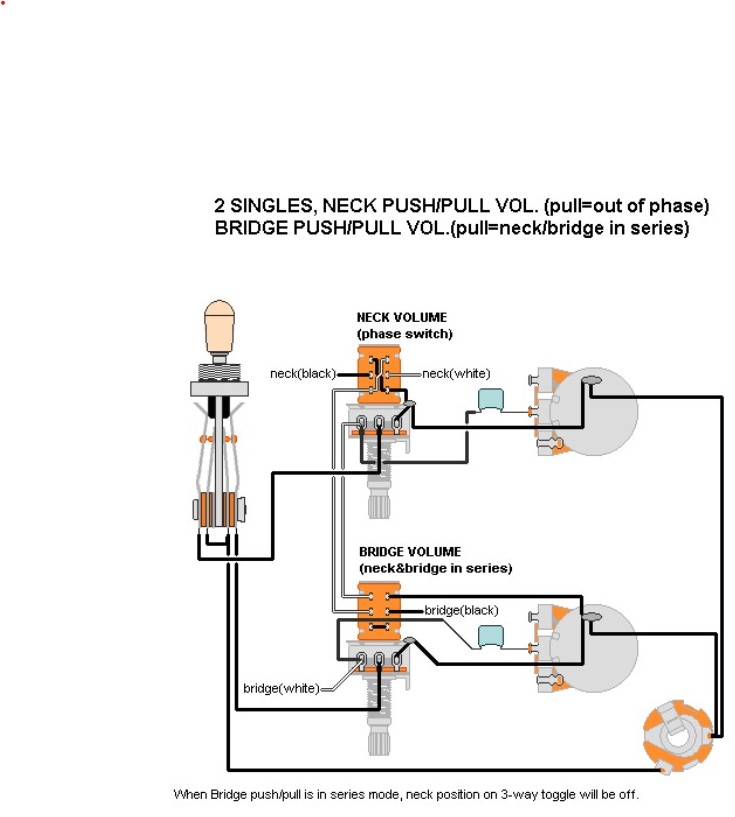

    I'm about to start an ES-1F build with my son (diary to launch shortly) and am having trouble finding a wiring diagram to accomplish something which I thought would be fairly straightforward. That is:
    1. Neck Volume push/pull to put neck pickup out of phase
    2. Bridge Volume push/pull to put both neck and bridge pickups in series (with each other)
    I'm not seeking to do any coil splitting, or changing parallel/series configuration within any humbucker.
    I have purchased ToneRider Alnico II Classic pickups with 4 conductor wiring.
    I found one wiring diagram, but it seems to be for two single coil pickups.
Name:	Pickup Diagram.jpg
    If anyone has a wiring diagram to accomplish this (with 50s wiring), I would be most grateful!
    Mathew
    The diagram is basically just the same, just with different pickup wire colours. In that diagram, white is the ‘hot’ signal from the pickup, black is the ground. For the Toneriders, red is ‘hot’, green is ground. The black and white wires stay connected to each other and to nothing else, so leave the black heat shrink on them.
    For each pickup, the exposed shield wire goes to the back of a pot. You don’t connect it to the green wire as you would for a basic 2 vol/2 tone arrangement.

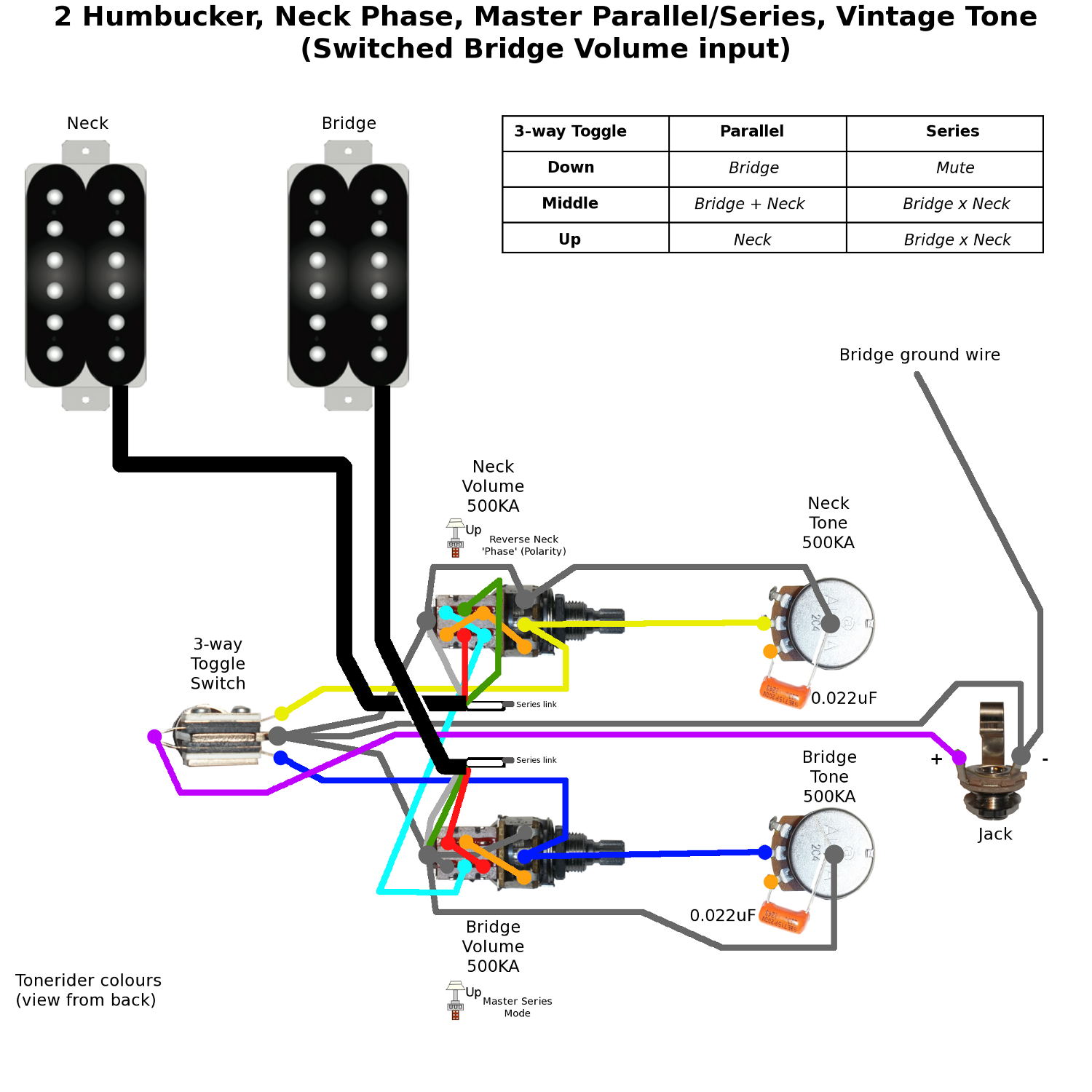

    As usual, Simon has covered all the important stuff about running humbuckers in series. The only thing I'd add is that Mathew also wants to use vintage tone wiring which complicates it further as you have your tone pots hanging off the output side of the volumes, so they are essentially connected directly to the 3-way... so volume and tone combinations impact all throughout the circuit(s).
    Anyway, I promised Mathew some diagrams, so here they are.

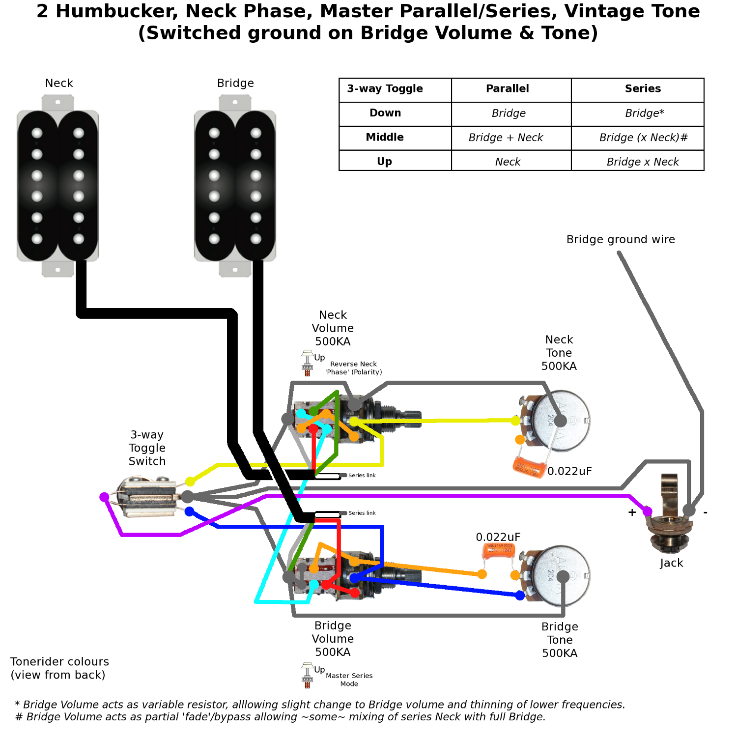

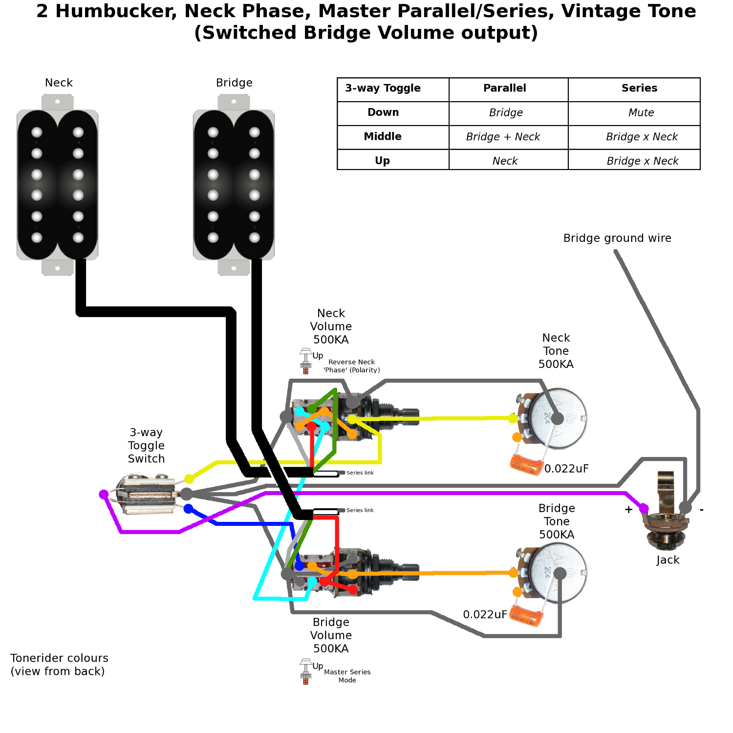

    All of them use vintage tone wiring and each does things slightly differently, so the switching options and effects of the pots varies. Note: all the diagrams were done in a bit of a rush so there may well be some glaring issues that I've missed or messed up, so use at your own risk.
    These first two are a standard style and use the spare side of the series push/pull to switch either the input or output from the Bridge volume. This gives a 'mute' position when the Bridge is selected in series mode, and all pots remain connected in some way.
    Option: 1

    The output from the Bridge volume is disconnected from the 3-way toggle when in series mode, but the Bridge volume and tone will still have an effect in the middle and neck positions as they are connected to the Bridge pickup.
    Option 2:
    On this one the Bridge volume input (the Bridge pickup) is disconnected from the pot in series mode, but as the vintage tone is on the output side it still has an effect when the Bridge pup is part of the circuit. And, the volume setting affects how much the tone pot works so there is still a lot of interaction.
    Option 3:
    The above variant swaps things around by having the phase on the Bridge rather than the Neck, and feeding the Neck into the Bridge pickup when in series mode. Also, as it doesn't do any switching on the volumes, you have sound in all positions in series mode. The downside being all pots in circuit and the tones will both be having effects.
