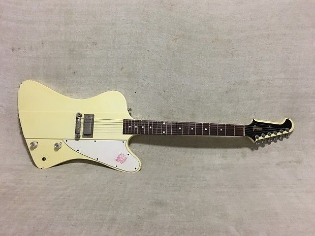

    I was inspired by Pete Stroud's Firebird 1 with a black dogear p90, and things have taken a turn. The kit is a bolt on, but I just couldn't pull the trigger on a Gibson. I thought of modding an Epiphone, but after all that I could assemble and finish my own, so here I am. Originally I was going to keep to a single pickup and dowell the holes, do a steath stacked P90, but my custom pickup guy is sending me a pair of mini-humbuckers for a good price...

    Hi and welcome to the forum.
    I take it the mini-humbuckers are true Firebird-style ones with two blade magnets and no adjustable pole-pieces (as in your Firebird 1 picture)?
    I have a Gibson Firebird that I fitted Creamery alnico V "Winterizer" pickups (now renamed Classic Firebird) in for a more authentic vintage Firebird tone. It came with Ceramic mini-humbuckers. The ceramics certainly sounded quite clear and powerful but still in the same general ball-park as a standard humbucker if that bit thinner, whist the Alnico V ones sound very different and quite unique.
    Good luck with your build!

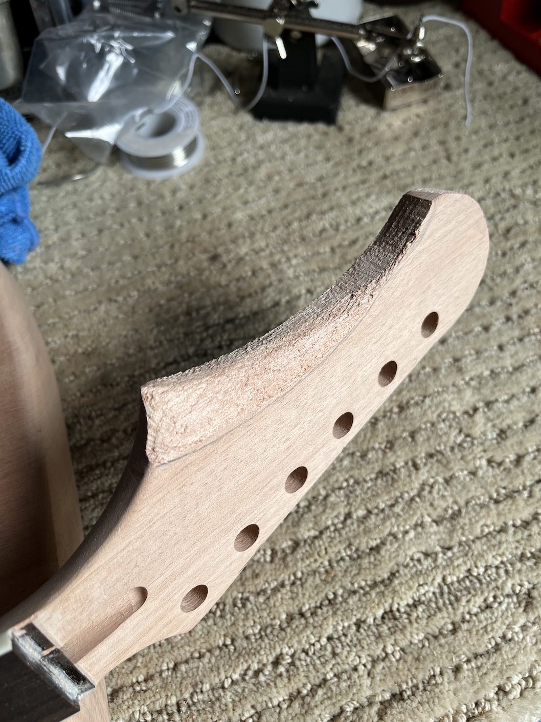

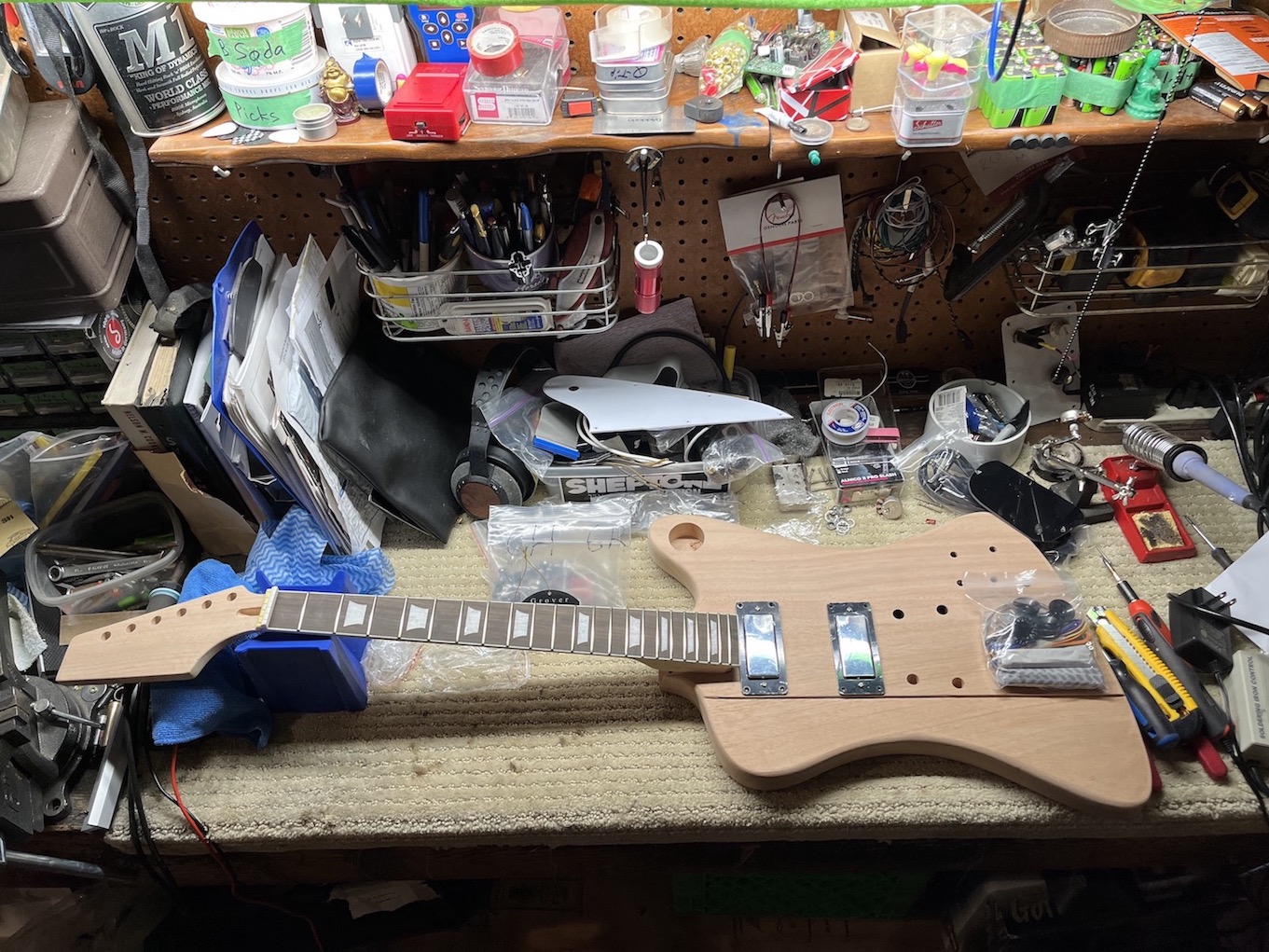

    Okay... the ball is rolling. Project codename: Fire-Emu. ;-)
    Did some rough shaping on the backside of the body, and roughed in the headstock. Not standard dimensions for the head, but on the plus side, the guitar should fit in one of my millions of existing cases lying around. :-)
    Might yet get to some more serious sandig for the remainder of the weekend. I've set myself a goal to play this guitar New Year's eve. We'll see how dilligent I get on finishing...

    Standard case? Bass case maybe! My Gibson Firebird case is as long as my bass cases and there's not a lot of room to spare at the ends once it's in.
