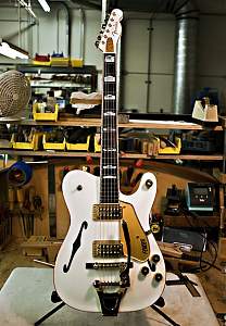

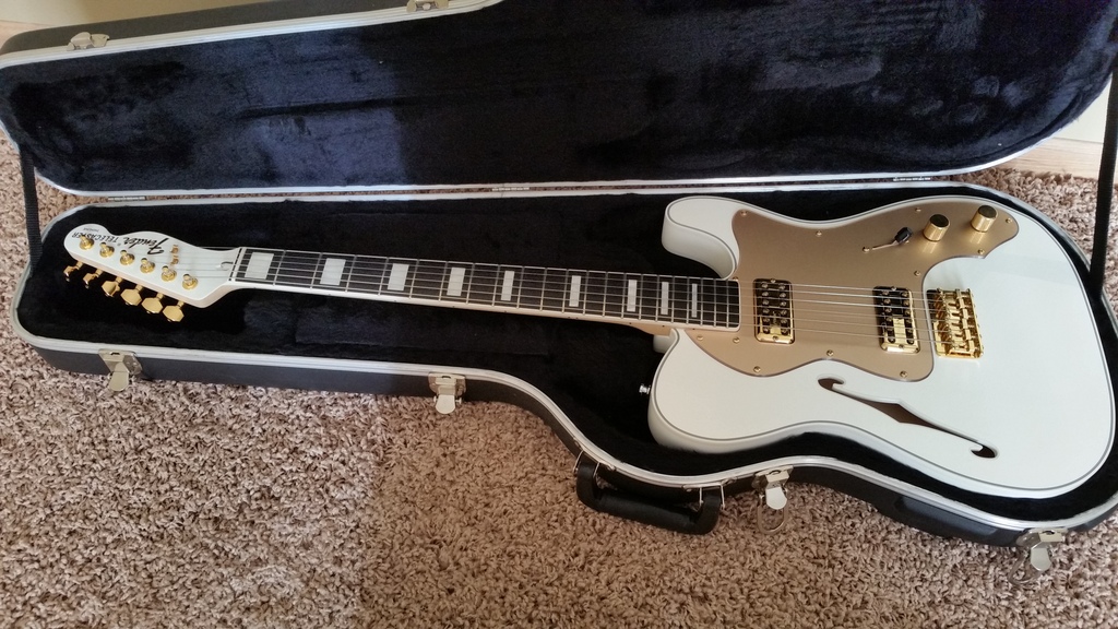

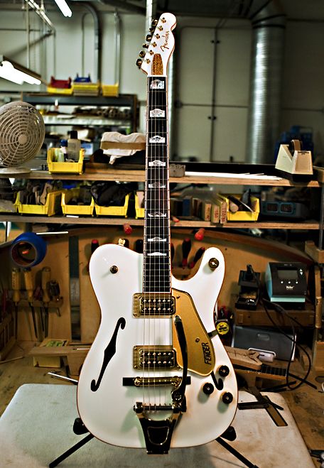

    Not having done a TL type before, went for the thinline after being inspired by the one-off White Chicken
    Will end up looking more like this if all goes well,

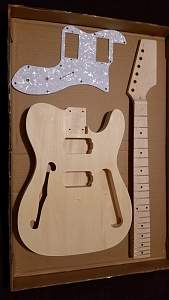

    Should mention now that actually started on this around four years ago and this is a catch-up to what has (slowly) happened. Will try to be brief and hopefully not miss out any important details.
    The story so far.....
    The kit

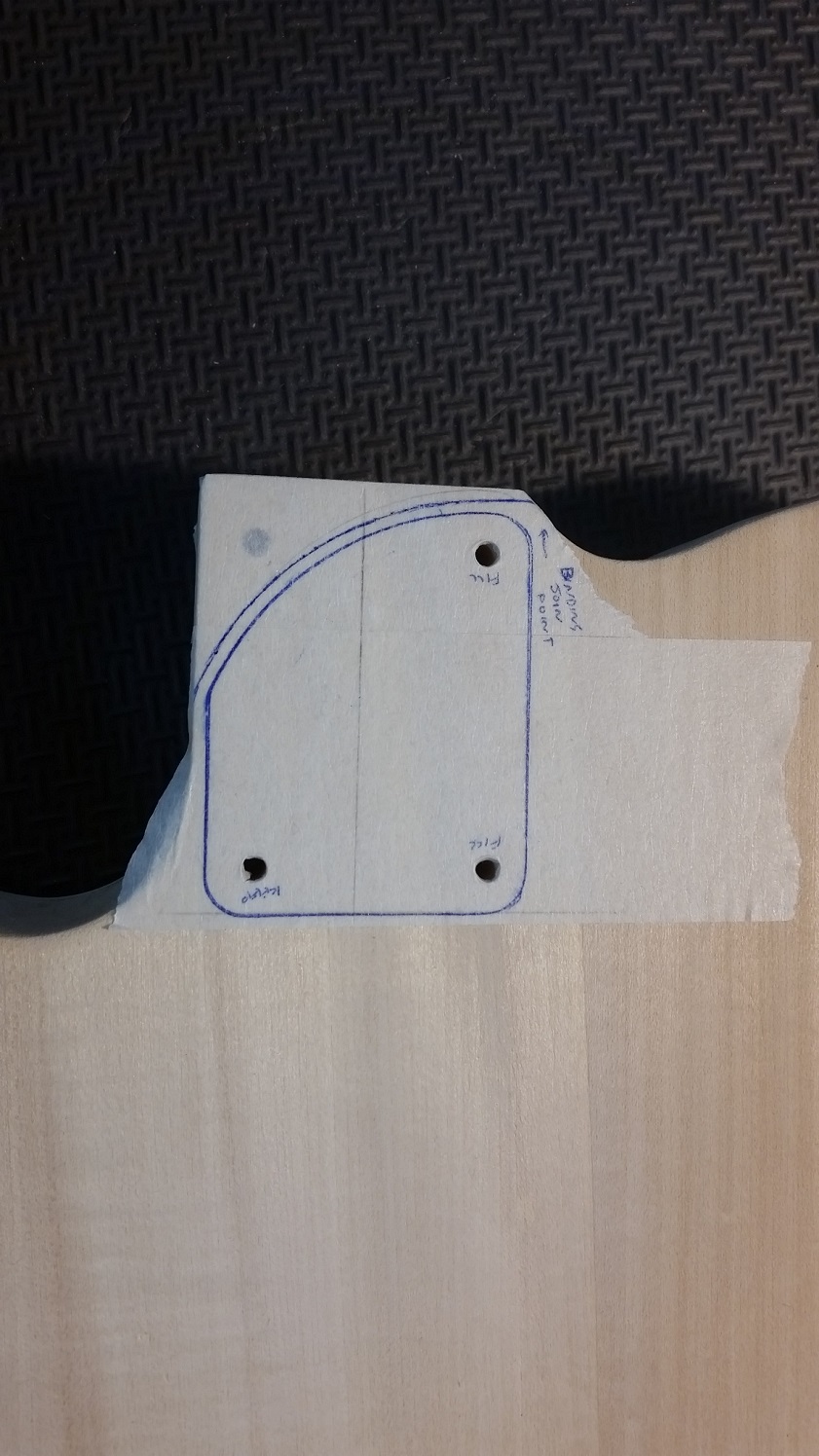

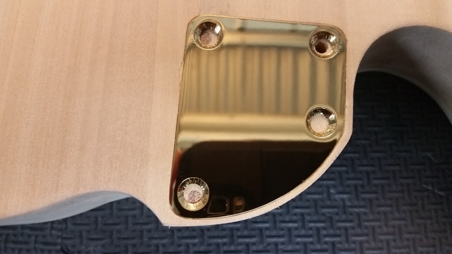

    First step was a rounded neck plate which will be recessed for reasons that should be clear later.
ID:	39773Click image for larger version.

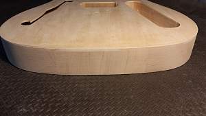

    Next step is reshape body to suit new neck plate
    Am trying to do binding on a body for the first time, so may as well make it twice as much of a challenge by making it double bound. The rear edge had been sanded with a slight radius which needed to be squared up as much as possible. Used a sanding drum in the drill press to do this and had the benefit of removing almost all of the original binding from the front face as well.

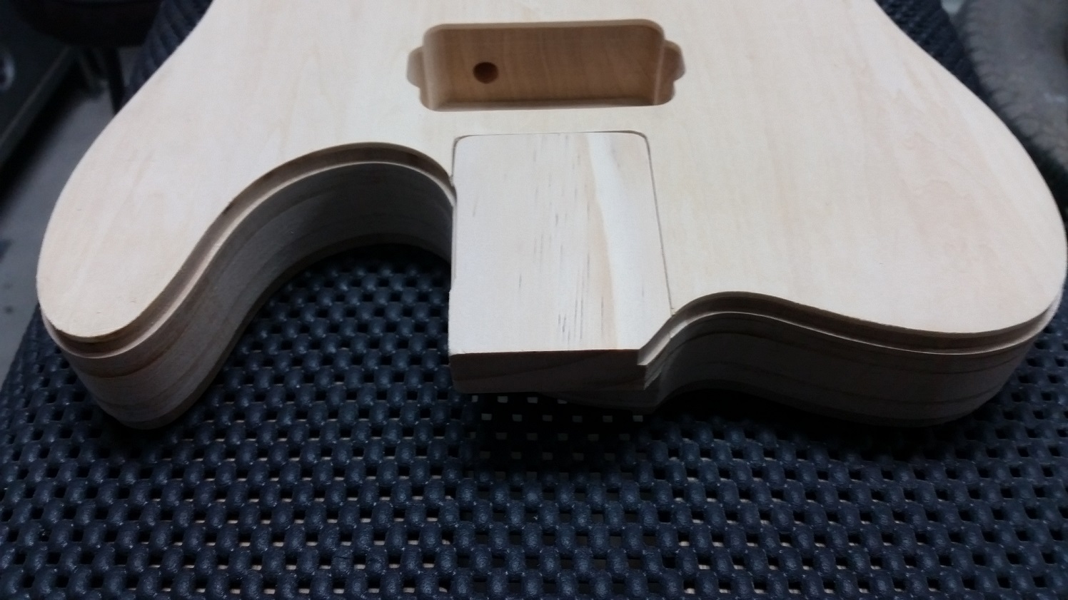

    Thanks to Weirdbits' build diary/tutorial for his Telebilly build, made a block to fit the neck pocket so the trim router could glide across the top evenly

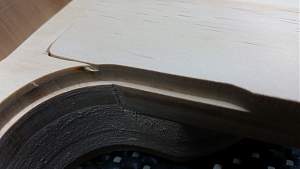

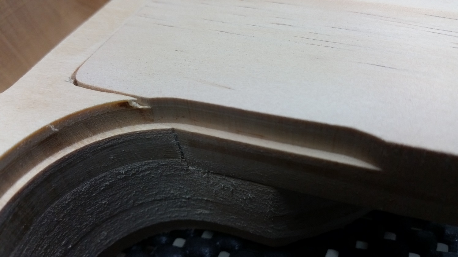

    Despite being careful, did have a little tear out

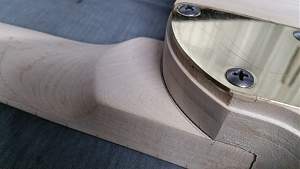

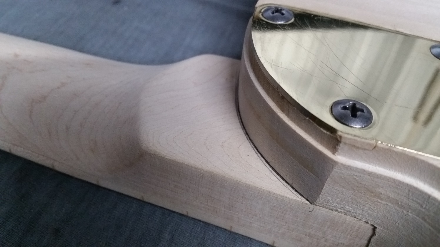

    With the rear of the neck pocket reshaped, the neck itself will get a gentle finessing to make a better transition

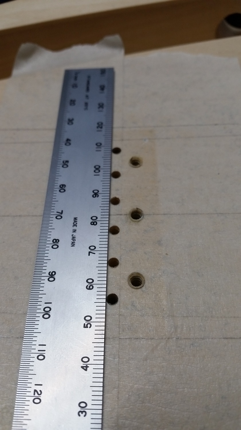

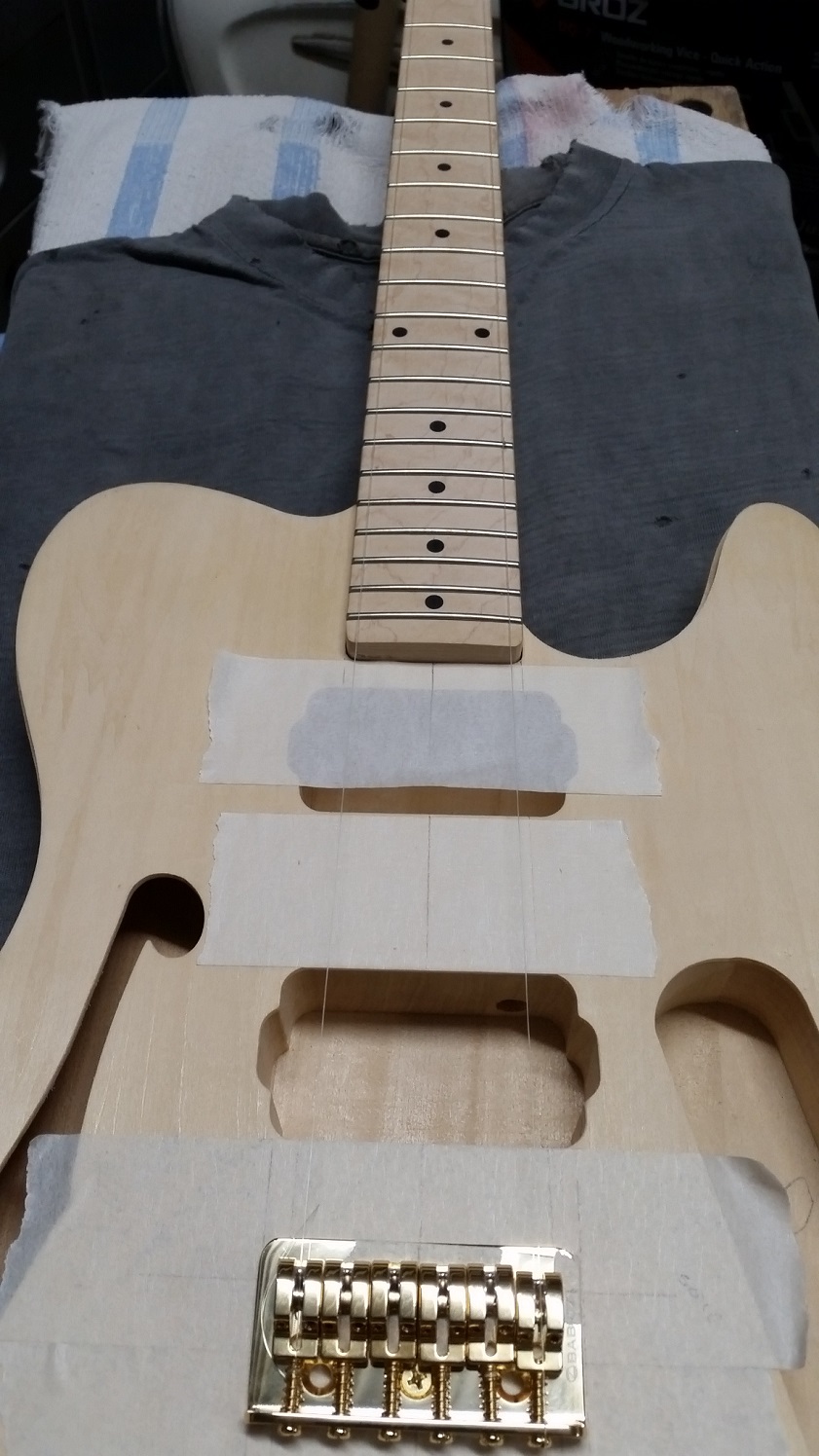

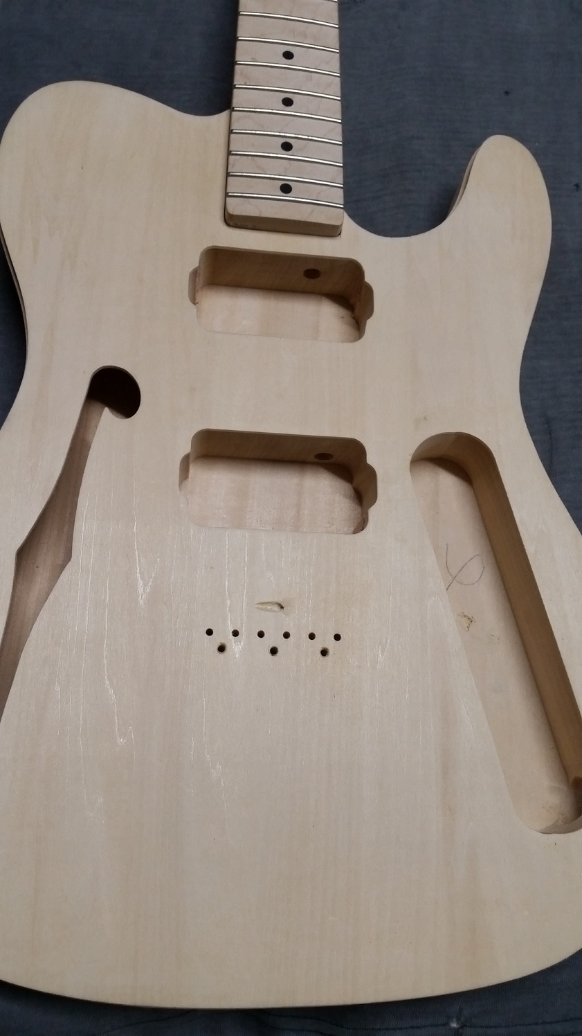

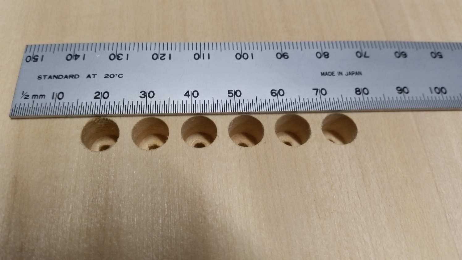

    Time to position and drill the holes for the string thru bridge
    All straight on the front
ID:	39783Click image for larger version.

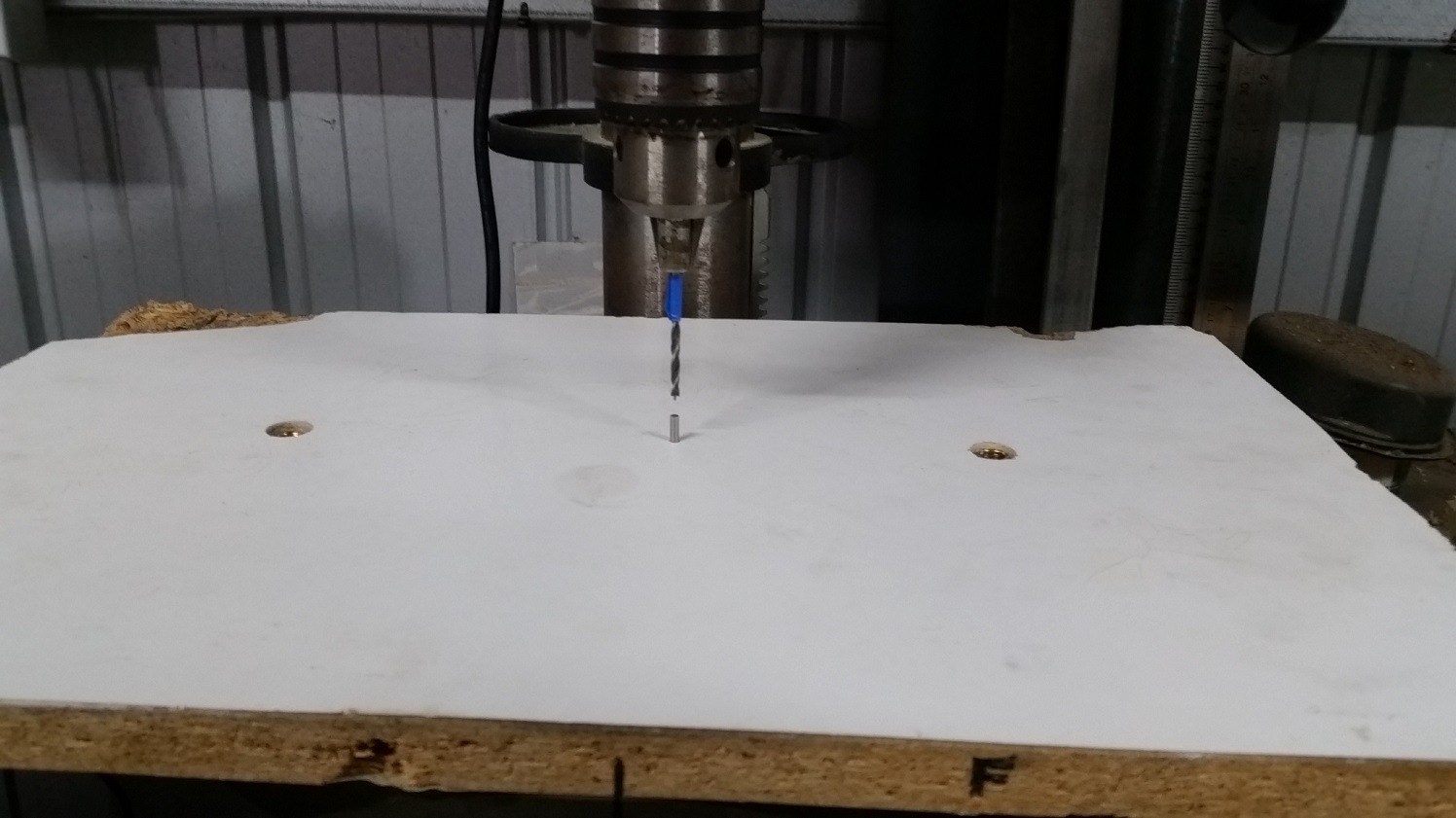

    Have the luxury of a drill press which has a throat just deep enough to be able to do the hole for the rear ferrules. Wasn't able to clamp the bit of board to the drill press table without the clamps getting in the way so ended up bolting it down instead. Have used a 3mm drill bit, shank end upward, as the guide pin. Did need a drop of CA glue on the underside to help hold it in place. The board may look a bit manky bit is quite smooth, doesn't do any damage to the body.

    E string holes through

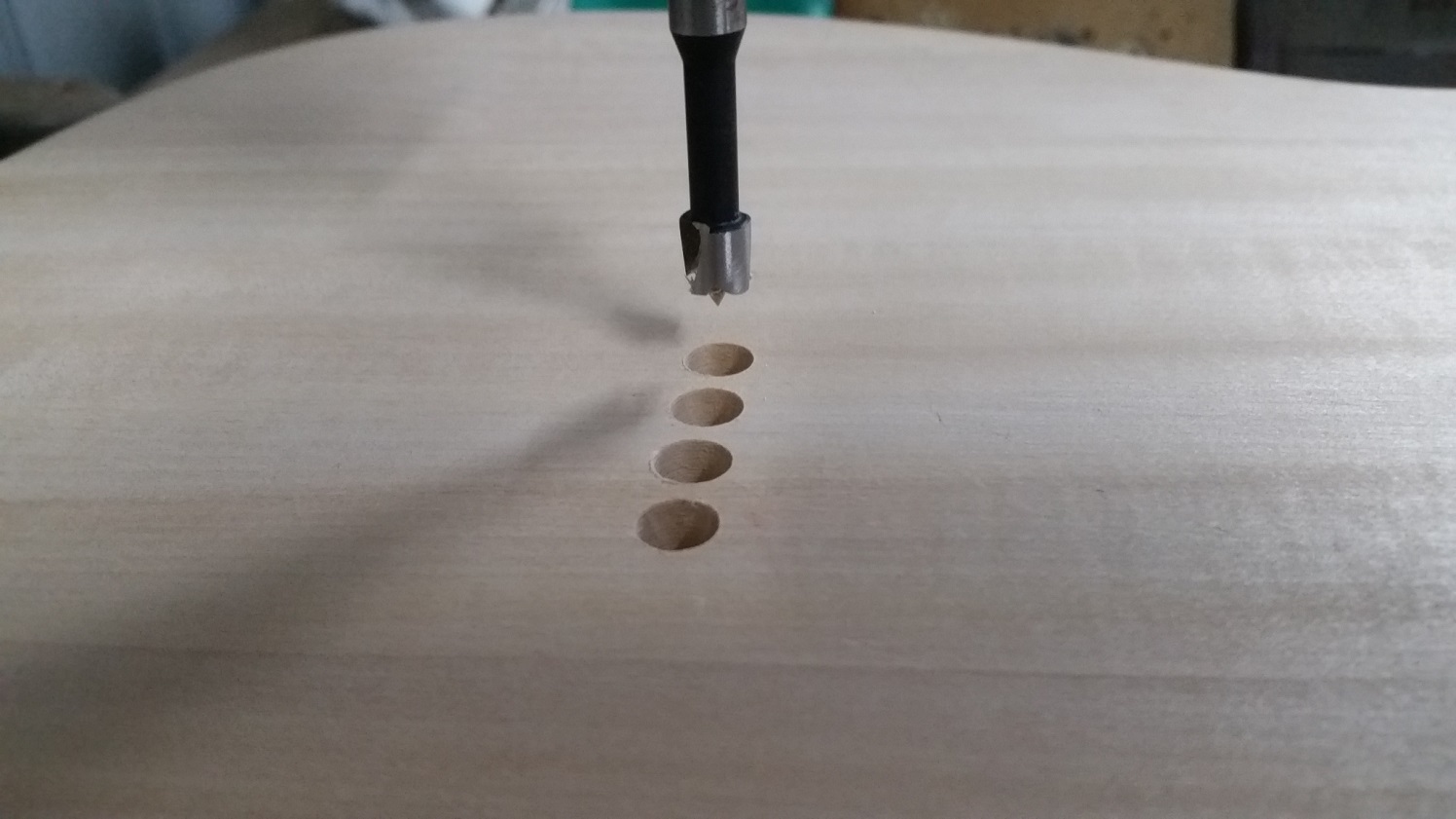

    Set up the forstener bit and no going back now

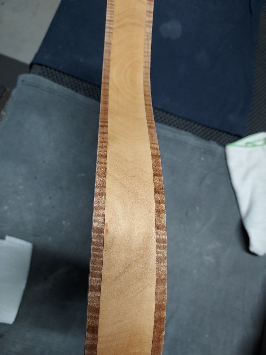

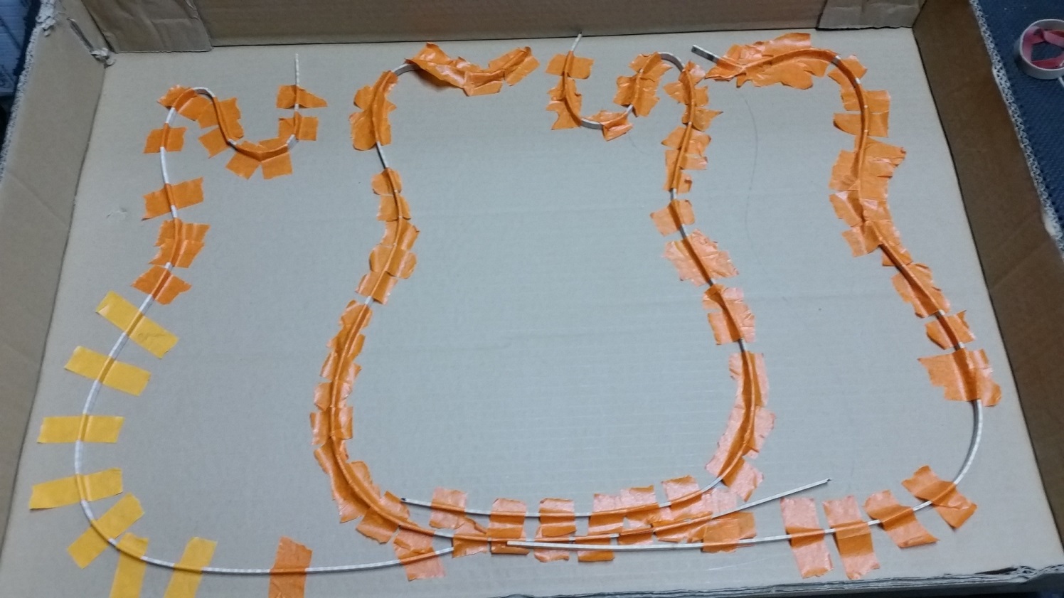

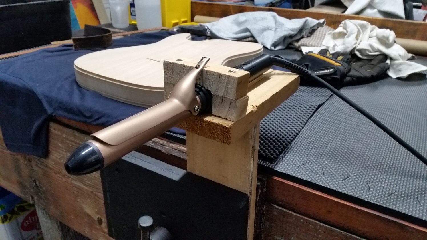

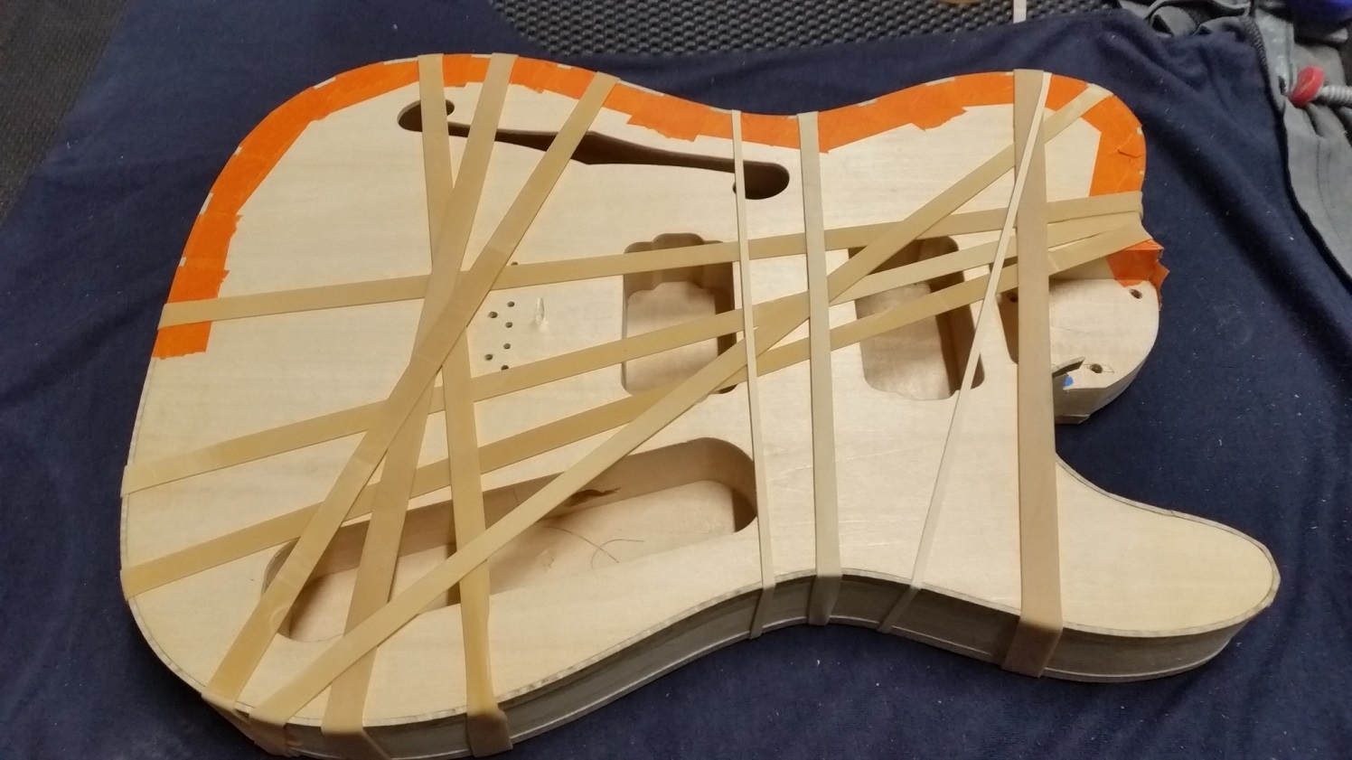

    Next challenge is to shape (well pre-shape) the curly maple binding. After too many YT vids, kind of mashed up most of that into something that sort of worked. Soaked the binding in ammonia, wrapped it in foil and used a hair curler as a bending iron.

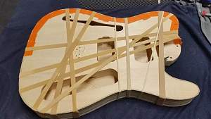

    First piece on the body with excessive use of tape, you can see the foil around the binding by the neck pocket
    still going...

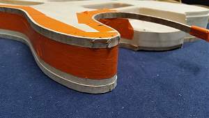

    Next piece shaped, a little easier to see what's going on

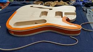

    Binding pieces pre-shaped

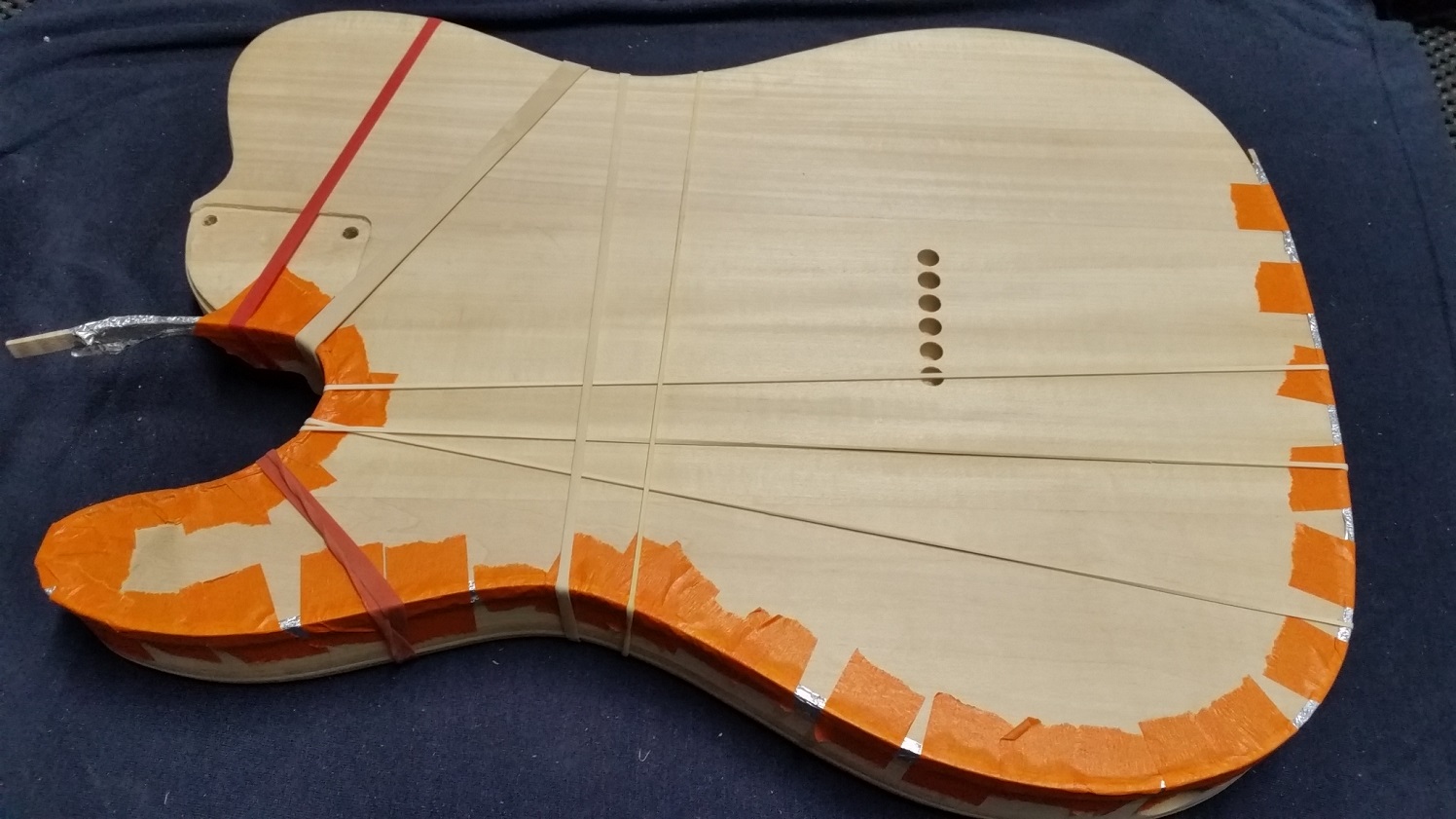

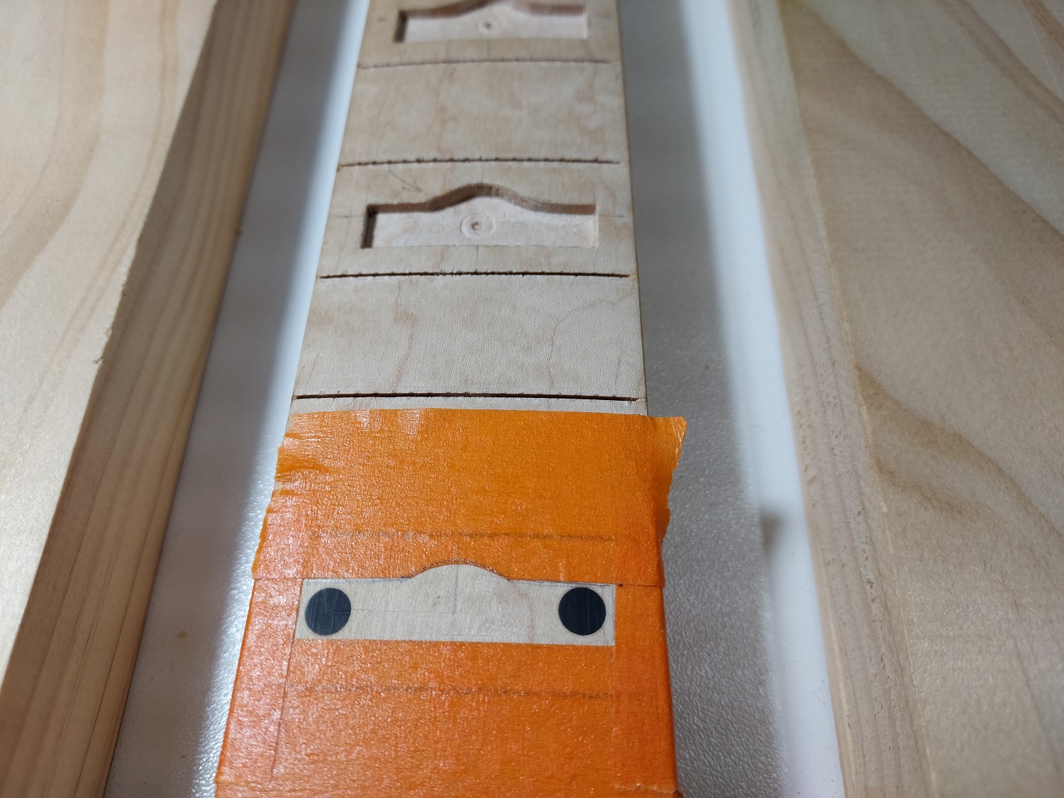

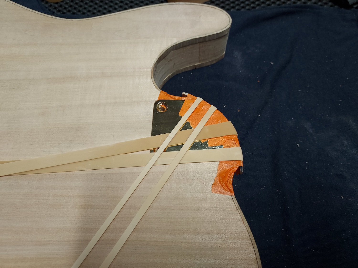

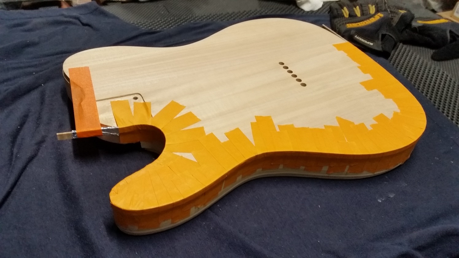

    Being aware of glue issues and am planning on using stains for the colouring, went the extra step of taping up both edges of the binding channel. The soaking of the maple pieces did cause some warping which meant some sanding, well filing, was needed on the mating faces. If you don't have a Shinto saw rasp, get one, they are awesome. Did break this piece during fitting up went back together well.
    And here goes
ID:	39794Click image for larger version.
    Looks a little like an EVH tribute a this point

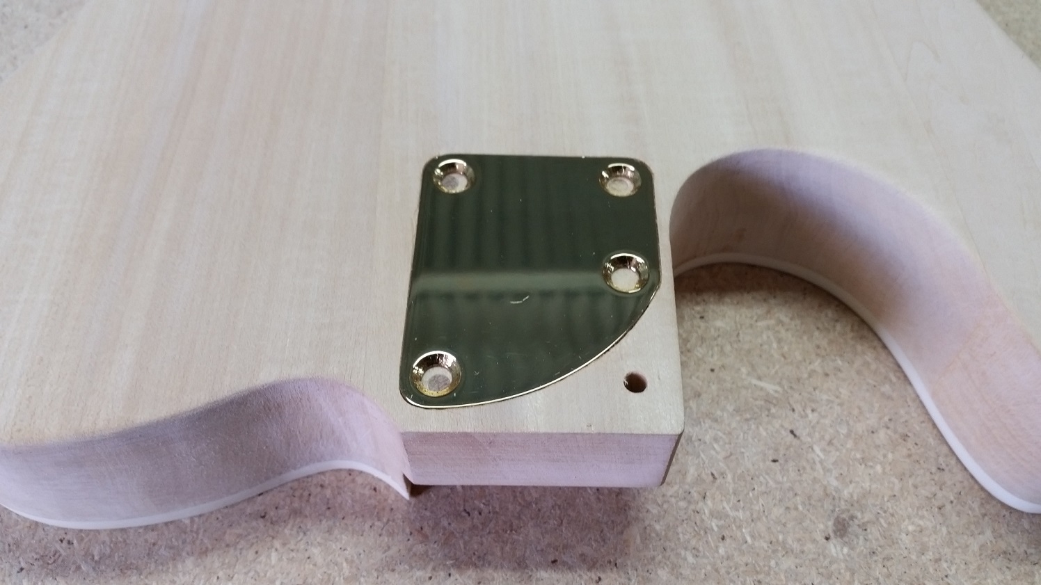

    Next was the fill piece to go across the neck plate

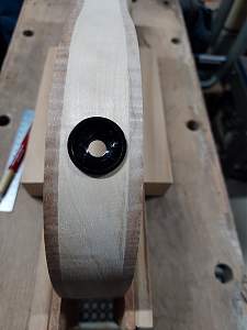

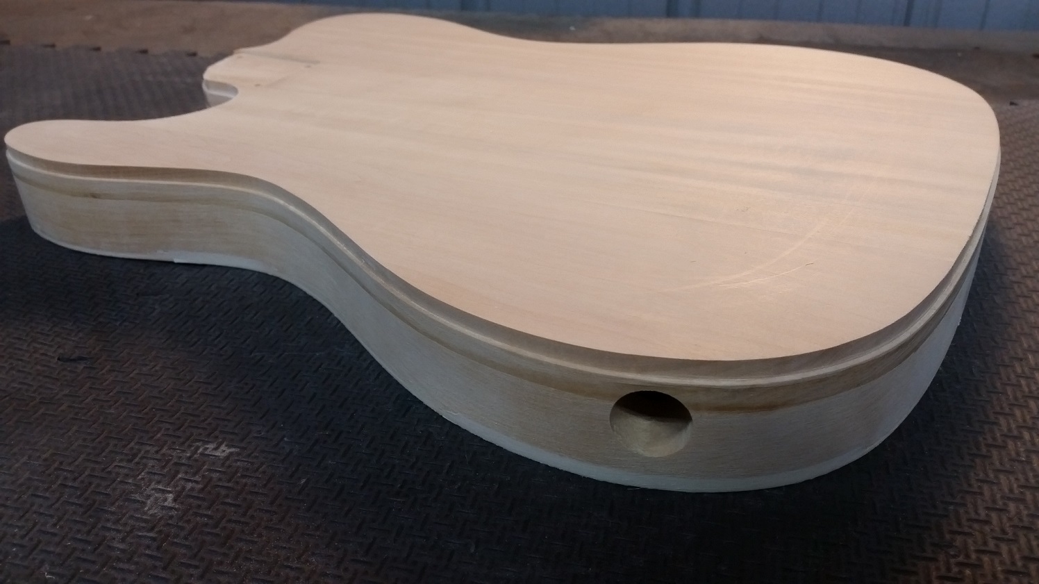

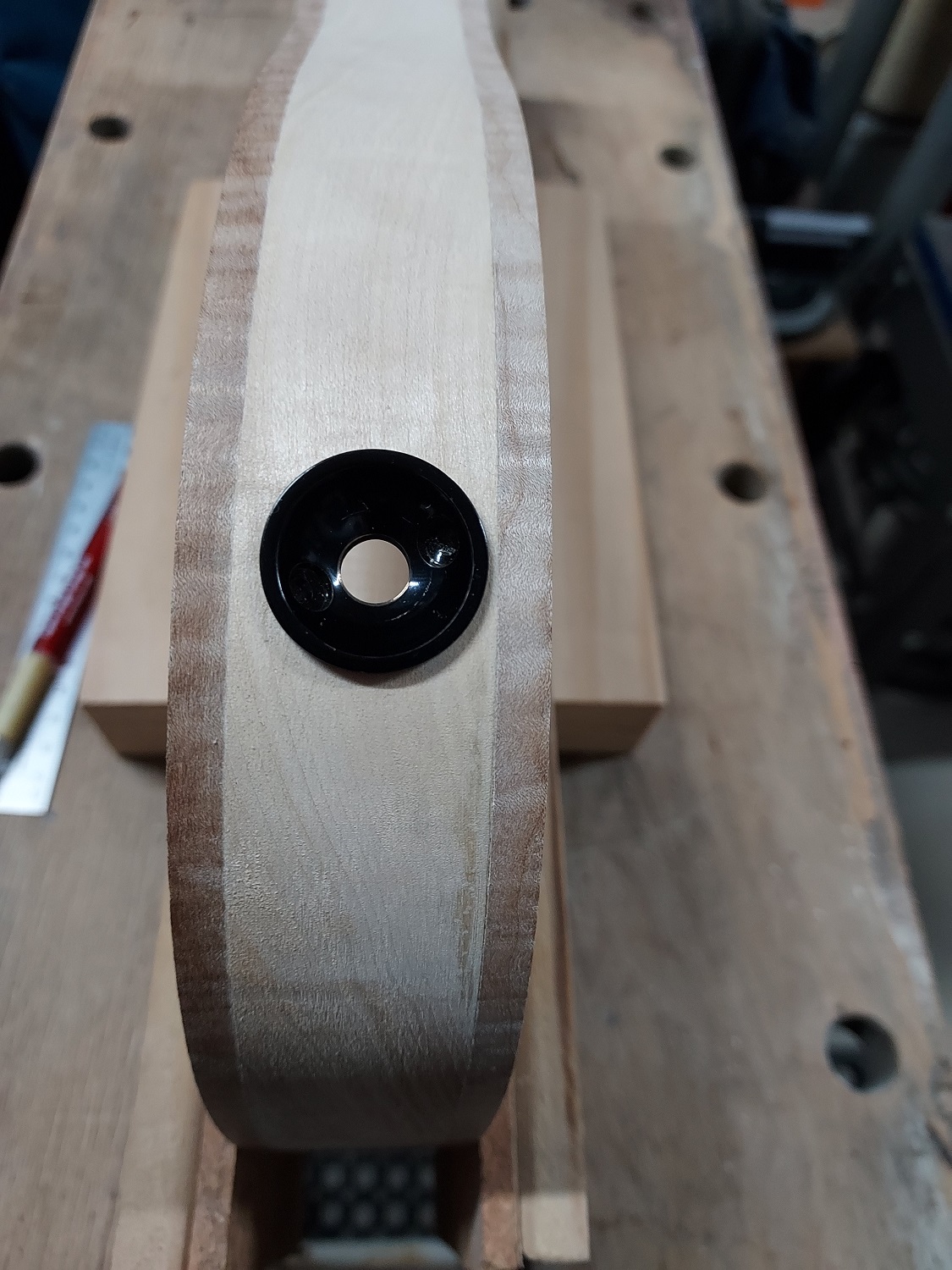

    Now its really obvious the hole for the output jack is not centered, just as well had planned to recess it so some sideways nudging is possible.

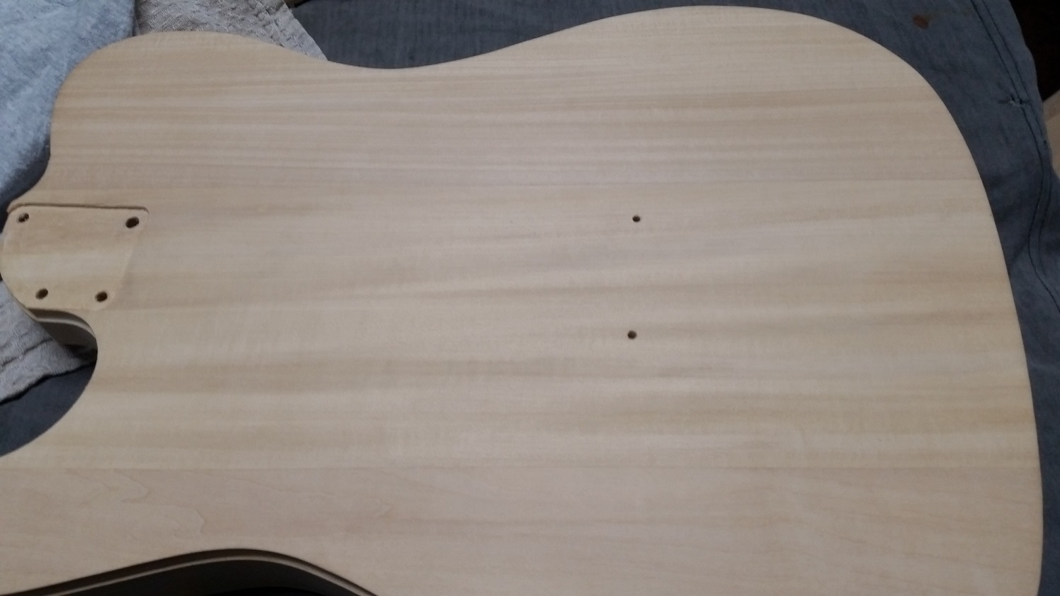

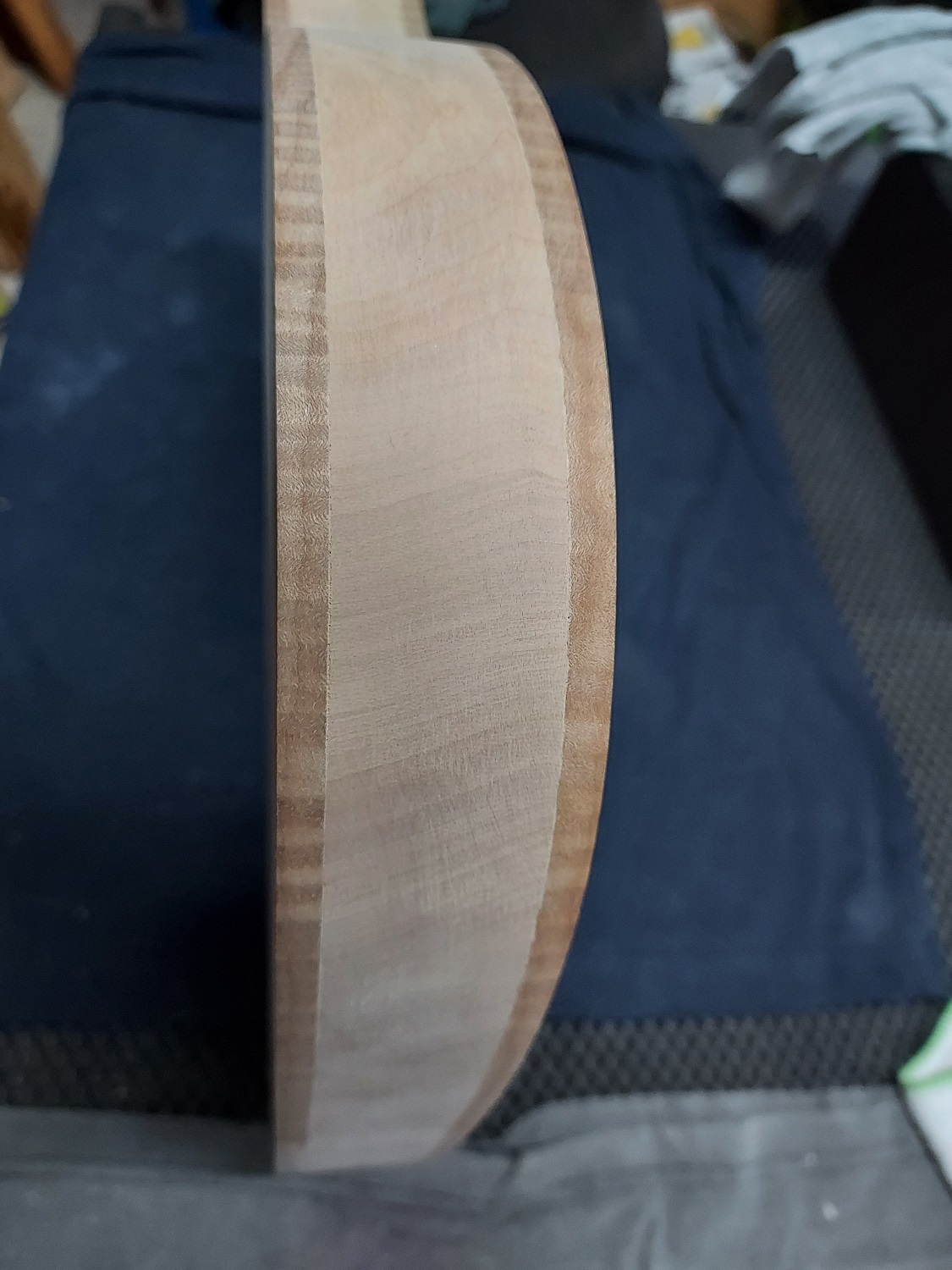

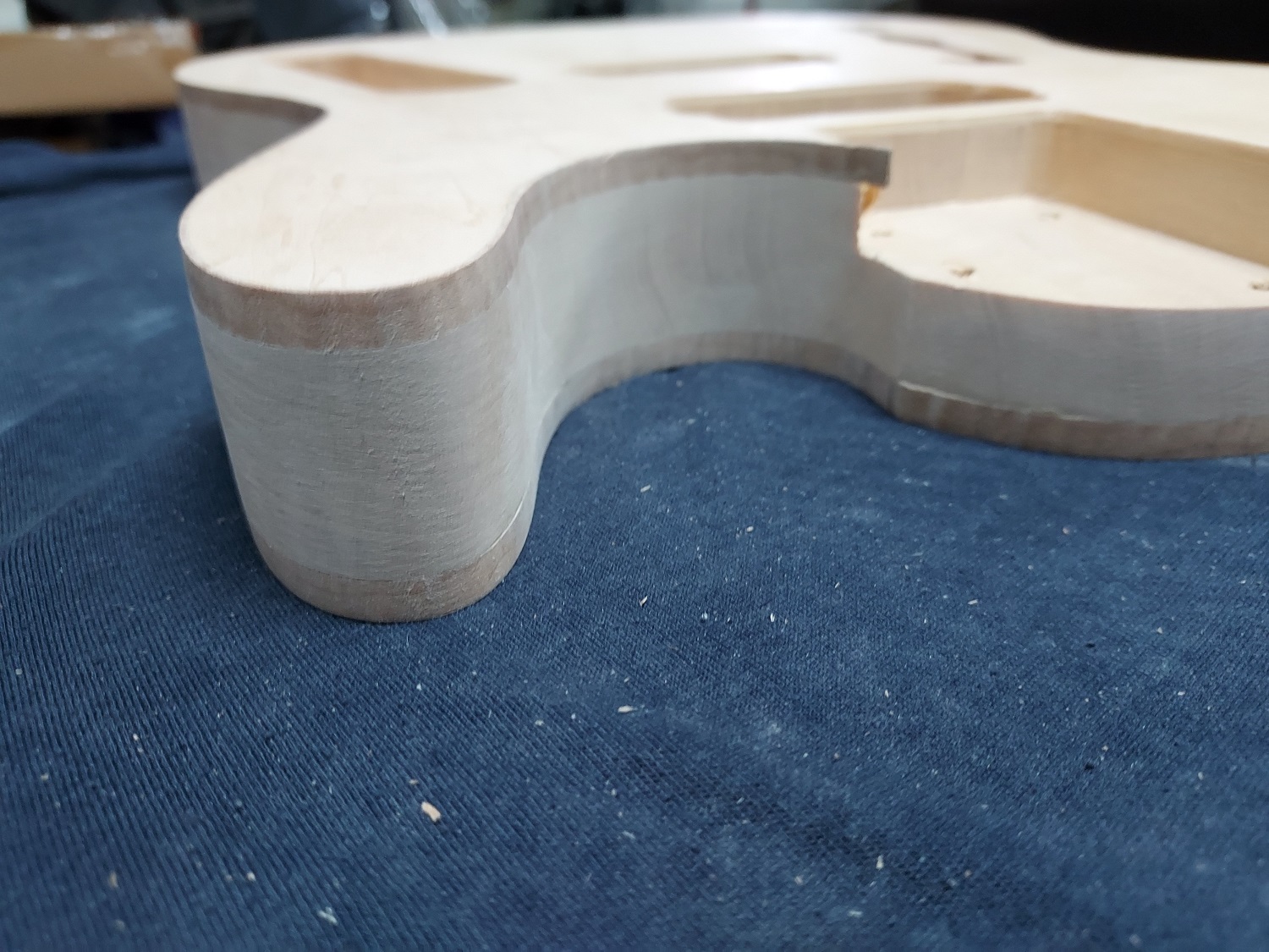

    After cleaning up the sides with a spindle sander, the binding doesn't look as bad as it did.
    Started sanding the sides with P180 and gave it a wipe over with gum turps to see where we stand
ID:	39799Click image for larger version.
    Feeling less bad about my efforts now
