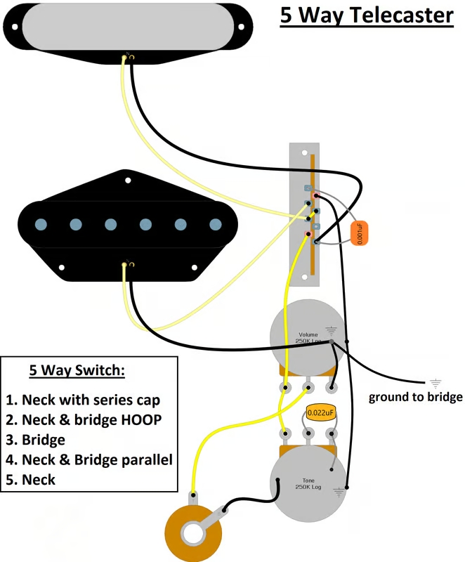

    Hey all,
    It's time for my new project: a midnight sparkling tele.
    For the PU wiring I was thinking of this mod:

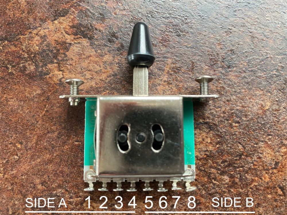

    Just a few questions:
    1. I'm gonna use noiseless pickups, so 5 wire PU's, do I just solder the start wires together and the end wire too?
    2. I'm using a 5-way import switch, how would the connection to the switch be then?
Name:	Import switch.jpg
    3. For a treble bleed, I just add a 100k cap to the .022 cap?
    Thank you so much already for your input
    Cheers

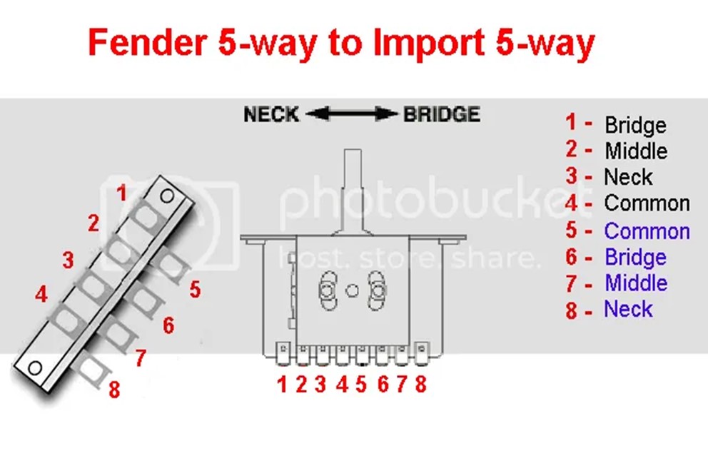

    1) What brand of pickups are you using?
    2) see below
Name:	5-way Fender to Import.jpg
    3) Treble bleeds go in series on the volume pot (soldered between "in" and "out" lugs, IYKWIM)
    Cap and resistor values are all personal preference. It can be done with a cap only, or cap/resistor series/parallel configuration. Too many to list here (actually I'm just being lazy). Lots of good info online. Just research a bit.
