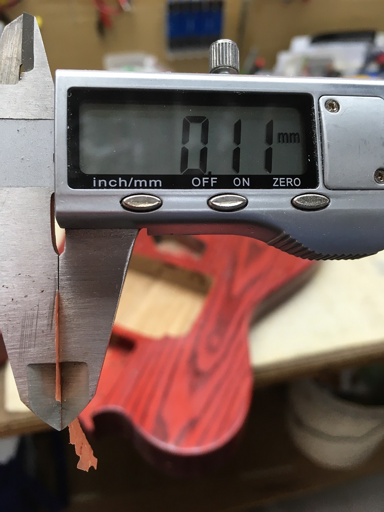

    Whilst currently undergoing a refinish on my 2018 TLA-1, which I had originally applied a wipe-on poly finish to (longer story in another post) I was able to remove a "piece" poly by scraping it off with a razor blade.
    Just out of curiosity, I measured it's thickness with my digital callipers. Now, these are not a highly calibrated instrument, but they are pretty close for 40 bucks (tested with feeler gauges).
    Anyway, my point being that this flake of poly was the result of 28+ coats of homebrew wipe on poly (mixed 50/50 - poly/turps) then wet sanded and polished. as you can see the coating left on the timber is only 0.11 mm! (same as a single sheet of 80 GSM copy paper) That is sweet bugger-all!
    I know it is difficult, if not impossible, to quantify what is "a coat" especially with a wipe-on finish, but I think this still illustrates what slim margins we're dealing with in our finishing pursuits.
    So when we read about "sand-throughs" (we've all been there!) it's not hard to understand just how easily they can happen.
    FWIW, I took samples from various areas of the body and they consistently measured between .009-.011mm.
    Last edited by McCreed; 22-04-2022 at 03:33 PM. Reason: fixed decimal point from .011 to 0.11

    I think your decimal point should be moved one step to the right as my paper measures roughly 0.1mm and most digital calipers only read to the second decimal point.

    D'oh!!! You're right. And I forgot to post this in my OP
Name:	Poly Thickness 1k x 750.jpg
    Have edited OP...

    Something I find hard to understand is how 20+ wet coats only equate to 0.11mm finish, yet than again 1mm would be a lot!
    Sent from my 2201117SG using Tapatalk
    FWIW, I did make it a point to say the finish that was removed and measured was after wet sanding and polishing, so that would likely have decreased the original thickness.
