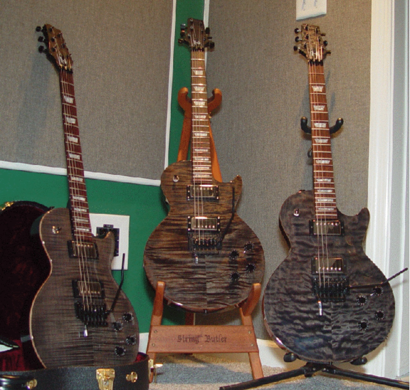

    Good day Simon,
    I have read through your answers in the above thread and have a further question.
    I'm wanting to get the same effect (black stain on flame maple) as the J&H guitar made by Bob Hartman a few years ago. For some or other reason I can't upload a photo.
    What would you recommend as a stain?
    Thanks for the assistance.

    I haven’t done a black stain finish, like that, so can’t really say what’s best. I’ve used a dilute water-based black stain to ‘pop‘ the grain on my ES-1 kit, but getting a highlighted all-black finish isn’t that easy.
    I bought an unfinished Tele body off eBay sone time ago that had a black-stained maple top. It was very black indeed and you could only just tell it had a flame to it. Unfortunately, because it had black binding that I wasn’t aware of, and the top was so black, I thought it had a thick maple cap, so robustly sanded back to expose some unstained maple which I was going to tint another colour. But before I got to that state, it turned out that it was veneer and I’d sanded through to the body wood.
    So if you do try and go for black, just make sure you dilute the stain well and don’t go too dark all at once. Build it up slowly and wait until each application has dried to check the colour. Don’t forget it will look more intense with a clear coat on. I expect the Bob Hartman guitars had thick maple caps which made it easier to apply a strong black first, then sand back and apply a more dilute stain. Though I’ve seen good strong flame and quilt maple finishes on the kit guitars as well so it can be done (just not in black).
    But you are always going to be reliant on the quality of the flame or quilt on the kits veneer. Some kits have had gorgeous deep and consistent patterning in the veneers, some could hardly be called patterned at all and some have only had strong patterning in patches. If the pattern isn’t there in the first place, you won’t get the results you want.
    I’ve only used either water-based or spirit-based stains from the likes of Rothko and Frost. I prefer spirit stains as they are a bit easier to work with to get a uniform finish but I find they do get into cracks in binding far more than water-based stain, so I now only use spirit stains on all-wood bodies.
    What I haven’t used are all the other various Indian inks and leather dyes that others gave used, but they all seem to give good results.
    But whatever you use, always check for and remove glue marks first. With veneer tops, they will be there, especially down the join line and where it meets the binding. Fingerprints could be anywhere.
    And I’d mask any white or cream binding before staining. You can scrape surface stain off binding, but once it gets right in the cracks it’s almost impossible to remove. The binding (at least the stuff the PB kit guitars use) gets hairline stress cracks in when it’s bent. The tighter the radius, the greater the stress on the plastic and the more cracks there are. I ended up painting the binding on my ES-1.
