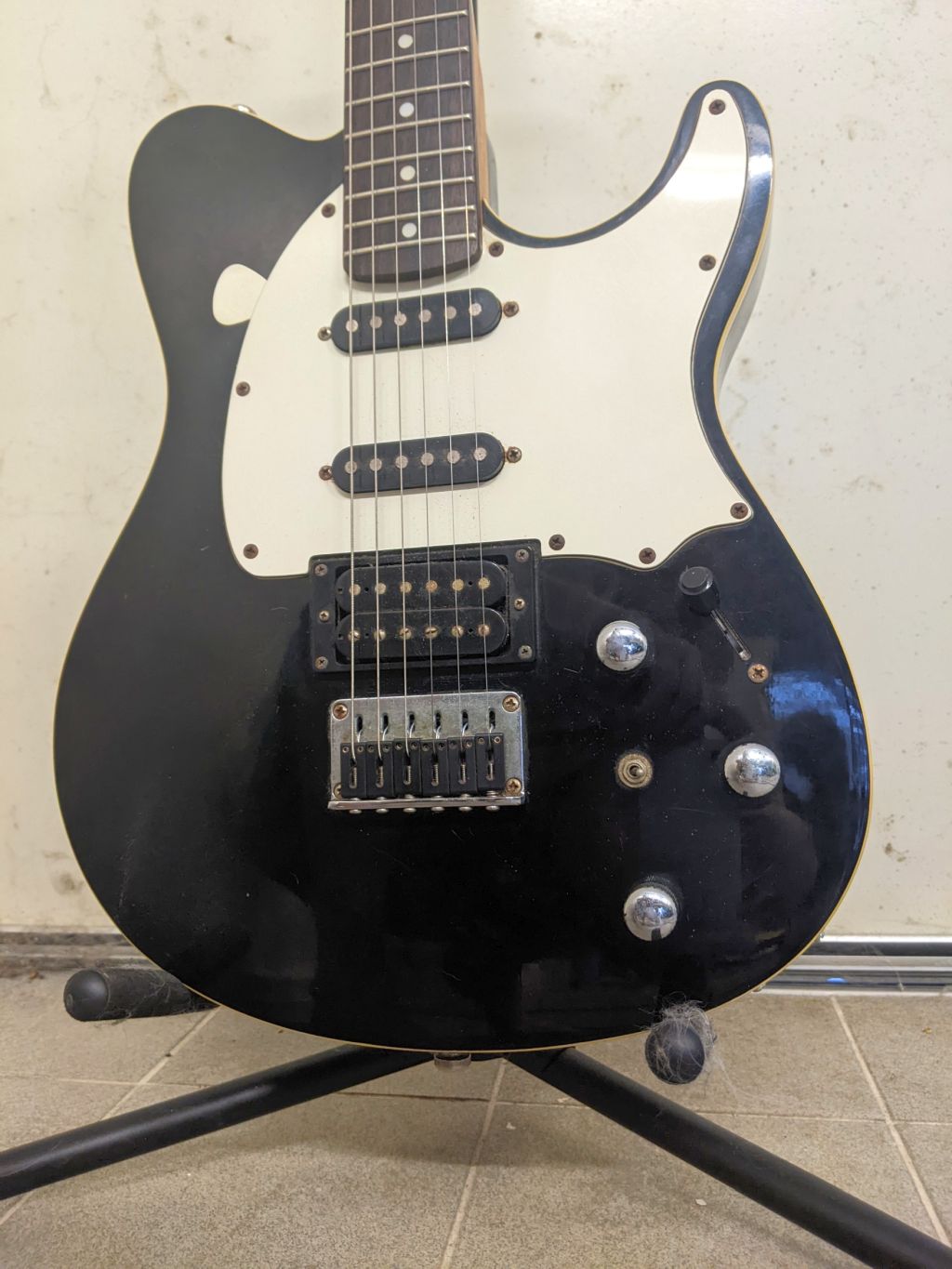

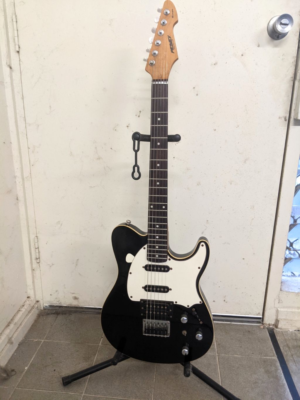

    Rightio, I'm guessing you all want to know what kind of a guitar it is?, well...it's a Peavey Generation EXP Telecaster, it has a set of conventional passive magnetic pickups, plus a set of 6 piezo-electric pickups.
    The conventional magnetic pickup configuration is a single-coil neck pickup, a single-coil middle pickup, and a full-sized humbucking bridge pickup.
    Each of the 6 piezo-electric pickups are mounted in the string-saddles, there's a circuit board in the control cavity route that contains all the preamp circuitry for the piezo-electric pickups, the circuit board is powered via a standard 9V battery.
    Okay, so what about the controls then?
    There is a master-volume, master-tone, and a master-volume for the Piezo-electric pickups which enables you to blend-in some of the Piezo-electric pickup sound with the passive magnetic pickup sound, there's a 5-way pickup switch for the passive magnetic pickups, and a small 3-way toggle switch that gives you three options, Piezo only, Piezo+Passive magnetics, and Passive magnetics only.

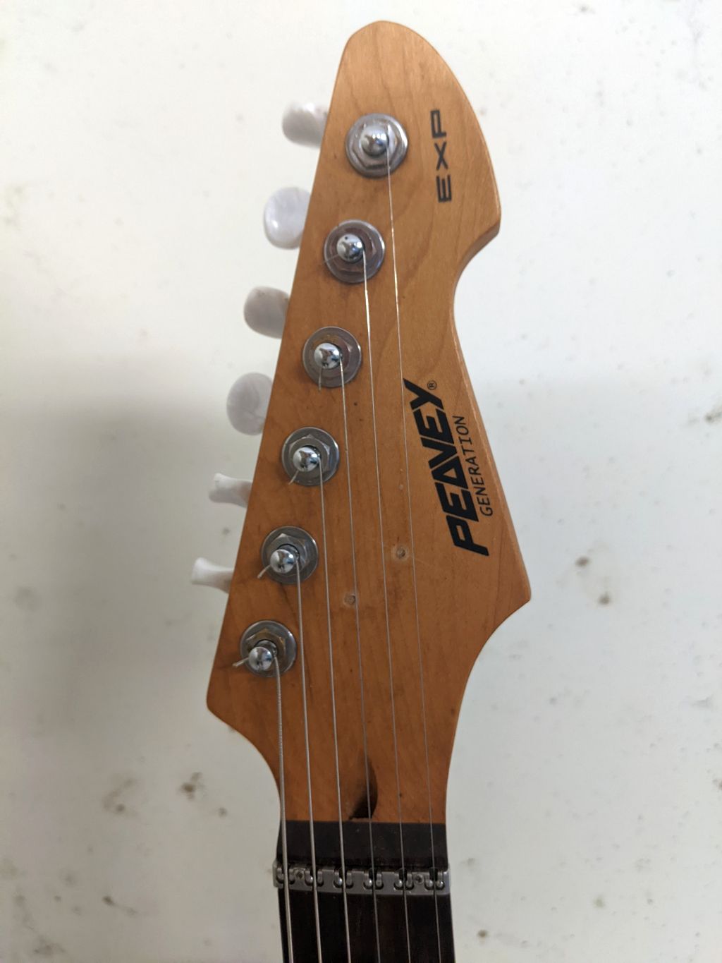

    Here we go, some pics of the guitar:
Name:	Peavey Tele_1_resized.jpg
Name:	Peavey Tele_2_resized.jpg
Name:	Peavey Tele_3_resized.jpg

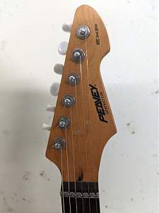

    When I got the guitar it was missing the plastic nut that normally would have been glued in the nut trench, after some debating in my head, I opted to install a Fender LSR nut, which got the guitar in a playable condition, one other thing I noticed was that the bridge plate appeared to be in the wrong position to enable each string to be properly intonated, each of the six string saddles ended-up hard up against the back of the bridge plate after I went through the process of adjusting the intonation, most of the strings are almost spot-on with the G-string being the worst offender, I've got the G-String set as far back as it can go and the intonation appears to be still sharp by about 5 cents, I'm guessing that the bridge plate needs to be moved back from the bridge pickup by about 5mm or so in order for each string to be correctly intonated, they are all as close as I can get them to being properly intonated, there's a problem with setting all the saddles hard-up against the back of the bridge in that it makes it hard to push the strings through their holes when installing new strings, my guess is that someone messed-up their maths when designing the guitar.
    Anyway, I tried playing the guitar through my Boss Katana amp and to my ears it is a very bright sounding guitar, the body is made from a few pieces of solid-wood, I'll have to do a quick google to find out exactly what kind of wood was used to make the body, but it is definitely solid wood and not plywood, my guess is that the neck is Maple with a rosewood fingerboard, but again I'll have to do a quick google to be sure, the piezo pickups do have a kind-of Acoustic vibe to them, I was surprised at how high the output level was from them, if you blend the Piezos with the Passive pickups you get some pretty interesting sounds.
    For the time-being the tuners I have installed on the guitar will do but I'm seriously thinking of replacing them with a set of Steinberger Gearless Tuners when Stewmac have them in stock, hopefully sometime this year.

    Well, it looks like I'm going to have to forget about buying a set of Steinberger Gearless Tuners for this guitar, apparently they aren't being made anymore which is a shame.

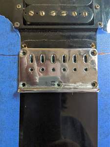

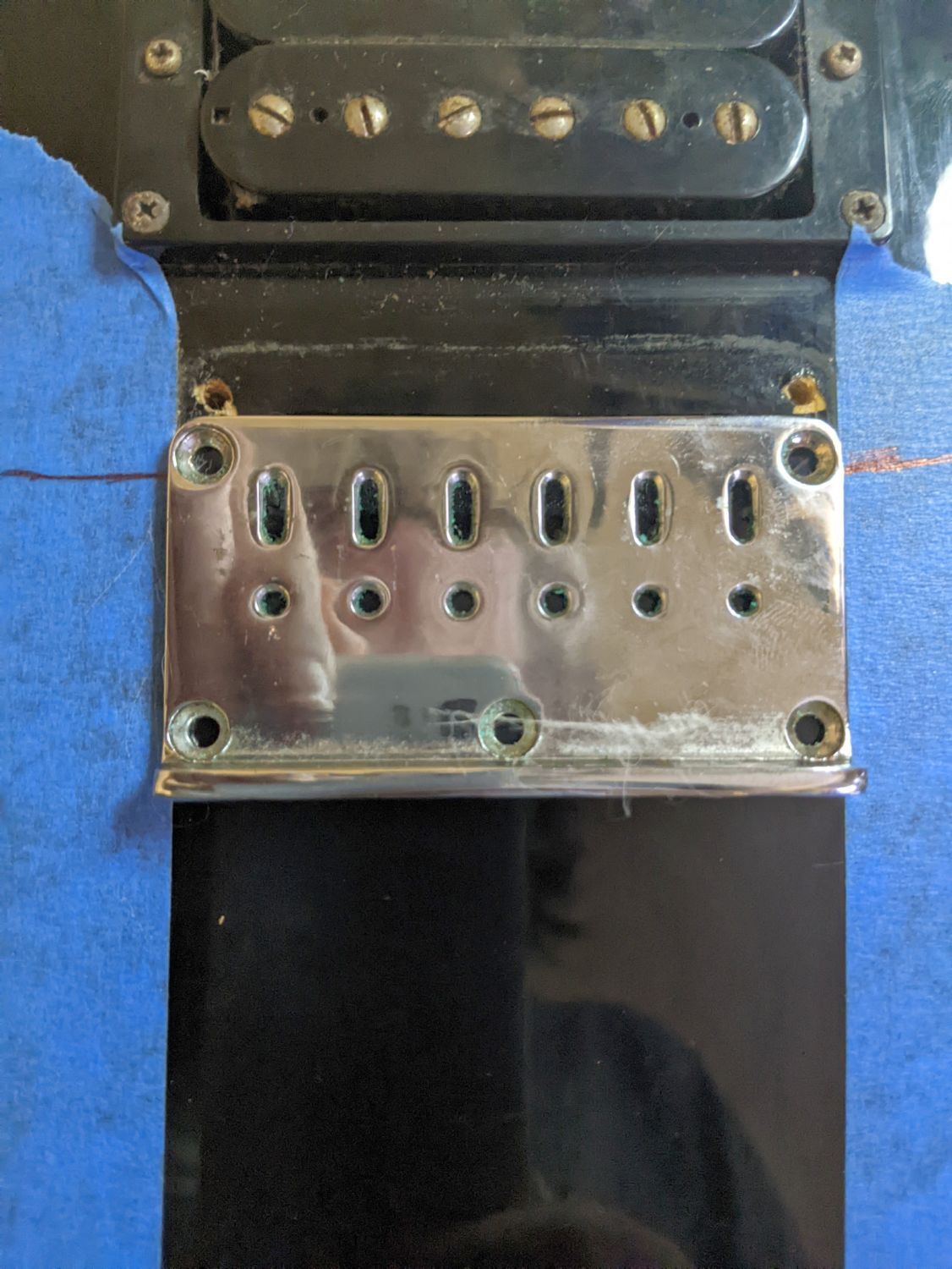

    With the bridge positioned where it is, the front-edges of the saddles are very close to where the scale-length ends up, the guitar uses Fender's 25.5 inch scale-length, I found this out by getting my 600mm steel ruler that also has inches marked on it, and I used my Fender Stratocaster to mark the spot where the middle of the 12th fret ends up on the ruler, next I used the ruler to do the same on the peavey's neck and the mark ended-up exactly in the middle of it's 12th fret.
    Next, I got my roll of blue painter's tape and put some tape either side of the Peavey's bridge, and used my ruler to mark where the scale-length ends, turns-out I was right, with each of the string-saddles adjusted back as far as they could go against the back of the bridge-plate there was about 2mm or so between the end of the scale-length and the front-edge of the saddles, no wonder the strings always played sharp at the 12th fret, I'll post a pic here tomorrow so you can see what I mean, I have the intonation for each string on the Peavey adjusted as best I can, but the low E-string, and G-string (the worst offender) are both still reading sharp even though both are adjusted hard up against the back of the bridge, the high E-string seems close to perfect with the b-string, the D-string and A-string still a bit sharp.
    I wonder what kind of finish Peavey used on these Generation EXP guitars, if they used a lacquer-based finish, maybe I could order some finish touch up from Stewmac that's compatible so I could cover-up any hole plugs to make them invisible, then I could easily fill-in the old holes and carefully drill new ones.
    I'm convinced that the bridge being wrongly placed is a mistake that occurred while the guitar was being manufactured, and my guess is that someone didn't pick it up during their Q.C. inspection, so a huge batch of these guitars were made with the same manufacturing mistake....well, my theory anyway.
    I did notice that if all the string-saddles were adjusted so that they covered the racetrack holes, then each string would play horribly sharp at the 12th fret.
    Here's my understanding of correct bridge positioning with regards to good intonation adjustment, the bridge needs to be positioned so that the scale length can be easily lengthened in order to compensate for the string-tuning's tendency to go sharp when the string is fretted at the 12th fret due to the increased tension on the string, you should never have to shorten the string so it is shorter than the scale-length in order to compensate, unless the bridge is too far back from where it should be, or there's some issue with fret-placement, or the neck has a twist or some other fault.

    Yes, the bridge needs to be moved back before the saddles could be moved forwards to cover the racetrack holes and your understanding of bridge positioning is correct.

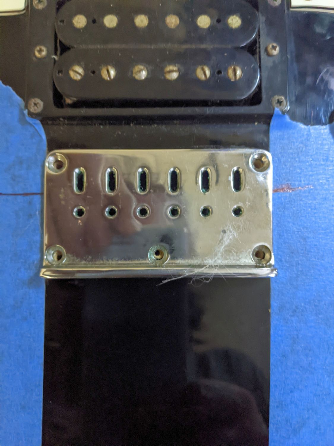

    I'm currently working on my Peavey guitar as I type this, things are really looking-up with regards to re-positioning the bridge, as luck would have it, I'm not going to have to drill a whole new set of string holes in the body of the guitar, all I will need to do is plug the existing bridge mounting-screw holes (5 in total), and drill new ones on the front of the guitar body, and that should fix the intonation issue for good, leaving me with plenty adjustment for lengthening each string, the six existing string holes all line-up with the holes in the bridge for the piezo pickups, so all I need to do is re-locate the bridge about 5-6mm back from it's original position.
    Only two of the original bridge mounting-screw holes will be visible after the bridge is re-located, but if I use a black sharpie to camouflage the plugs, it should look almost invisible.
    Here's a pic of the bridgeplate in it's original position, the pen marks on the blue painter's tape indicate where the scale-length ends:

    Here's a pic of the bridgeplate moved to it's new position, the end of the long holes in the bridgeplate end-up right over where the string holes were:

    Note that the row of small holes in the bridgeplate are where the strings would normally pass-through, hopefully that should fix all the intonation issues with all the strings for good, allowing me plenty of adjustment-range for lengthening the strings to compensate for any of the strings playing sharp at the 12th fret, the low E-string and G-string being the worst offenders.

    All looking good. Sharpies are wonderful things for covering up small marks and repairs. I use them all the time.
