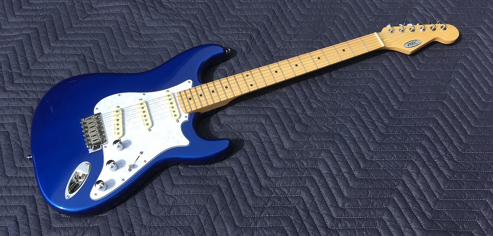

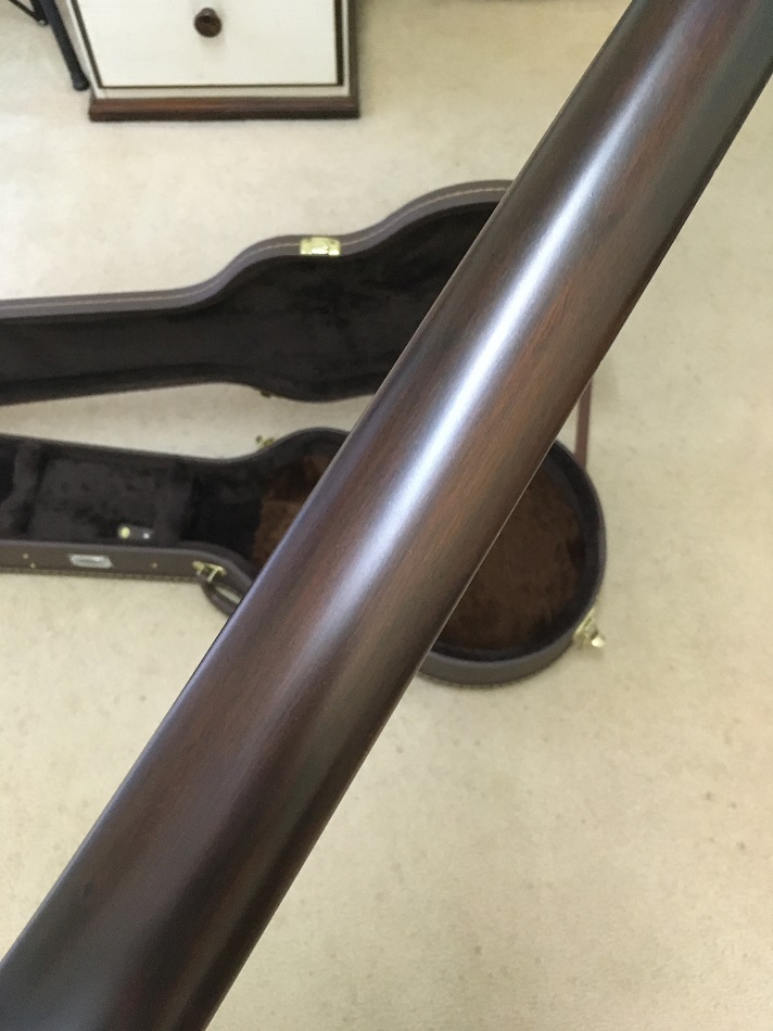

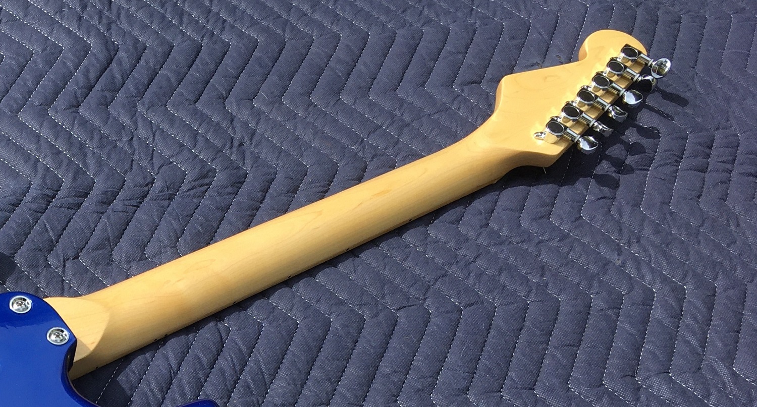

    The two necks below are done with all satin poly. They both would have 9-12 sprayed coats which amount to many many many wipe-on coats. I don't think they look cloudy at all. They just look satin to me.
    Tip: If you right-click and open in new tab, they will open nearly full size.
    Maple neck on strat:
Name:	ST satin neck 1.5k.jpg
    In it's full glory: (sorry just had to...)
Name:	MRC 2020 ST_crop.jpg
    Mahogany LP neck stained, then satin poly:
Name:	Mahog neck w stain.jpg
