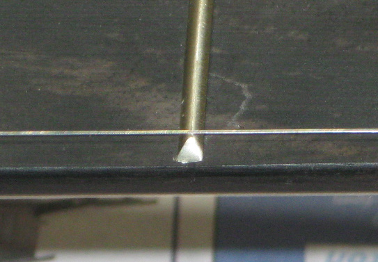

    The only real concern I have is the fret ends. Too much material can be easily remedied but it seems the guy that did my neck was a bit too enthusiastic about his job. It's not particularly worrying apart from this one, where they've actually come into the board. You won't believe how long it took to get a decent photo of this.
    What do you reckon, brown trousers time or no. I've tried fretting it as is and it is doable (just) but of course this is no gauge to how it's going to act with decent action and proper string tension.
    From that angle there doesn't look to be much meat on that fret to play with. How does it look square on from above, and particularly when compared to remainder fret ends along that side of the fret board.
    If it looks faulty suggest you email Adam with some photos and see what he suggests.
    By the way, Welcome to the forum.

    it does look a bit short!
    Mentor Andyxlh's Avatar
    1,206
    if you go with a Japan Brown or similar dark stain you might make the wood match ok
    At the very least it looks like that neck needs a new fret fitted in that location.

    Yep, was thinking this would be the case but thought I'd better consult the hive mind first. Will be able to email some better shots as I won't be restricted by file size like on here. It is noticeably shorter than the rest, I zoned in on it as soon as I got it out of the box.

    Have a replacement fret showing up soon so will be getting a crash course in fret work soon. Adam did graciously offer to compensate for a tech to do it but I'm not aware of anyone that does that sort of stuff locally and as a bonus by the end of it I'll know how to replace a fret. Youtube here I come. Might go see if I can grab some test pots of stain next week to try on some scrap too. Not 100% on pickups yet, all I know is that I want something hotter than the dimarzios in my Ibanez.
