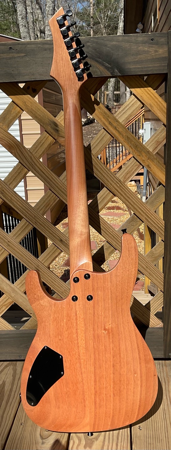

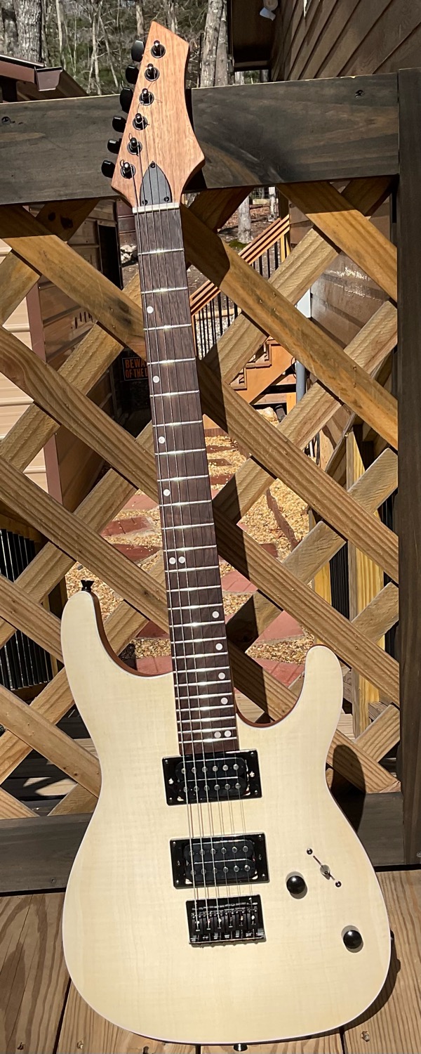

    Thanks for the response but I ended up finding an 8 contact 3 way switch setup up like my kit. From what I gather it’s a typical strat setup. I am so new at this I hadn’t a clue. It’s done and I will try to post some pics. Crossing fingers….

    Good work. However I'll just point out that your neck pickup ring is back-to-front. The slope on the ring typically goes from high to low in the direction on the neck. (just like your bridge pickup).
    Not a big deal, just thought it worth mentioning.
    Thanks on that, wondered why the cant and saw no mention. Have more tuners coming and will change then.
