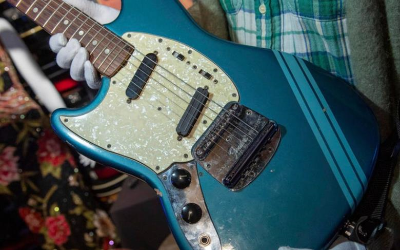

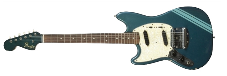

    My son has been asking for an electric similar to the Kurt Mustang from Smells Like Teen Spirit. The competition Lake Placid Blue guitar like the one in the attached images.

    To start with I was hoping for advice on the right colours and where to source them?
    As far as I can tell the Lake Placid Blue is a metallic version of the Ditlzer PPG paint code 11711, I haven't a clue where to get it though.
    Also, I have no idea what the competition stripe colour would be.
    Any advice would be greatly appreciated!

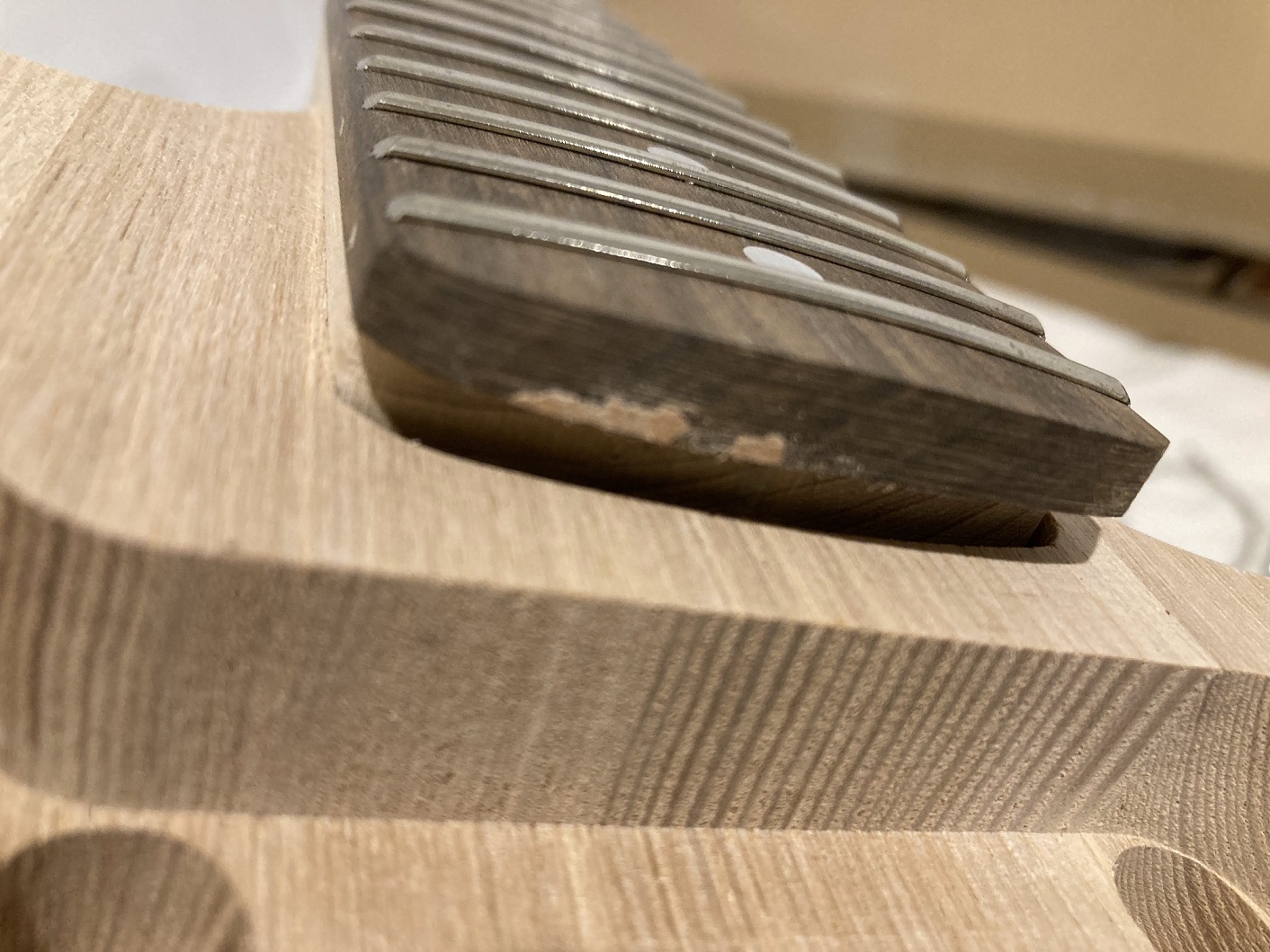

    I had a query about the neck pocket - I tried to get a photo of the neck and body interface, but it was a little challenging. How close should the radius on the bottom of the neck match the body?
    The neck in this kit looks to be sitting on the corners only - Is this normal?

    The end of the neck should ideally match the curve of the neck pocket, so if there's a big gap as it's only touching at the corners, I'd certainly work on the end of the neck with a file. I've used chalk on the pocket walls before. Push the neck in, and where there's chalk, it's touching, so you need to file off those bits. Repeat until you've got chalk over most of the end of the neck. You'll never get a perfect fit (unless CNC machinery was used to rout out both the neck and the pocket, and the Chinese factories don't use CNC on the kits). As it's a 22-fret neck, it's got that overhang which will hide any small gaps - which will be between the scratchplate and the neck, rather than the body and neck.

    The gap at the neck pocket is about 2-3mm, but its hidden by the fret board so a little hard to see. PBG said it should be fine as is, but I think I will have a crack at reshaping the neck to fit the pocket over the weekend. With this, you would reshape the neck to fit the pocket right?
    As there's no one at PBG (according to PBG) who actually builds guitars (or engages with customers on this forum), or is able to check kits before they go out with obvious faults, I'd take that comment with a pinch of salt.
    You also have to consider the scale length issue. If the neck is basically moved back 2-3mm from the end of the pocket, then the bridge saddles have to move the same amount further forwards. You'll have to see if this works with the bridge supplied. The bridge post holes are pre-drilled, so you are reliant on the neck being set the right distance from the bridge.
    You'll need to check on your kit what the best neck position is. Wrap tape around the posts so they fit securely in the holes without fitting the post inserts, then with the neck in position, measure the distance from the nut high E slot to the high E bridge saddle (at the point the string will stop contacting the saddle) with the saddle set almost all the way forwards. Use a metal rule (not a tape) to measure the scale length. If it's longer than 25.5" (647.7mm), then you'll definitely need to round the end of the neck heel so it fits in the pocket properly and so moves the neck nearer the bridge. If it's that distance or a bit shorter, then you're OK.
    Yeah, I wasn’t overly convinced with the advice from PBG.
    Checked the scale length, definitely out by 2-3mm.
    Slowly working in the neck corners when the little one heads out with the boss. So far looks like the neck has moved forward about a mm or so. Once I get it roughly flush I’ll post some photos of the sanded areas of the neck.
