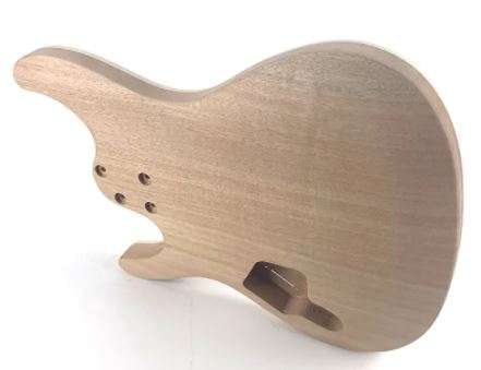

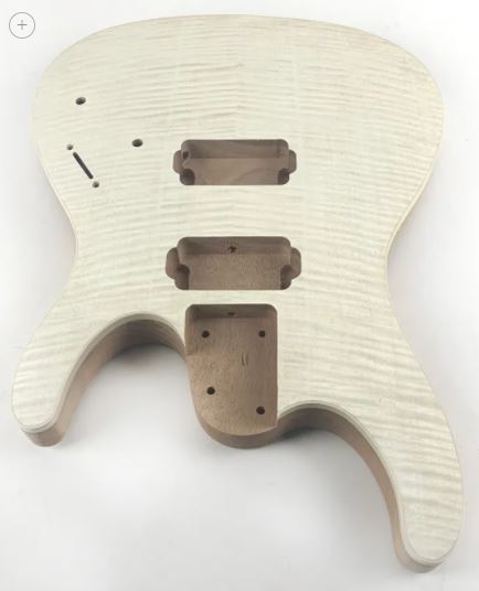

    I think I have the correct wiring diagrams, but I'm unclear on how to earth to the bridge. The bridge is solely on the top of the guitar, there are no metal posts into the body.

    You will need to drill a hole under the bridge that goes to the bridge pickup cavity. Strip the wire and splay the threads so that they make good contact with the bridge when it is screwed down. You don't need to solder. Contact is enough. You can attach the end that goes to the pickup cavity on anything that is grounded.
    Your distance looks short enough so that you might get away with regular drill bit, but I use a long bit to get a shallower angle between the bridge and cavity. You have to be careful to keep the angle shallow enough not to drill through the body. I came uncomfortably close do doing that on my last build ;-)
