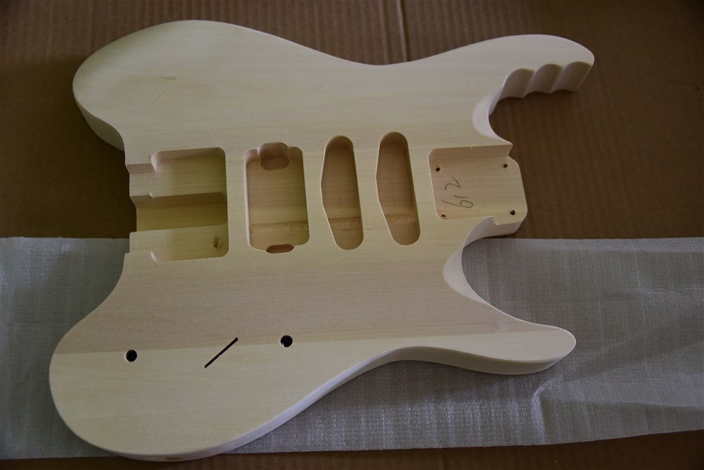

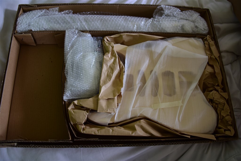

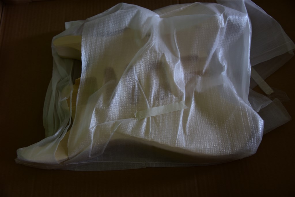

    Well it has arrived, undamaged despite having travelled about half way round the world since leaving Perth Western Australia.

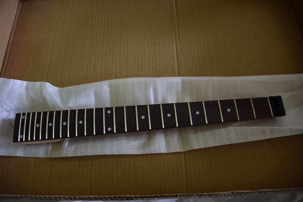

    Checking the wooden bits first:
    The neck looks to be OK, probably will need a fret levelling when completed and a tweak on the truss rod, but that is to be expected as even new Fenders and Gibsons need that all too often.
    Body looks OK, but that is going to get a lot of tender loving care from various tools so any minor imperfections will vanish in a cloud of sanding/saw dust.
    Neck/body joint is over tight, with the neck about 0.5mm wider than the pocket (it's a screwed on neck). Easy to solve and better that way round than the 4mm of packing on width that was needed on a friend's bass (not from PBG). Not able to comment about alignment yet as I've not got the tools and sandpaper out yet.

    Simple task to get the neck to fit, just scraped off a couple of high points and the neck squeezes in, tight but not overly so. I'll have to check that all the routing is OK, but the pickups & bridge all sit in the pockets but I do need to check the alignments.
    More thoughts on the reshaping....No cutting yet as I'm not sure.

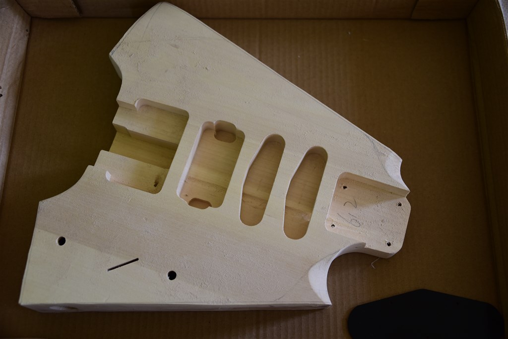

    A few pictures from arrival day:
    ...Ah, just found I can only attach 5 pictures per post, so that's all for this one; more to follow.

    That's all the arrival photos (well, not all, just a few to show the condition on arrival.

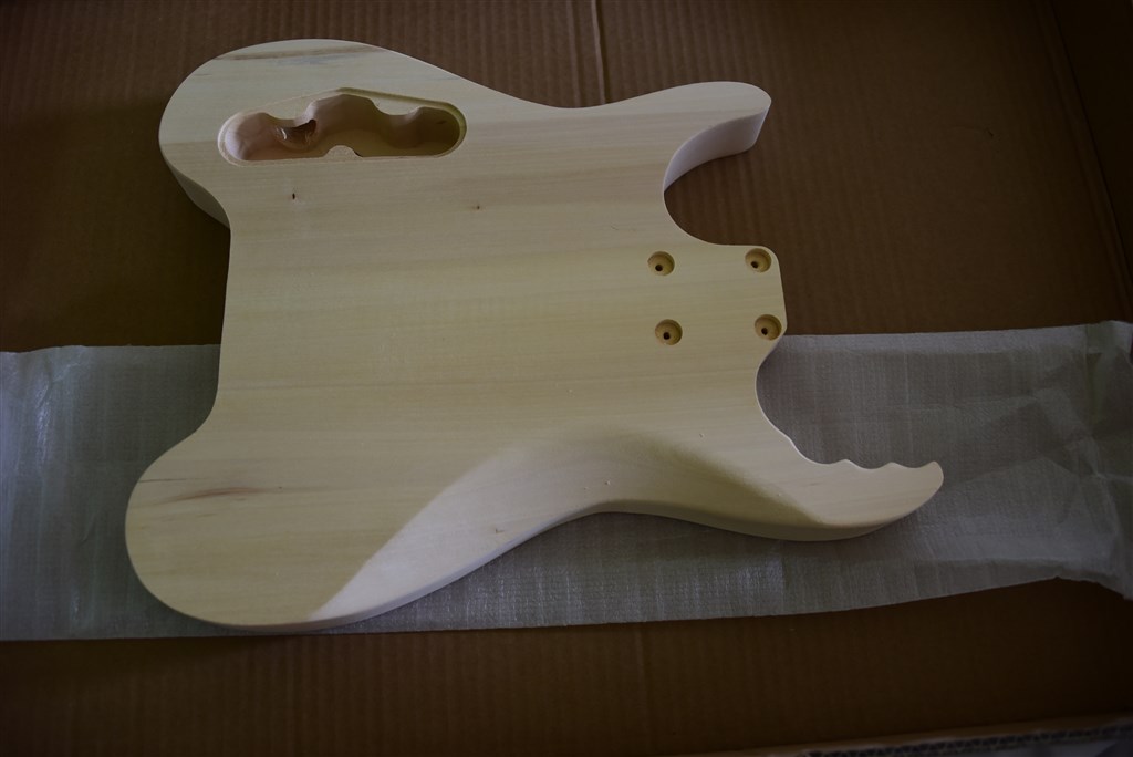

    Since then I've dry fitted the neck, checked the scale-length, marked up for re-shaping the body....
    Then got the saw out and the reshaping has begun, roughed out to a few millimetres outside the finish line and sort of started to think about the various scallops. Lots of dust being generated :-( (I must remember to put a mask on BEFORE getting the sander going)
    After cutting to the line I put the neck on (unbolted) just to make sure the new shape felt right - it didn't, the angle at the lower side was too square to the line of the neck, so that's going to be sorted later today.

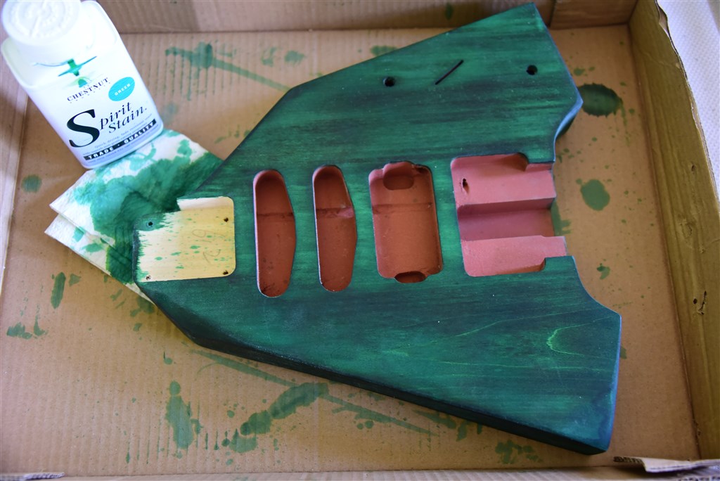

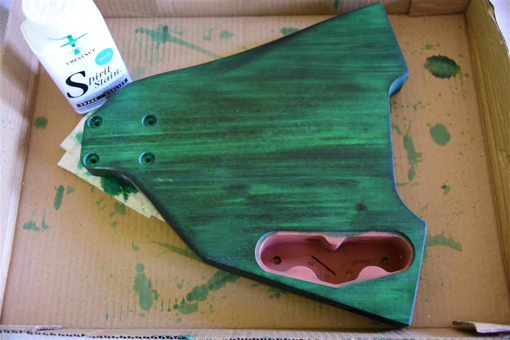

    A bit more progress.
    First I've finished the reshaping, power tools to get to the basic shape. Basic shape using a saw in a multi-tool, next level of shaping with a flap disk on an angle grinder (lots of dust generated), then a palm-sander to get down to the line; finally finishing by hand with a variety of sand paper and flexible pads (more, finer dust).

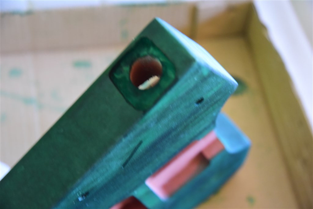

    The add the colour. I'm using Chestnut's green Spirit Stain, it took a few coats to get the depth of colour I want. Then a very gentle flat with 600 grade paper (just to get rid of the suicidal flies that arrived...) before a very light blow over with clear varnish (again from Chestnut). I did this because I'd tried various approaches on some of the off-cuts generated in the re-shaping and I found that trying to get a "mirror smooth" wood surface without a coat of varnish meant I lost the depth of colour, and using a sanding sealer before putting the stain on led to the stain "skidding off".
    After the first sealing coats a quick flat (600 grade again) and a couple of coats to build some depth of varnish so I can start the final build-up, which will be in stages.
ID:	41628 Click image for larger version.
