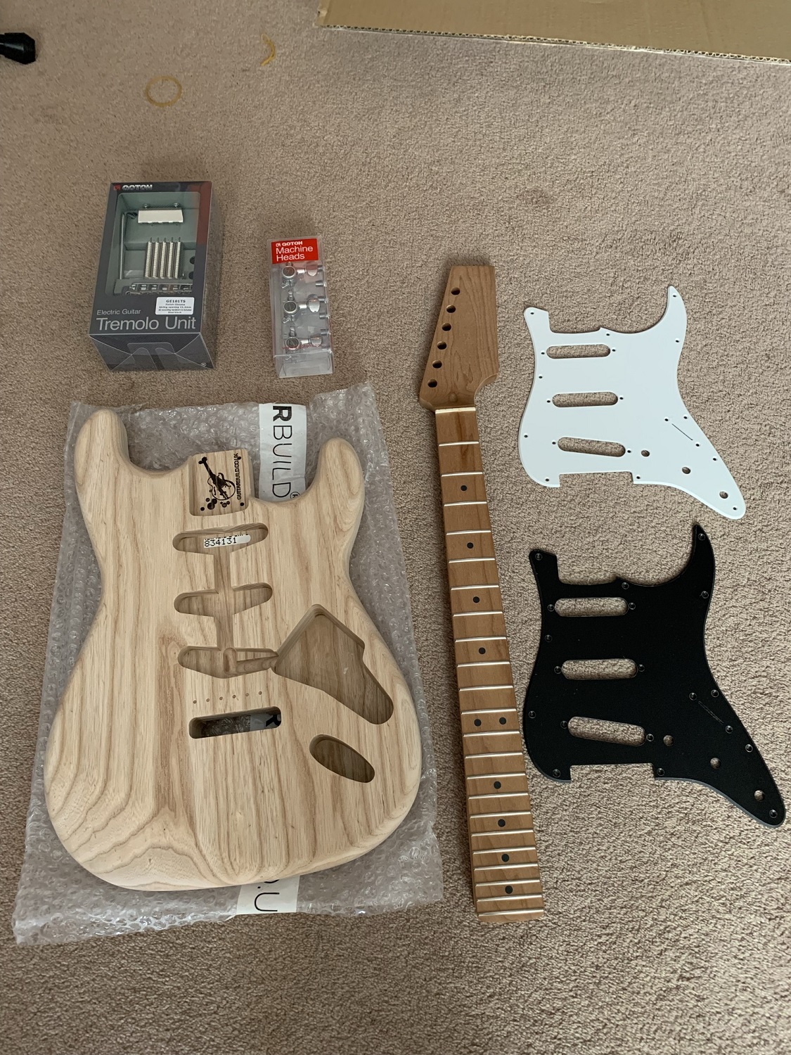

    The bits have started to arrive:
    The body is nicely finished - if a little heavy - but I guess that's ash for you. The neck fit is a little loose but I think once there's a few coats of finish on it it will be good.
    I need to check the scale length and stuff and also want to make sure the height of fretboard is right. Compared to my Elite the total thickness of the neck + body at the heal is the same. But still need to run some strings and see how the string height looks.
    The Gotoh bridge block looks to line up well.
    I got two scratch plates as I can't decide what's going to look best with the body colour.

  9. #7
    Yes, ash is heavy unless it's 'swamp' ash, grown in very wet areas which affects the way it grows and leaves it about 30% lighter once it's fully seasoned. Swamp ash is any type of ash grown in those conditions, but is normally white or black ash.
    Climate change means a lot of those swampy areas in the US where a lot came from have dried up, and add on ash die-back, and it has become too scarce (and therefore expensive) to use for major manufacturers.
    You mentioned that it was a two-piece body, but it looks like a one-piece body to me from the grain lines. Looks nice, and a shame to put it under a solid colour. You might as well get some visual benefit from the weighty body.
    I know the extra fret can be useful, but 22 frets with the overhang always mean you have to take the neck off if you want to remove the scratchplate. No easy way round that. Still, capo on, slacken strings, undo neck and away you go.
    Yeah - swamp ash was about double the price. Rehearsals will be good work out!
    Deffo two piece. As this view shows.
    But I agree - the two pieces match up really well from the front. Yeah, it’s going to have to have to be a trans finish.

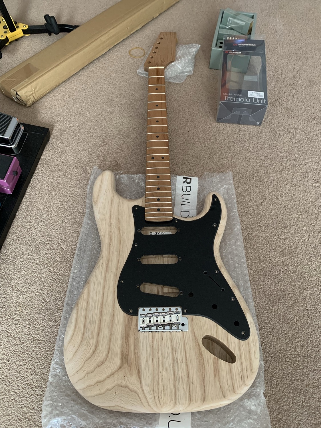

    I finally got a few minutes to mock things to see where I’m at:
    The string height and scale length all look good and the strings are running evenly down the neck.
    Next step is start sanding and thinking about stain…
