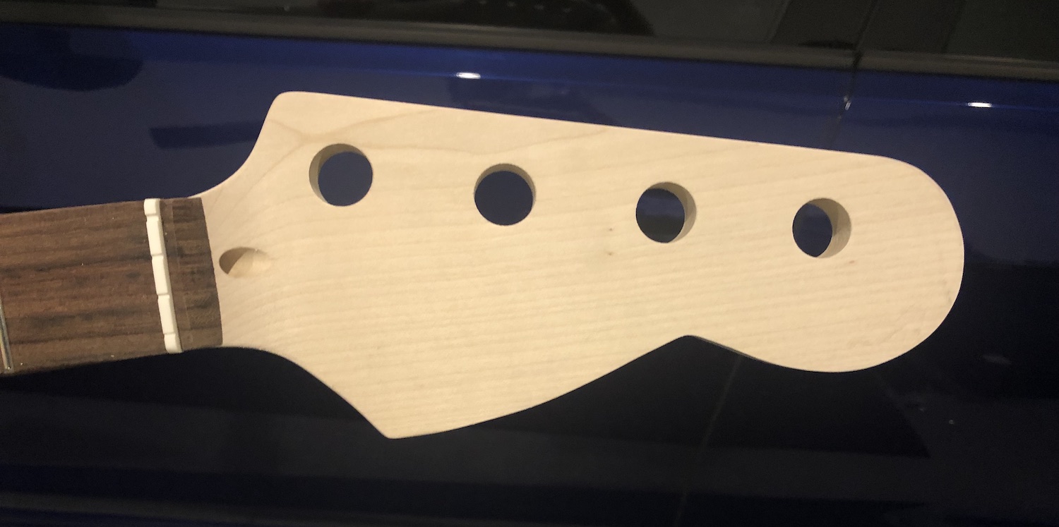

1. Shaped the headstock. I was going for a F-type vibe, without being too similar. I hand drew the pattern on the paddle and cut it out with a jigsaw (using lots of relief cuts, as the maple is hard).
Name:	1 headstock shape.jpg

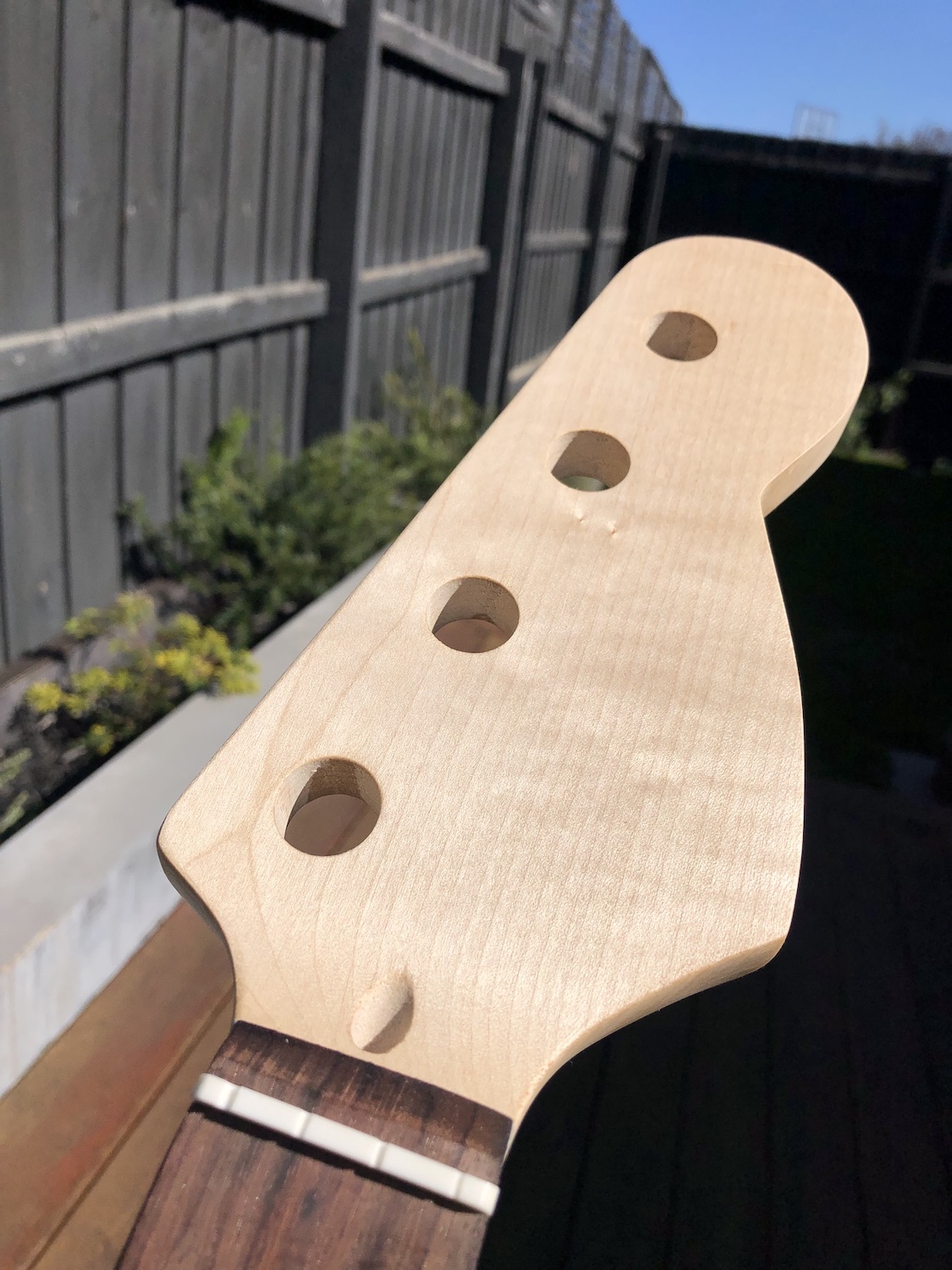

4. Finished the neck with 6 coats of tru-oil. First 3 coats applied with a clean rag, then a scuffed with 0000 steel wool, then three more coats with a clean rag. I think I got lucky using the steel wool, and didn't leave any metal bits in the finish, but next time I would probably use high grit sand wet/dry paper (thanks Trevor)
Name:	2 headstock finish.jpeg
I think I'll leave the finish on the neck there, as I'm a big fan of a satin feel. I'm hoping that I'll end up close to my favourite neck so far: back in the day I had a 1999 Maton MS500, and I hand-polished the neck on that thing through lots of practice and gigging. I'm hoping that with a light tru-oil finish and some play wear, I'll get to the same place with the neck on this.
