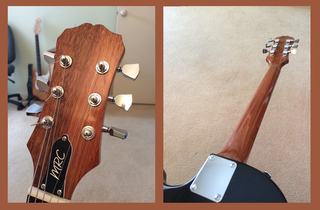

    This is a mahogany neck of mine that is simply finished with Tru Oil. As you can see, it's got quite a red hue to it:

    This is another mahogany neck that was a more pale natural colour and I dyed it with water based dye and clear coated with satin poly. It took the dye very evenly. The lighting makes it appear lighter in the middle, but it's very even IRL.
Name:	Mahog neck w stain.jpg

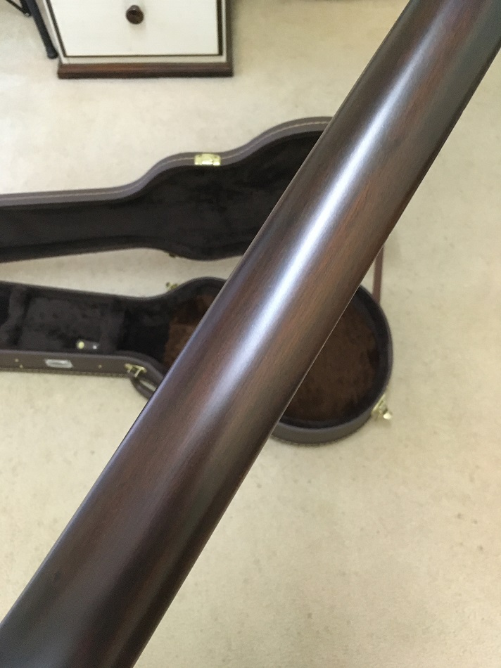

    It is a very pale colour, much lighter than the mahogany body on my other kit. To be honest, I had to go back and double check the kit specs when I got it. But the grain does have some aspects to it that look like the mahogany body on that AG. I'm by no means a timber expert, however.
    In checking that other kit, I realise now that the finish is much more even than I remembered. Think I was getting confused with yet another kit I was building at the same time which wasn't mahogany, it had a maple neck. I'm getting too old to be trying to do more than one thing at a time. That one ended up quite blotchy (yet another "I did that on purpose" finish).
    So, maybe a real light dye is the way to go. Just a matter of trying to get the right colour and intensity. I'll have a small amount of off-cut to test with when I do the headstock.
