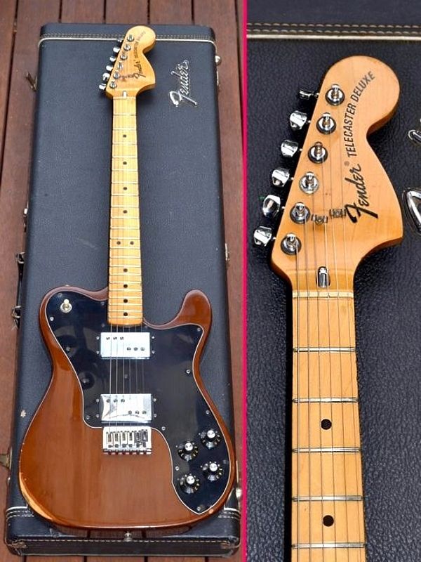

    As a reference, I'm using the 70's Mocha Telecaster Deluxe. I've always loved the color and the goofy CBS strat headstock. So, my preliminary concerns are:
    HEADSTOCK SHAPE: I'd love to cut a CBS-style headstock, but, judging from the images on the website, I just don't think there's enough wood in the paddle to pull it off. I might try to draw something inspired by it or just go with a regular Tele-style headstock, but, either way, there are no templates for seven-string Fendery headstocks on the web, I think...

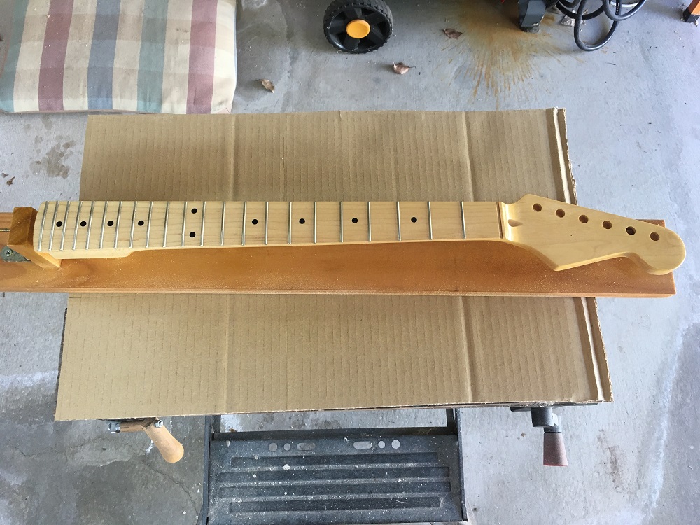

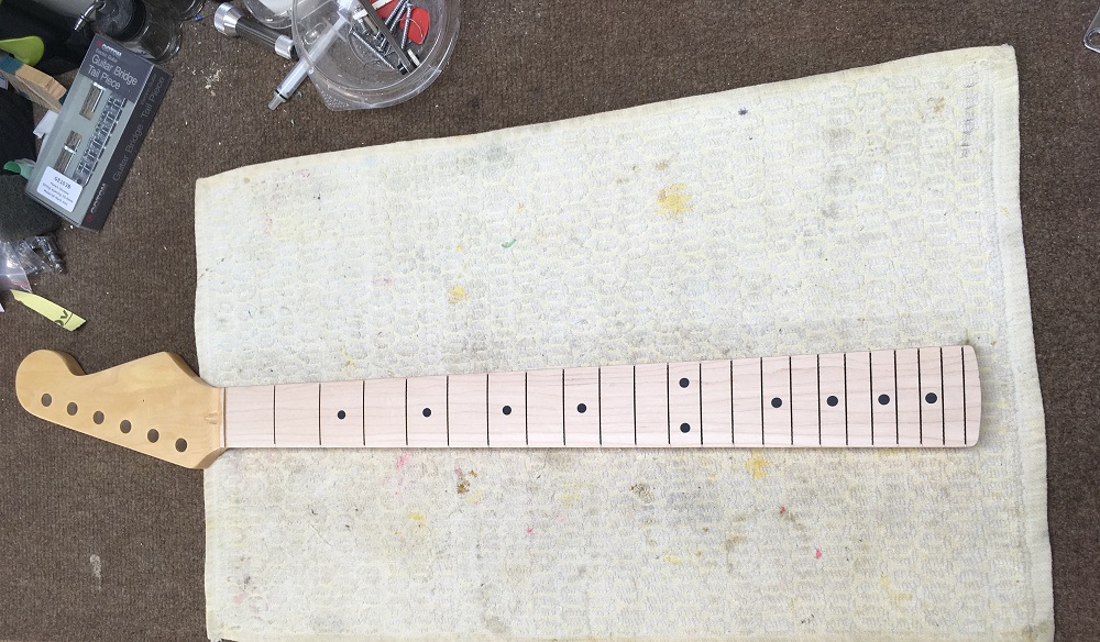

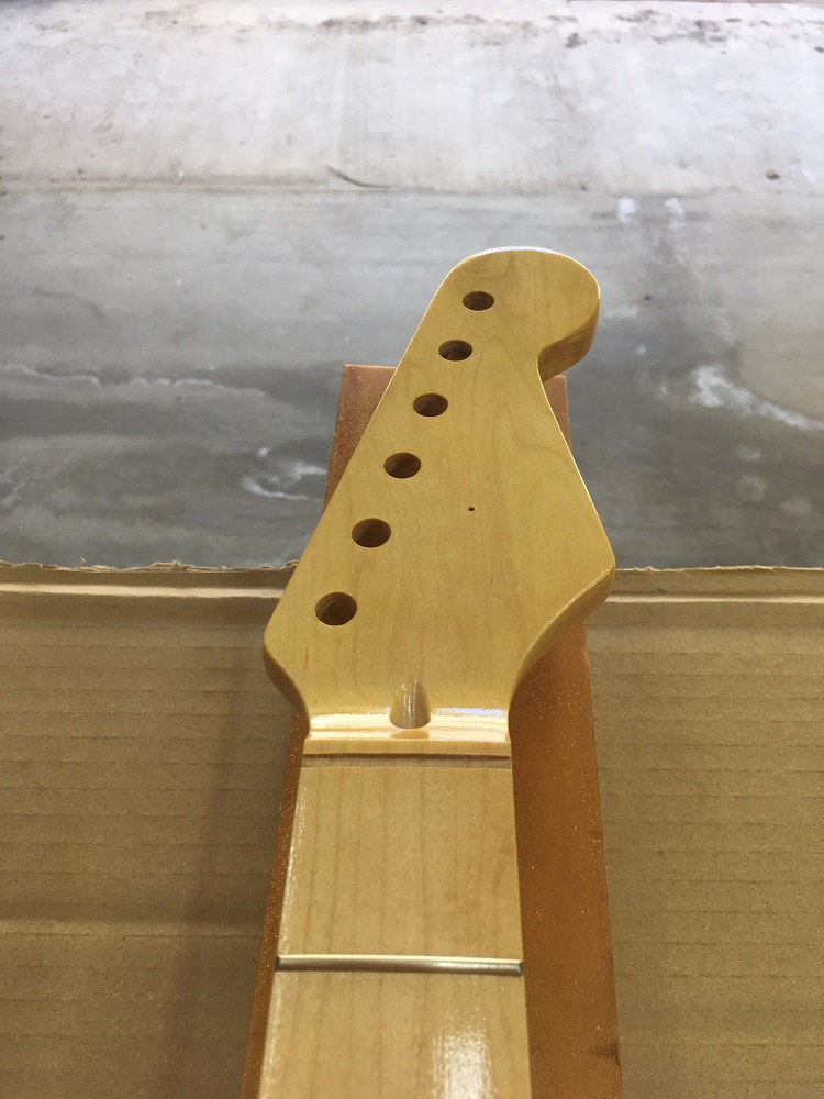

    Below is a neck I applied shellac to before spraying with satin poly. I had re-radiused the fretboard and and re-fretted, so you can see the natural colour of the maple in the first pic. Second one is after the shellac. The headstock shows the colour a bit better.

    That looks beautiful, McCreed. I might gobthat route with shellac and poly, then. Did you apply the shellac with cotton balled up inside a cloth? Did you have any trouble around the frets?
    Member jonwhitear's Avatar
    Sydney, Australia
    262
    That does look good. I hadn't thought about using shellac to give a maple neck a nice "vintage" tint, but that looks like it does the job nicely. Presumably, you could lacquer over the top of it. Is that blonde shellac?
    I sprayed it with my small touch-up gun, but have applied by hand before. I just use small squares of clean cloth folded over into a smaller square. I’ve done wipe-on poly the same way and not had any problems around the frets.
    Yes, lacquer goes over shellac just fine, and yes it is blonde shellac.
