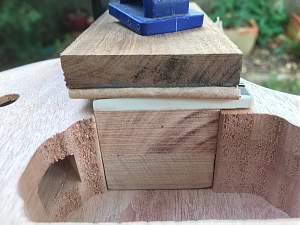

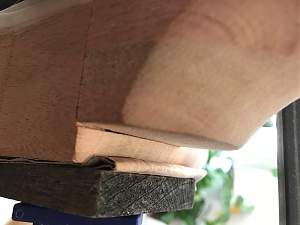

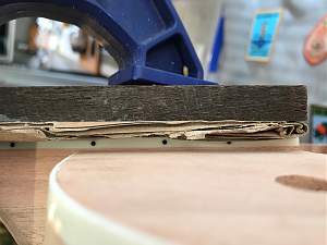

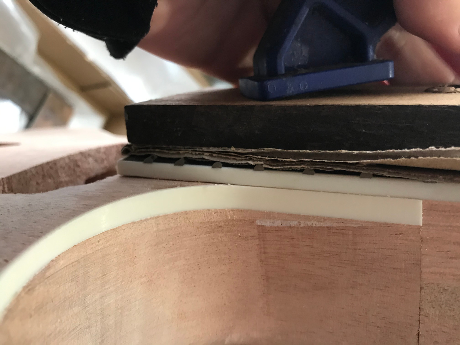

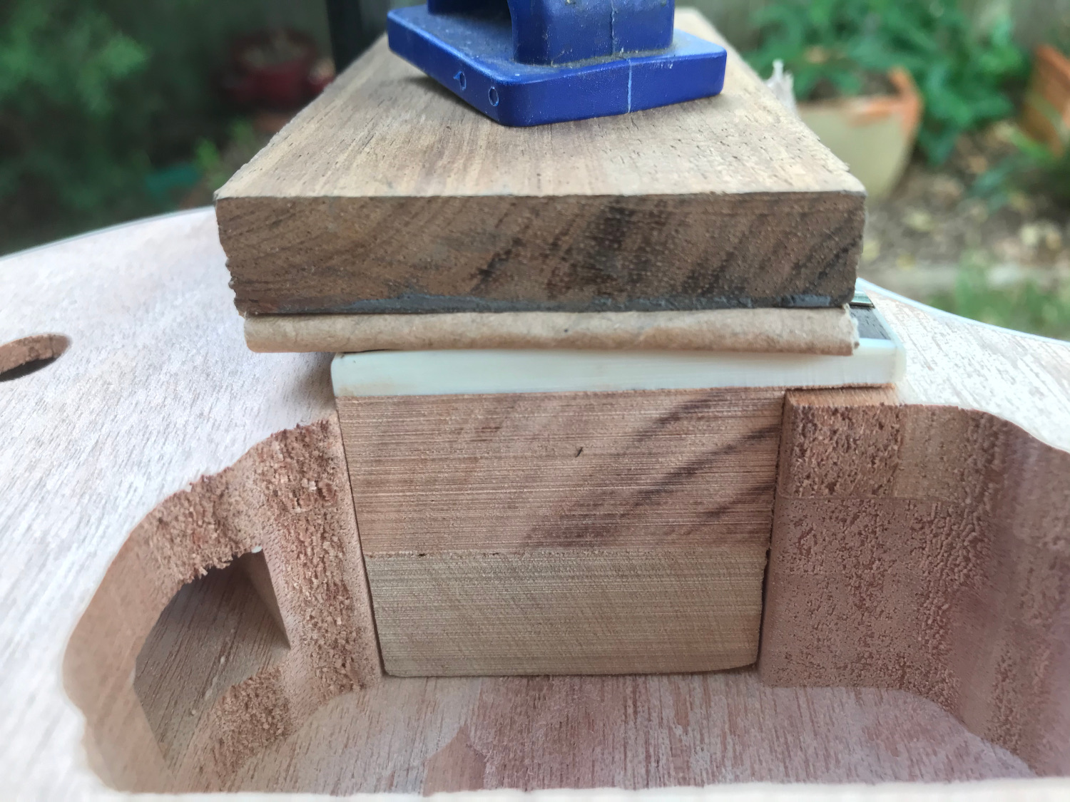

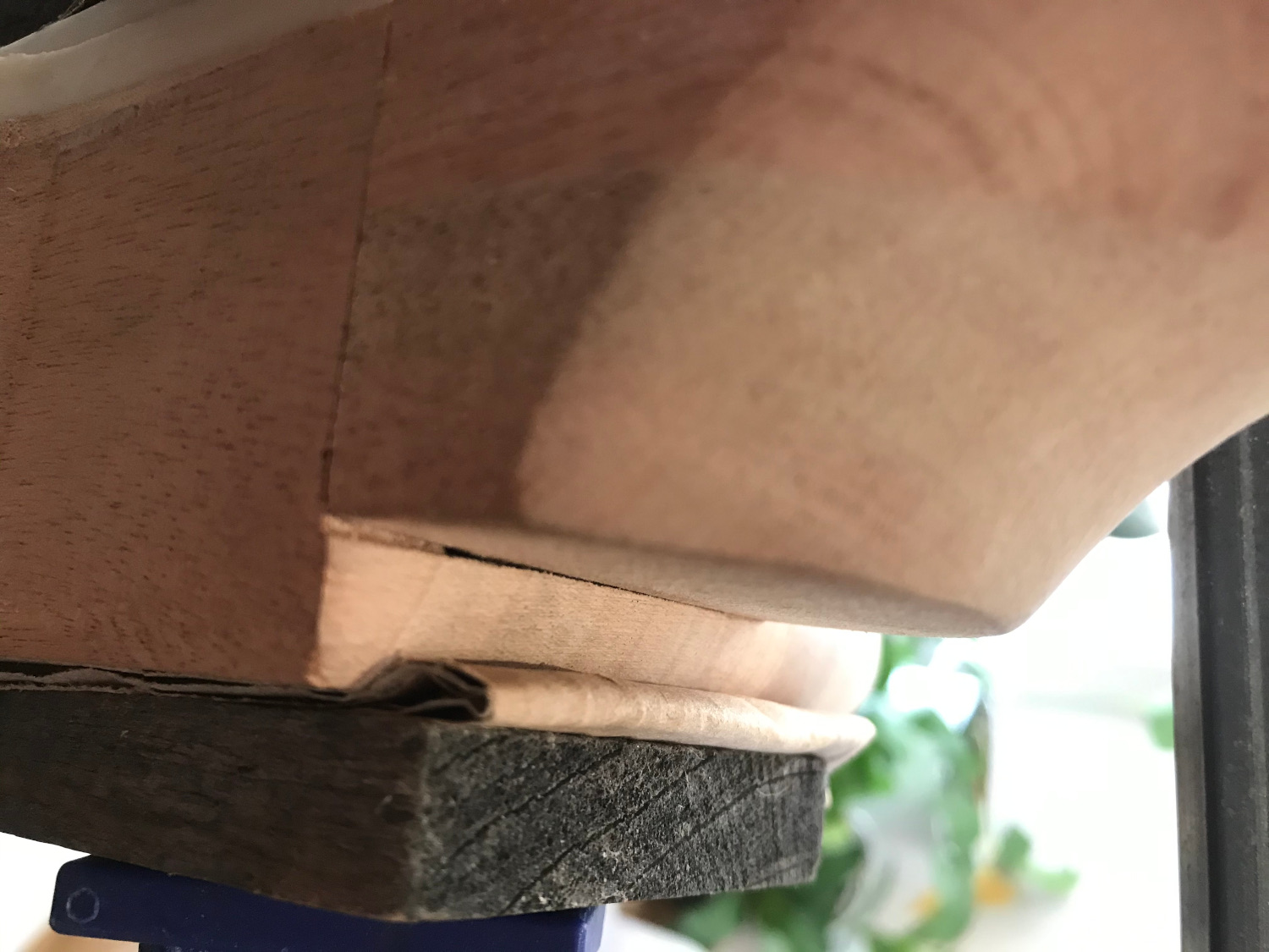

    I would appreciate some advice on the neck. It's a snug fit, but I'm not sure that it's seating into the pocket properly, i.e. I'm not sure there's a lot of contact between the heel and the floor of the pocket. Here are a few photos. Even when clamped quite firmly, there's a gap between the neck and the pocket, and a slight gap between the board and the top of the body. How would you tackle it?

    The neck will probably benefit from some work, but this sort of joint always benefits from being left a few days to let the timber acclimatise and settle down. It may improve slightly, it may get worse or it may stay the same. But you are best deciding what to do once it's in a stable condition.
    You'll want to use a set square to check the neck heel, and probably make up some small right angles from card to check inside the neck pocket. If something's out of true, it helps to know exactly which part.

    I just got this kit as well and the neck joint on mine is fine. It appears from one of the pictures that the neck pocket has not been routed flat (left side) so some work may be required to level it

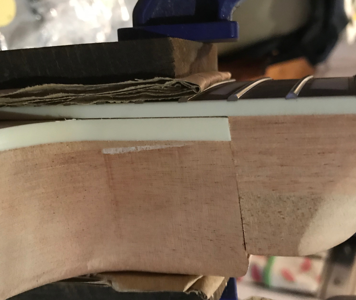

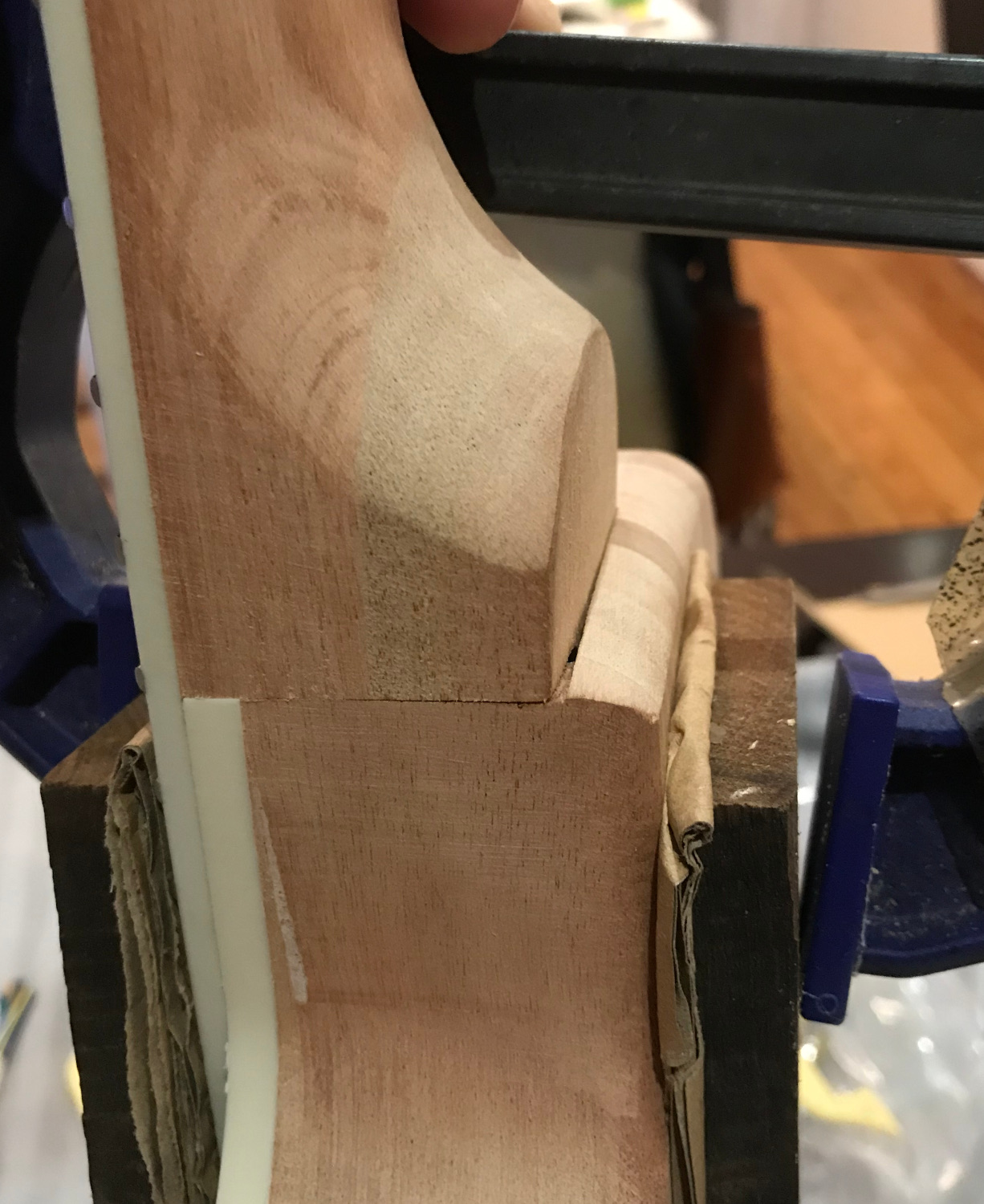

    After several days, things have certainly settled down.
    Everything seems to be reasonably square when measured separately, but that can't be the case given the gap between the heal and the body!
    I'm assuming that I'm aiming for the finger board and binding to be flush with the body, i.e. to eliminate the gap between the treble side of the board and the body. At the moment I'd say that gap is about a millimetre at the end of the finger board.
    Here's how it's looking now.

    Member stansby40's Avatar
    Mar 2019
    Tasmania
    93

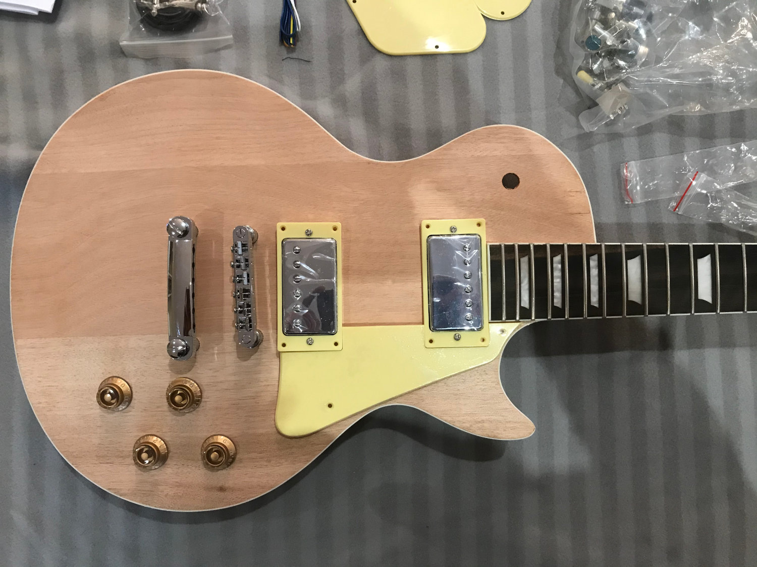

    On my kit the fretboard is not flush on the treble side as well but probably 0.5mm high. I am not concerned about this as I am painting the body and I can fix small gaps if I want to. It is probably more important to check the scale length and intonation (ie neck angle) by putting a mock up of the bridge in place and checking with, as I do, pieces of string from the nut to the bridge. I am very nervous about sanding necks and/or neck pockets as you can quickly alter the neck angle and be in a worse situation. I just noticed that the pick guard will hide most of the gap anyway.
    Build 1 AGM-1
    Build 2 TLA-1
    Build 3 ES-3
    Build 4 TL-12F
    Build 5 ST-1
    You'll be very lucky indeed to get a low-cost kit that didn't have some slight gaps around the joins. You've got about as good joins as any of my kits had. There's always going to be a small amount of gap filling required. Glue will do some of the filling, but you may need to try and colour some fine filler, so it matches the colour of the wood, and touch up the remaining cracks.
    The pickup ring will hide the gap under the fretboard in the bottom right picture above, so really it's just the side gap that needs a touch of filling there.
    The neck angle has normally been fine on the LP kits before, but as Stansby40 says, it's worth double checking.
