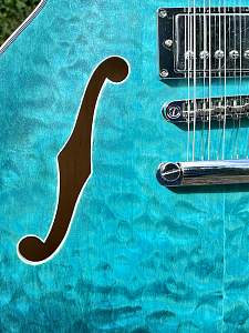

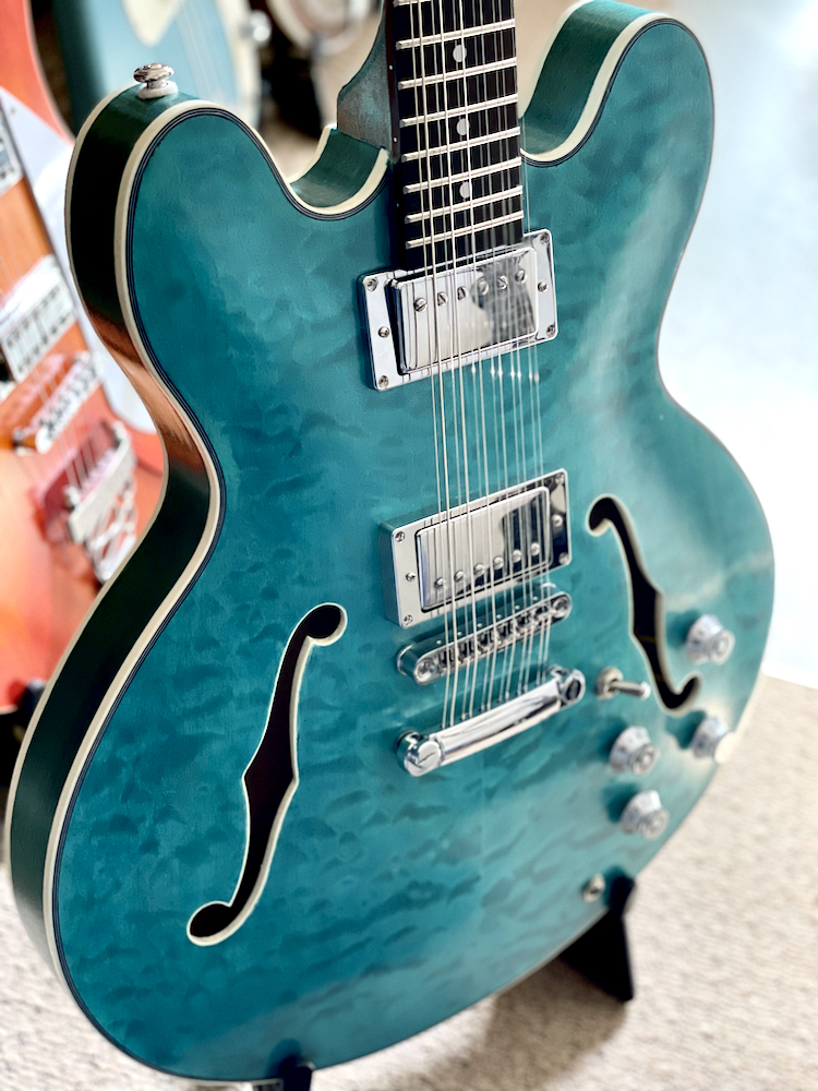

    ES-12Q - modded

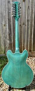

    Here's my entry, finished on the 2nd of May.
    An ES-12Q.
    Specifics:
    Wilkinson tuners
    Tesla Shark humbuckers from Iron Gear
    KAISH tuneomatic piezo bridge that I converted from 6 string to 12 string
    Kluson rimless bridge bushings to compensate for the greater height of the piezo bridge and the too-shallow neck angle of the kit
    No name tailpiece
    No name toggle switch
    3 IKN push/pull pots - coil splitting for the humbuckers, on/off for the piezo
    Stock pot and cap for the master tone
    mxuteuk witch hat knobs
    Generic 1/4" socket
    Copper shielding tape in the pickup routes
    Finish: Wudtone Azure Lagoon with silver mix-in highlights and extra gloss top coat

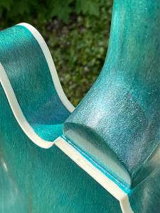

    And here are some detail shots

    Member Wayne.Mumford's Avatar
    CAMPBELLTOWN NSW
    236
    Nice work J, that colour is really nice and looks great on that quilted top. The way you have splayed the tuners is a bit different, I also found the tuners a bit close on my ES-12G.

    Member jmax's Avatar
    Oxford, UK
    106
    Thanks! I splayed the tuners both for practical reasons, and because I thought it would look interesting.

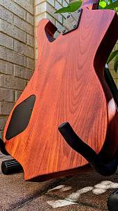

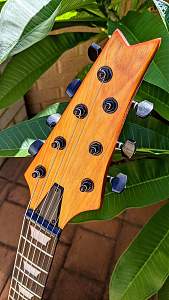

    Here is my entry for GOTM, finished on 5th of May
    Specs:
    27” scale length
    Basswood body
    Spalted maple top
    Maple neck
    Rosewood fretboard
    Tune-o-matic bridge
    Single volume knob with 3-way selector
    I stained the whole guitar with Colortone Vintage Amber stain and then used a Feast Watson Maple stain on the back over the top of the yellow, i think it worked nicely.
    Finished with boiled linseed oil and a couple of very thin clear coats on the top of the body and headstock for a slight sheen.
    The 27” scale length lets me get away with using a relatively light set of strings (9-52) for standard B and drop A, as well as having appropriate tension for my play style.
    The factory forgot the routing for the pickup selector switch, but as it happens i wanted to change the location of it anyway so it worked out well.
    The headstock in the image look ginormous but that's just because of the angle of the photo, it's quite a reasonable size.
    Future upgrades will include a graphite nut and some locking tuners, possibly a new set of pickups.
    I have always loved the IC shape and so happy to own this, super impressed by the quality of work by Pitbull guitars.

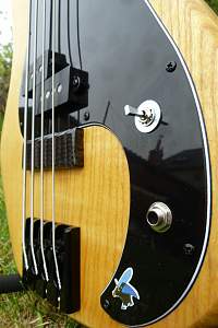

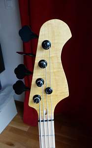

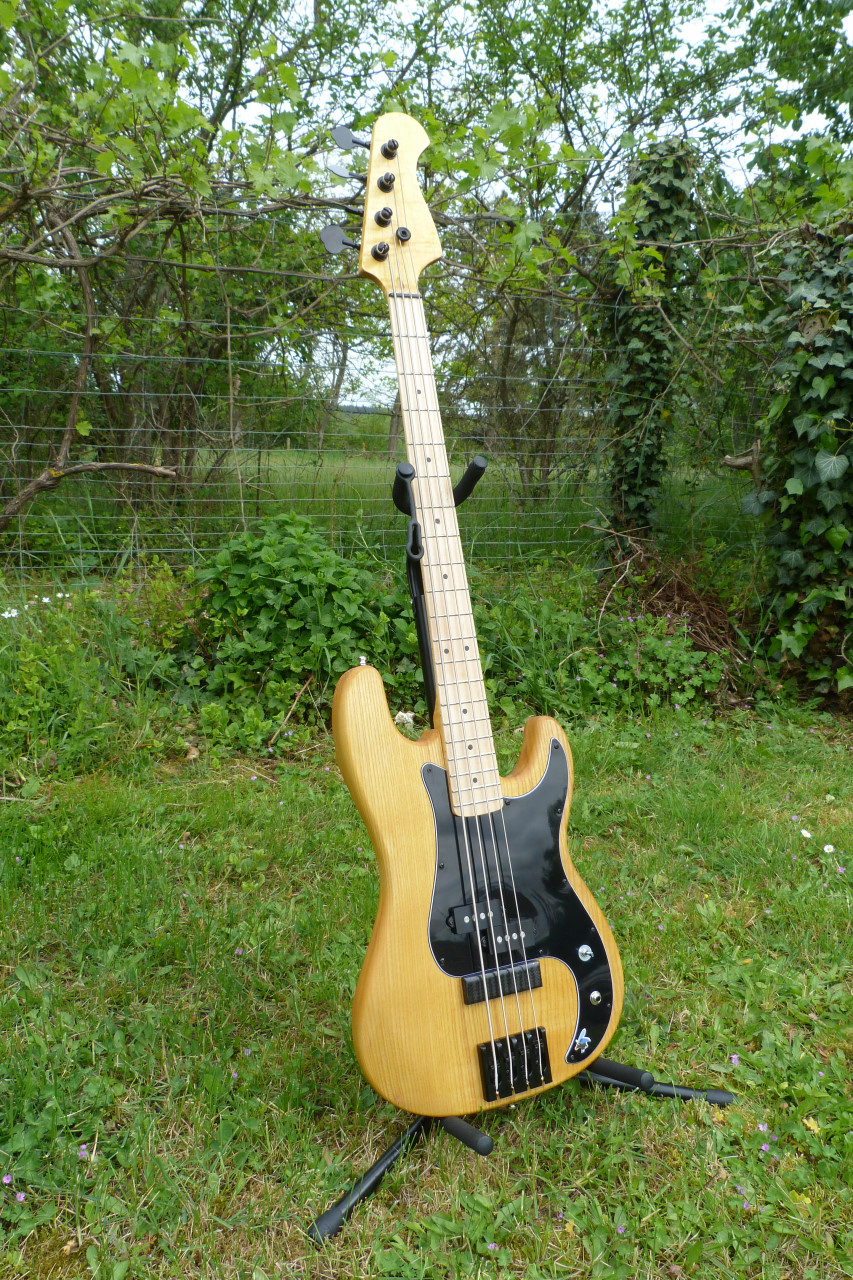

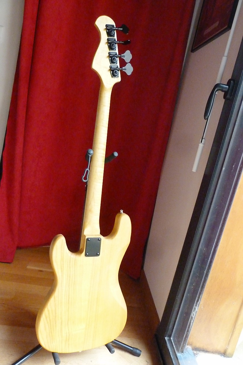

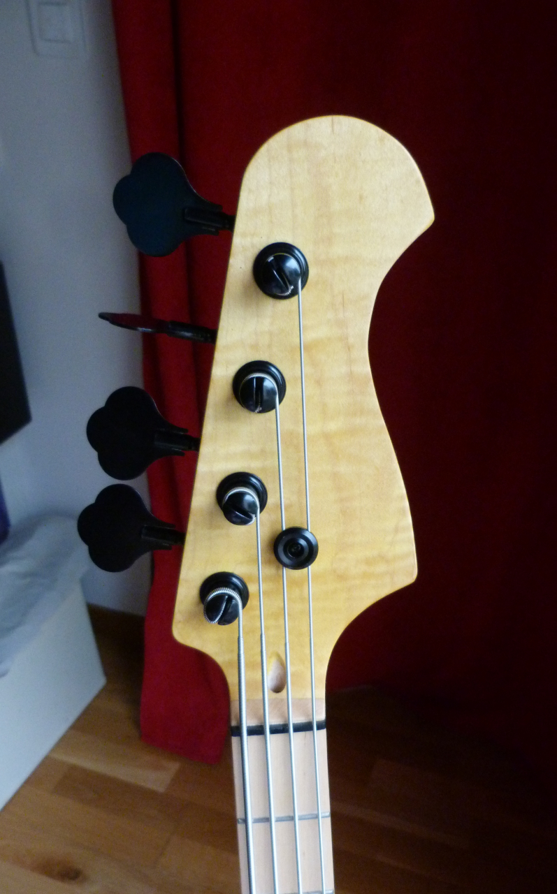

    Hi everyone !
    Here is my first Pitbull bass guitar, it's a GPB-4M with black hardware.
    - BEAD drop, so the nut has been modified for the bigger gauge
    - Seymour Duncan SP3B pickups + Homemade wiring --> microswitch CLEAN / OFF / FILTERED (capacitor)
    - Copper Shielded cavity
    - Homemade carbon thumbrest/fingersboard
    - Göldo heavy bridge
    For the finish, it's a nitrolack yellow stain + True Oil
    Since it was my first "real" build from scratch, I did learn a lot with this kit. It was kind of scary some time, afraid of making a mistake but in the end it was totaly worth it !
