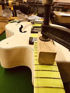

    Kit arrived mid last week - opened the box for inspection - some light cross-grain sanding marks on base of body where the timber join is, and a couple small glue marks - one on the front and one on the back, all seem to have sanded out without to much hassle at all on first light sand with 180.
    Taped up the fret board and straight edged the neck and frets - all seems to be spot on, small tap and touch up on one fret with small file and re-crowned and polished - good to go.
    Neck clamped to body with hardware fitted and the 2 E strings are dead straight and even down both sides of the neck and through to Bigsby. Between 1.5 and 2mm between string and frets with bridge at close to lowest setting. Drilled small (1.5mm) pilot holes for Bigsby mount.

    Have I missed anything obvious?

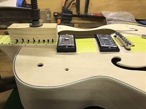

ID:	39548 is this the right position for the neck and bridge pickups with the taller one at the neck? Seems to be the best spot for string height I think.

    Rings should be other way around, with the tallest at the bridge, and the tallest edge of each ring toward the bridge also. Think of it as everything sloping toward the nut.

    Thanks for that. The set up in the pic was for neck alignment with everything in place so swapping them over should still be all good.
