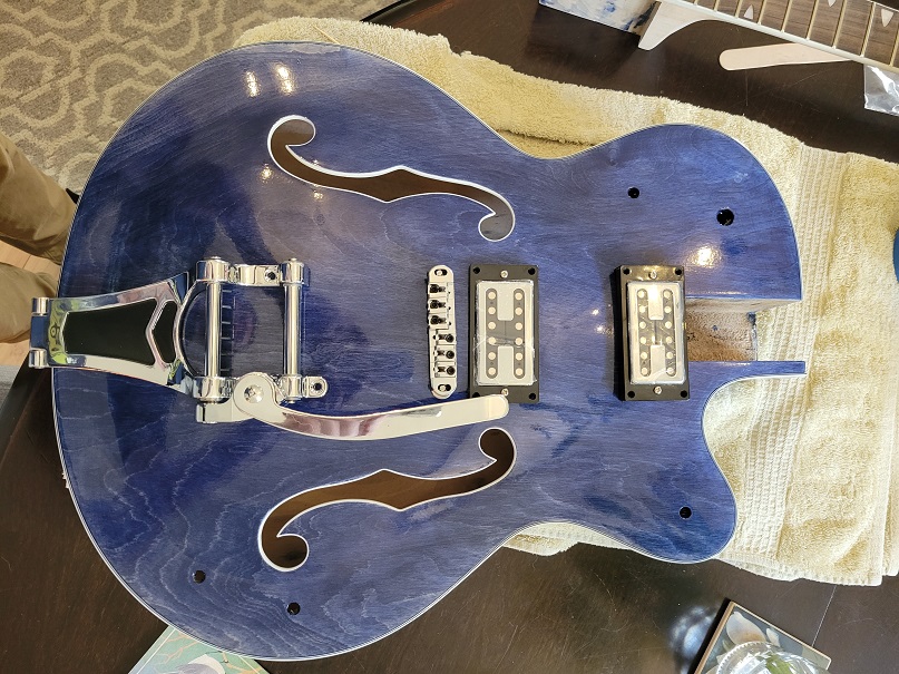

    Hi everyone, I'm excited to be here! In retrospect, I probably could have posted a little earlier in my build and avoided a couple of challenges, but I've moved past them and here we are now. Here's the body with dry fit components and (what I think is) enough of a lacquer build up to start finishing up. I'm thinking about sanding up to 1500 grit and then applying Minwax brand paste wax but I'm very receptive to a "Don't do that, do this instead" comment. Also thinking about staining the neck darker, like maybe a walnut and then going with boiled linseed oil on top of that. Again, if anyone has any other thoughts, I'm very open to another opinion. Thanks in advance for your interest and ideas!

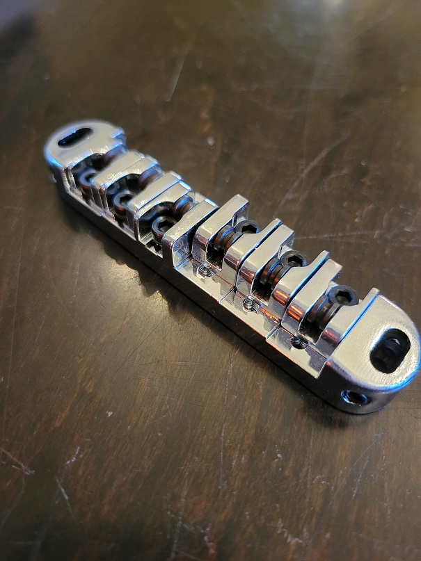

    Also thought of a couple of quick questions, how does everyone feel about the stock pickups and tuners? And I have this 'roller' bridge kicking around that I was thinking about using on this guitar. My understanding is that this type of bridge works well with guitars with detuners, but maybe it could negatively affect sustain? Any thoughts are welcome. Click image for larger version.

    I've never used the stock pickups as they don't give me the sound I'm after. The ceramic magnets make them too powerful for me, so I always fit aftermarket pickups. If you always use a fair bit of distortion then they will do, but I don't like the clean tones. And with a hollow body, where changing pickups isn't anything like as easy as on a solid body with a control cavity, if you are going to change pickups, then you may as well doing it during assembly.
    I'd normally go for IronGear or Tonerider pickups as being very good sounding and not expensive pickups, but if you want a more authentic Gretsch tone, then you'll have to look elsewhere. The pickups, rings and cutouts are standard humbucker-sized, whilst Gretsch pickups are a bit narrower, so you'd have to either get humbucker-sized Gretsch-style pickups, of find some wide adapter rings.
    The stock tuners are generally fine. I've replaced them on my builds because I've been generally going for vintage looks or wanted locking tuners, but I've fitted them as replacements on other guitars with grotty tuners and had no issues at all.
    For a guitar with a rear-mounting trem, I'd always suggest a roller bridge. You may possibly loose a little sustain, but not much. And as long as the rollers are lubricated from time to time and you make sure they don't seize up (which can happen), they can really help with tuning stability. I have a Gibson Flying V with a Maestro-style trem fitted and a roller bridge, and that stays in tune very well indeed. The Bigsby-style trem will reduce sustain to a far greater extent than a good roller bridge.
