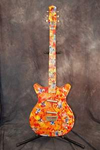

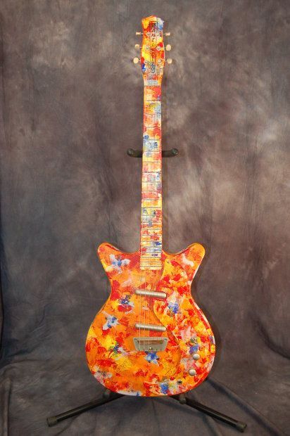

    A friend of mine has one of these Danelectros:

    Nothing to stop you at all.
    Wow. Looks like someone couldn't wait to put strings on before unwrapping their birthday present.
