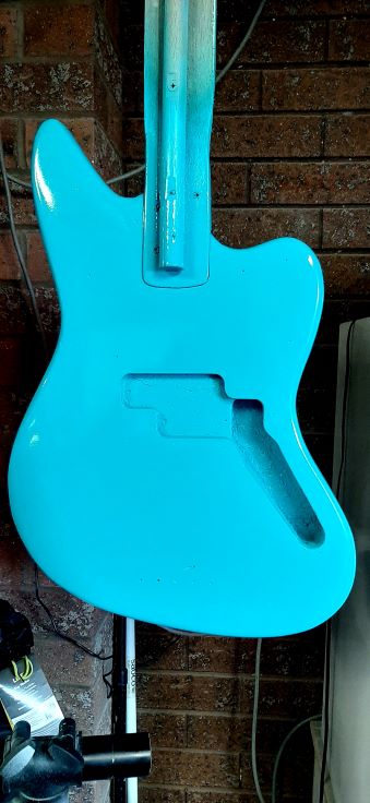

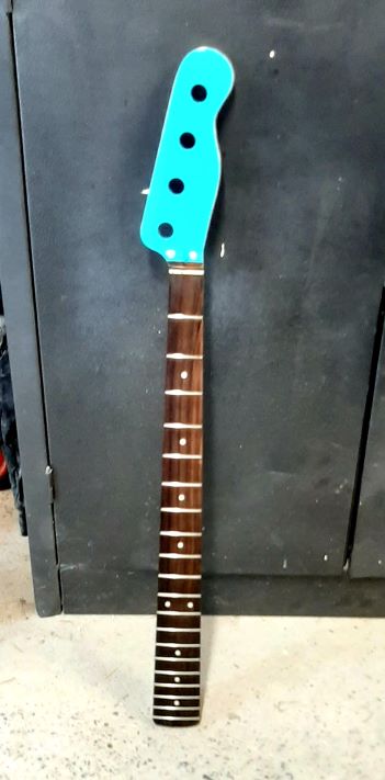

    Hey everyone,
    New to rebuilding basses, I`m currently remodelling my Squier Jag bass and having problems with spray paint. I have used Rustoleum 2X spray paint and its taking a long time to cure(gas out) any suggestions or success with rustoleum 2X.
    Also can`t decide between Seaside or Ocean mistClick image for larger version.
Name:	squier jag 1.jpg
Name:	squier jag neck 1.jpg
ID:	38971. I have a red tortoiseshell pickguard and a black pickguard.
    Cheers
    63 Bass

    Hey Bass 63, I sprayed my first guitar recently with ColorSpec acrylic, and was super keen to hustle along to polish, but the more experienced boffins on here advised me to just hang it for 4-6 weeks (I know!!) to let the paint properly harden.
    I just gave it a sniff every few days and basically waited until it didn't smell like paint anymore and then got into it. It took about 5 weeks for me
    Some paint brands take forever to dry properly.
    I got some cheap red spray paint on my JM-1 that's been hanging in the garage for over a month.
    I'll probably play it safe and leave it until (edit) March.
    Some of the SCA (SuperCheapAuto) range tends to dry fairly quick.
    Most of the paint aimed at Graffiti artists is designed to dry quick also.
    cheers, Mark.
    Rustoleum takes forever to out gas. It also reacts with the foam on most guitar stands, so just be wary of that. I used it on my first build and now that it's cured it's very hard, but I wouldn't use it again. For solid colours I'd recommend automotive acrylic.

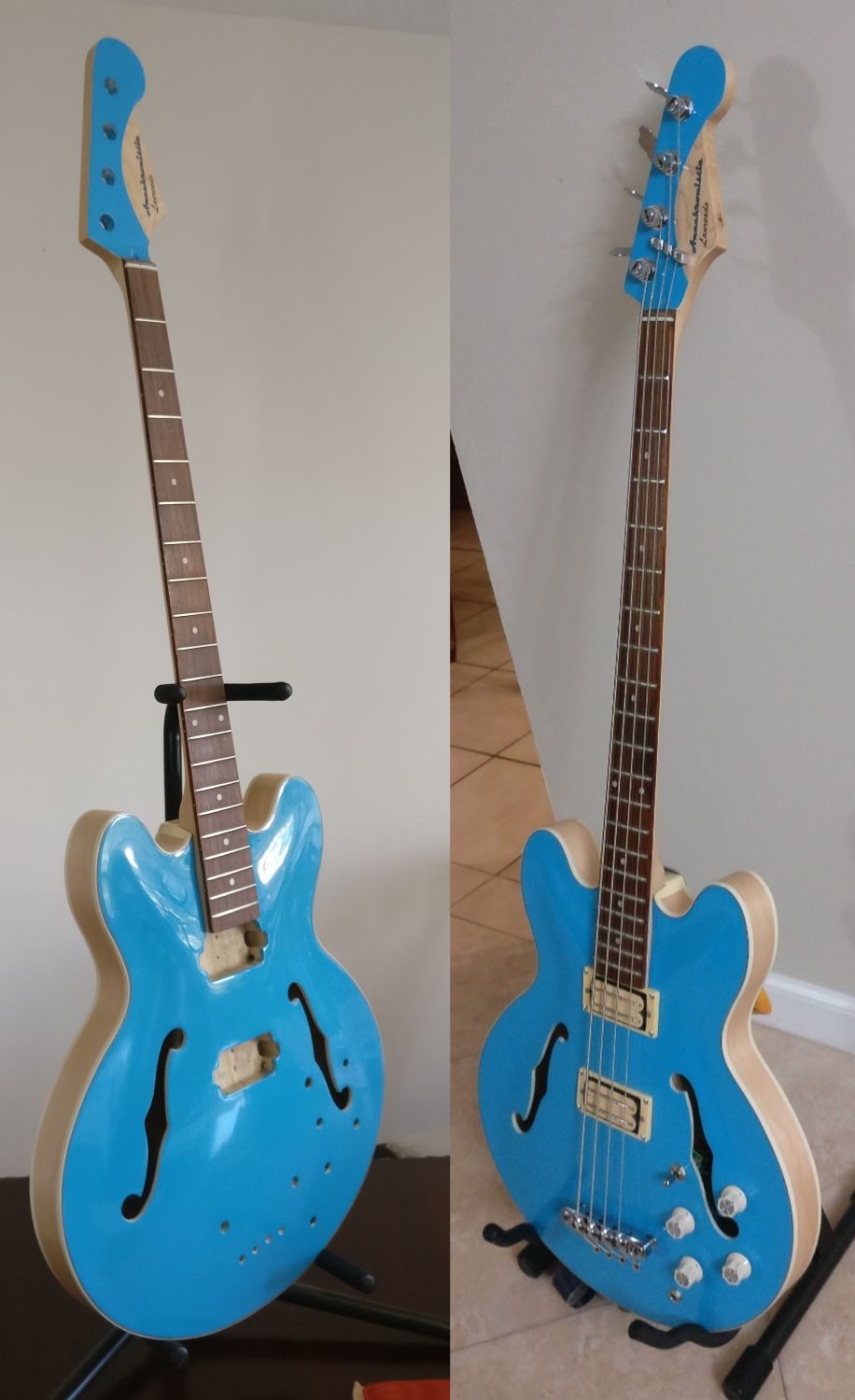

    I have done experiments with Rustoleum...which does eventually cure.
    Your blue looks really good, so if it ain't broke... So this is more of a FWIW. I used rattle cans on my last two projects, one that is a pretty similar color:
    I used MTN 94 paint. This stuff is great for someone who is not a good painter (e.g. someone like me). It has lots of solids so fills almost like filling primer, and it's actually hard to get it to drip. Sands flat easily. Its also a super flat paint, so the shine actually comes from polishing the top coat.
