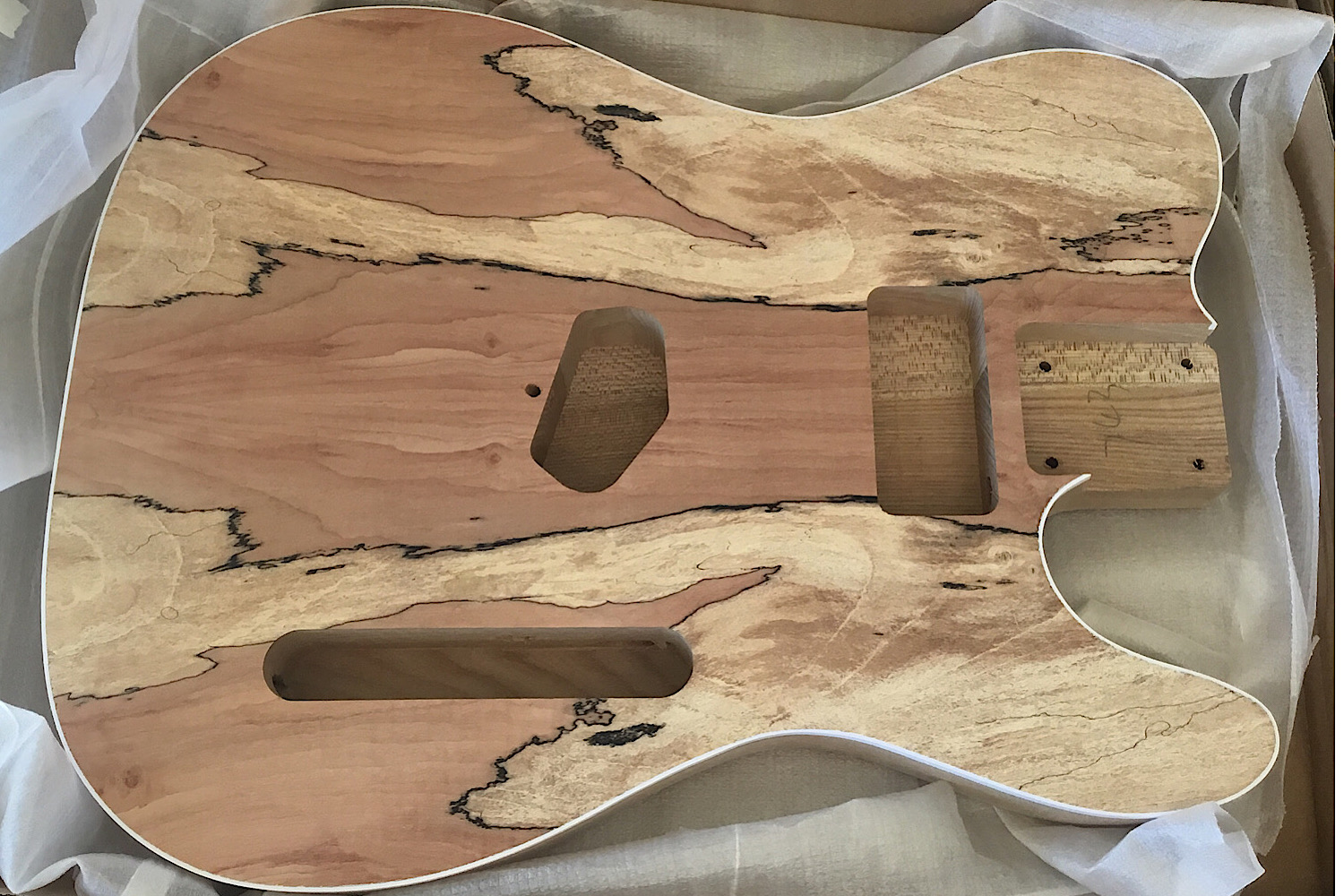

    Hi all, seeing as the old COVID has put a slow down on kits coming in to the country, I thought I would go for something different and available. I am going with a Tele with a spalted top and maple fret board. I picked it just on looks as I thought the spalted top in the picture was amazing. When it arrived I was totally blown away by the veneer. It Was even better than I thought. It came with a white plastic scratch plate which I am not going to use as it covers too much of the top. I also had a thought to get a different pick up for the neck position as the pocket is way too big for the little lipstick single that came with the kit. I am going to put in a Tone Rider hot90 P90 . I Am working on a couple of picks for my next post.

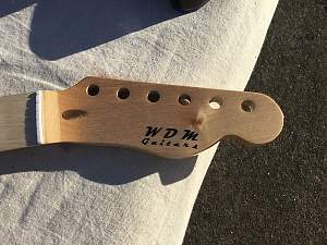

ID:	37212,Click image for larger version.

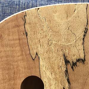

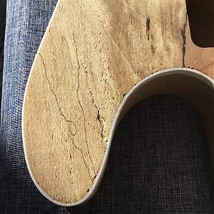

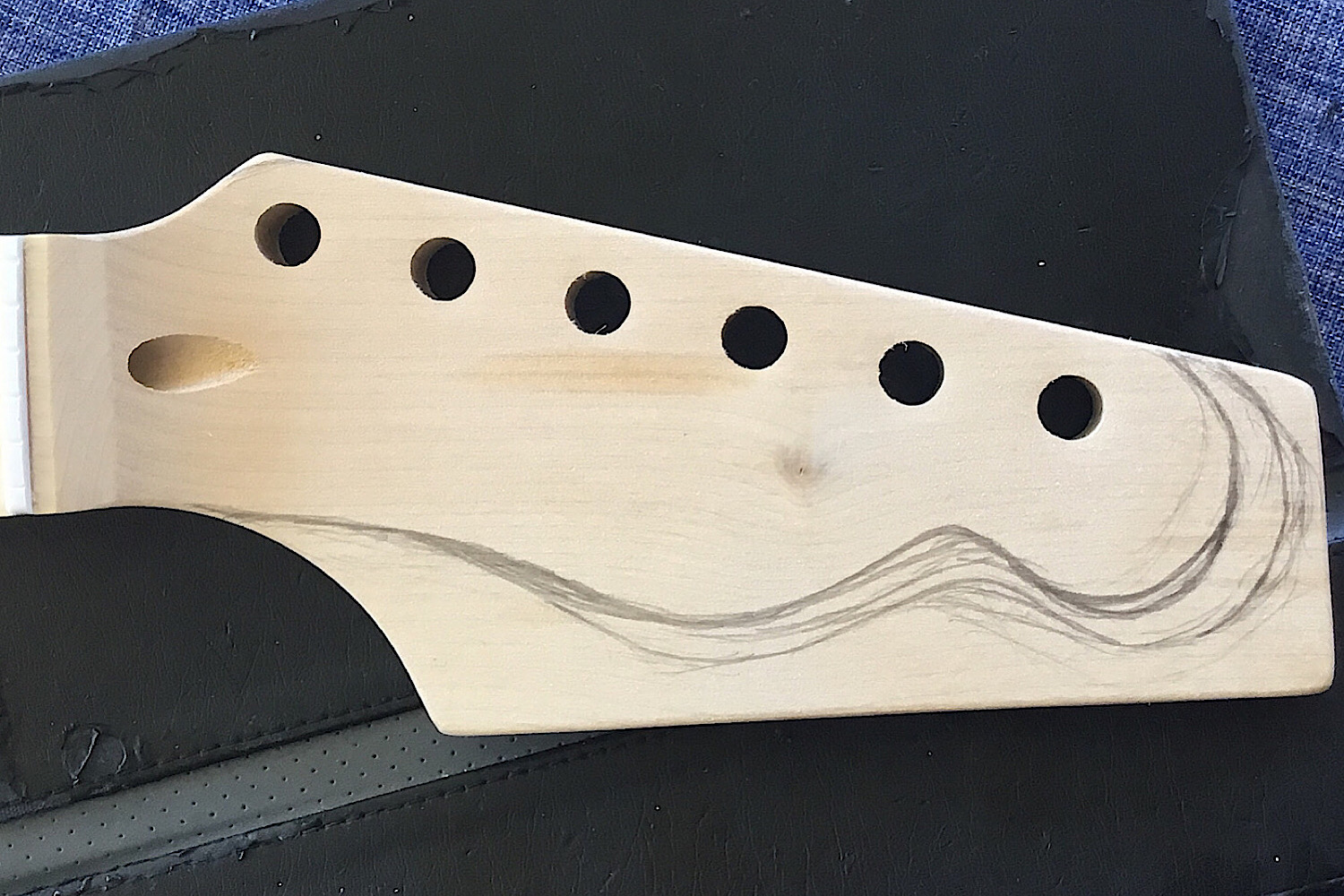

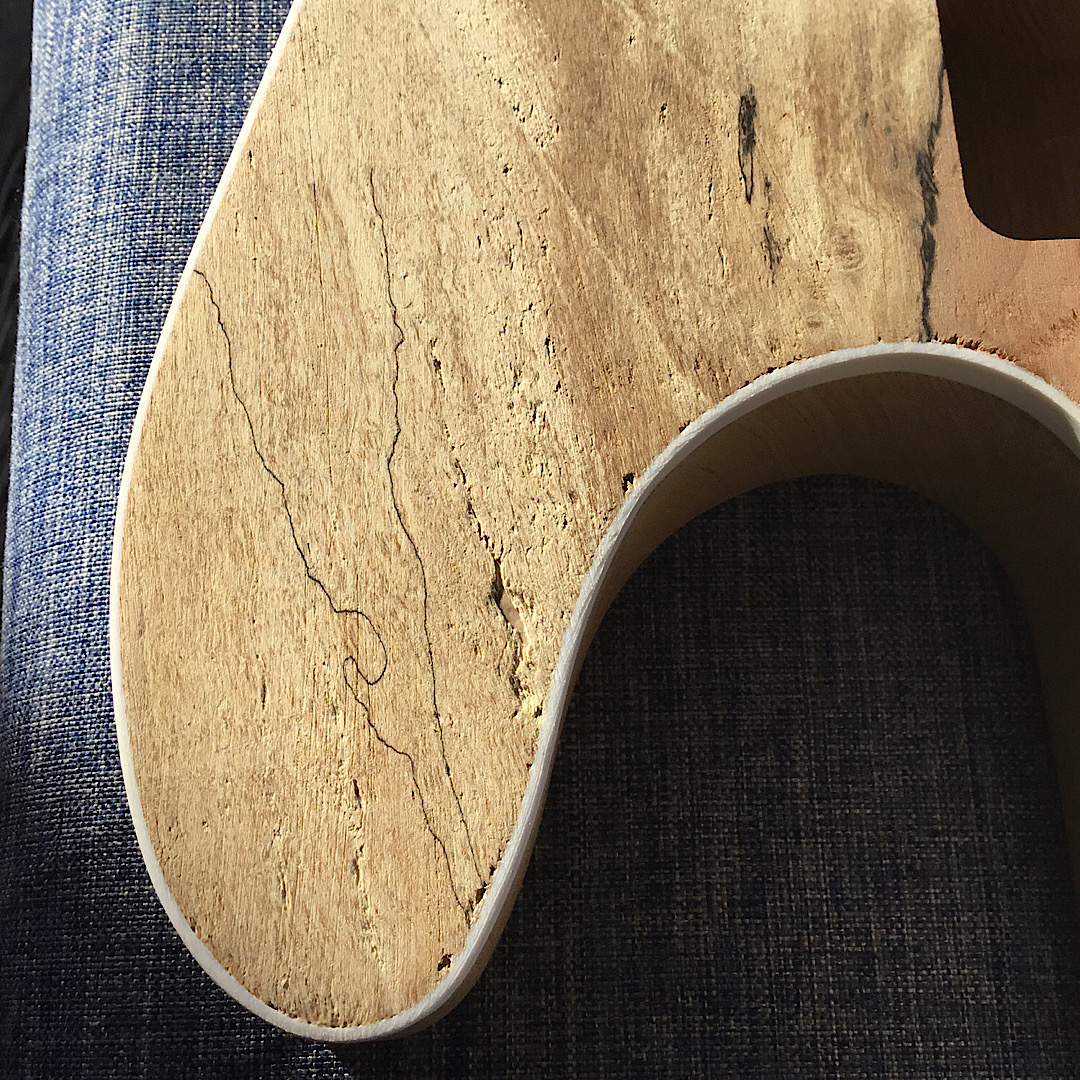

    Some pics of the amazing top and my hand drawn headstock.

    Nice figuring on that top. Look forward to seeing your progress.
    FWIW, if you're planning upgrading anything else like bridge; bridge pickup or 24mm pots, be sure to do a mock build and get any extra routing done before applying your finish. Some T kits will require adjusting the bridge pickup route in order to get proper intonation, and the control cavity route will need widening for full-size pots.
    Best of luck with your build!

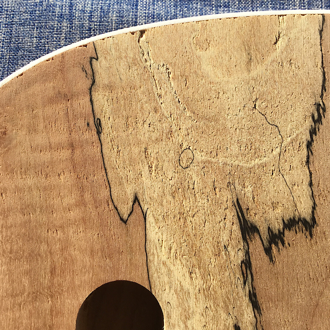

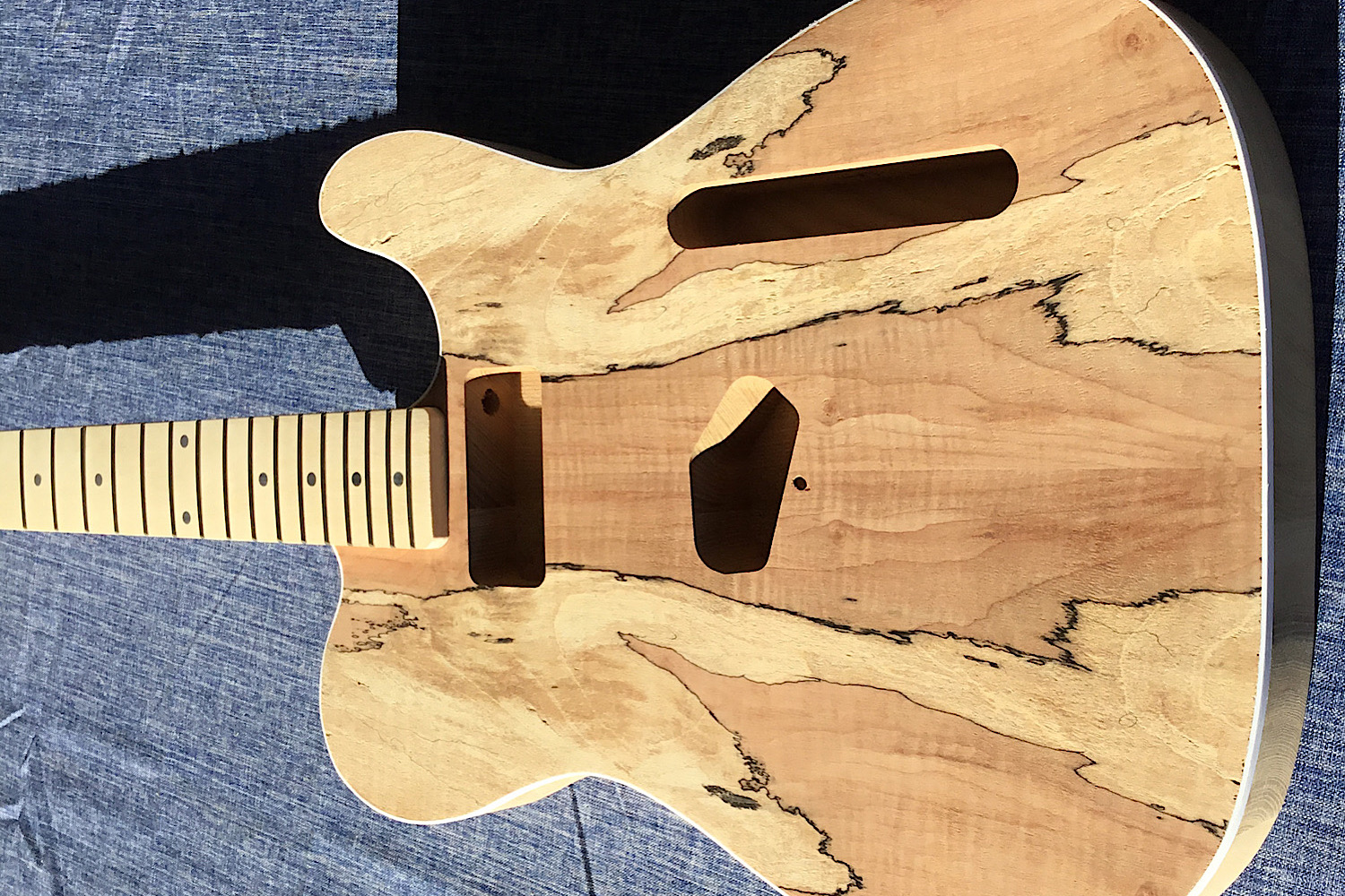

ID:	37243,Click image for larger version.
    Some really rough grain on the top, I did a bit of grain filling On the body and top, I had to get 2 different colours,a lot of sanding but worth it.

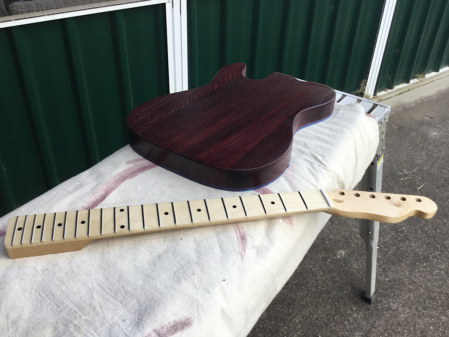

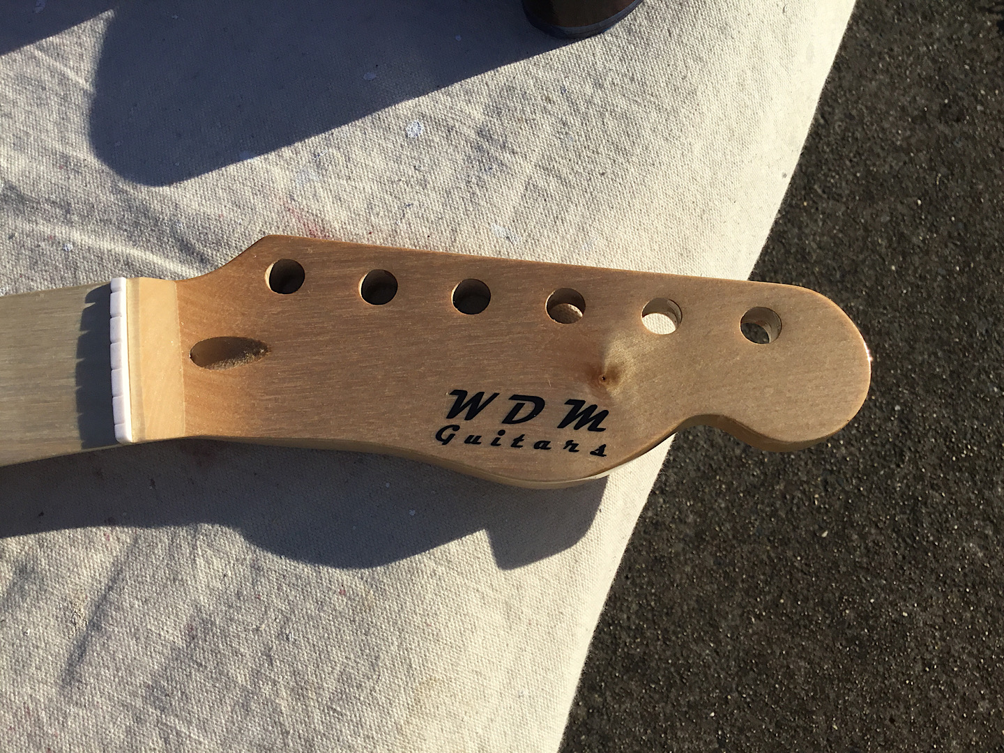

    Member Wayne.Mumford's Avatar
    CAMPBELLTOWN NSW
    236
    Hi all, a bit of progress today, first coats of poly on body and neck. Also got the logo on. A beautiful sunny day today, a couple of quick coats of wipe on poly during my breaks from painting my house. Being a painter , I don’t usually get a chance to do my own place but it really needs it, so the wife says.

    That's good progress in two days.
    What colour is that stain? It's kind of brown, but also kind of purple. I like it!
    Mahogany. Mahogany stain tends to have a fairly high blue content, rather like a wine red.
    CAMPBELLTOWN NSW
    236
    Thanks Simon, you’re quite right, it is mahogany, one coat was enough as it is very dark. I used it on my first build (ES-3)but reduced the colour by half. I got another couple of poly coats on today, slowly building up the finish. Unfortunately the headstock logo didn’t take as it was peeling on one of the corners but luckily I have few extras, I will give it another go tomorrow. I left it overnight before coating it but it might not of been long enough.
