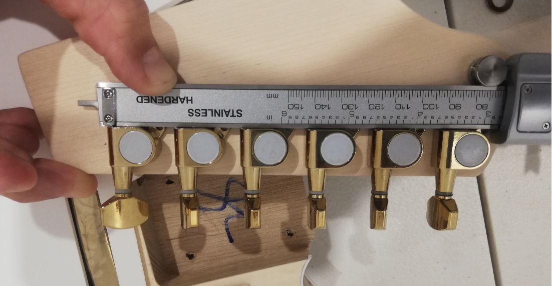

    I have done a small mock-up build and taken some pictures in the process.
    - Headstock heel looked a bit off, she was indeed ( 1mm left from right in thickness), Adam said would not be a real issue, sitting in the neck-pocket she is only .5mm off.
    - Neck sits loose-ish in the pocket (see picture), Do you guys think I should file in that corner a bit?
    - Tuner holes seem pretty darn straight!
    - ow and sjeezs, I did pick gold! Pretty pimp, but I trust myself, I probably had a vision
    Hey Rolf. Welcome.
    As for neck fit, that looks more than acceptable to me. If that little bit of difference in the matching of the radii bothers you, you could file it, but don't create a situation where you risk making it worse or creating something else you have to fix. Personally, I'd leave it. Especially if you're going to have a pickguard on there. The joint will be covered.
    Here is an excerpt from another post I contributed earlier in the week re: neck fit. I'm too lazy to re-type it all again
    That joint looks fine to me. There is nothing to worry about there structurally or sonically IMO. As for appearance, the pickguard should cover up that joint. And don't forget, you will have a build up of finish on the neck (even if very slight) when you do the final assembly.
    With a screw-fixed neck you don't want a fit where you have to force the neck into the pocket. You want it to basically "drop in" maybe with a little downward pressure, but that's it. A little space on the sides is a good thing.
    This does two things: allows for expansion with humidity changes, and allows for neck adjustment/string alignment.
    The more important fit is the mating surfaces of the bottoms of the neck pocket and the heel.

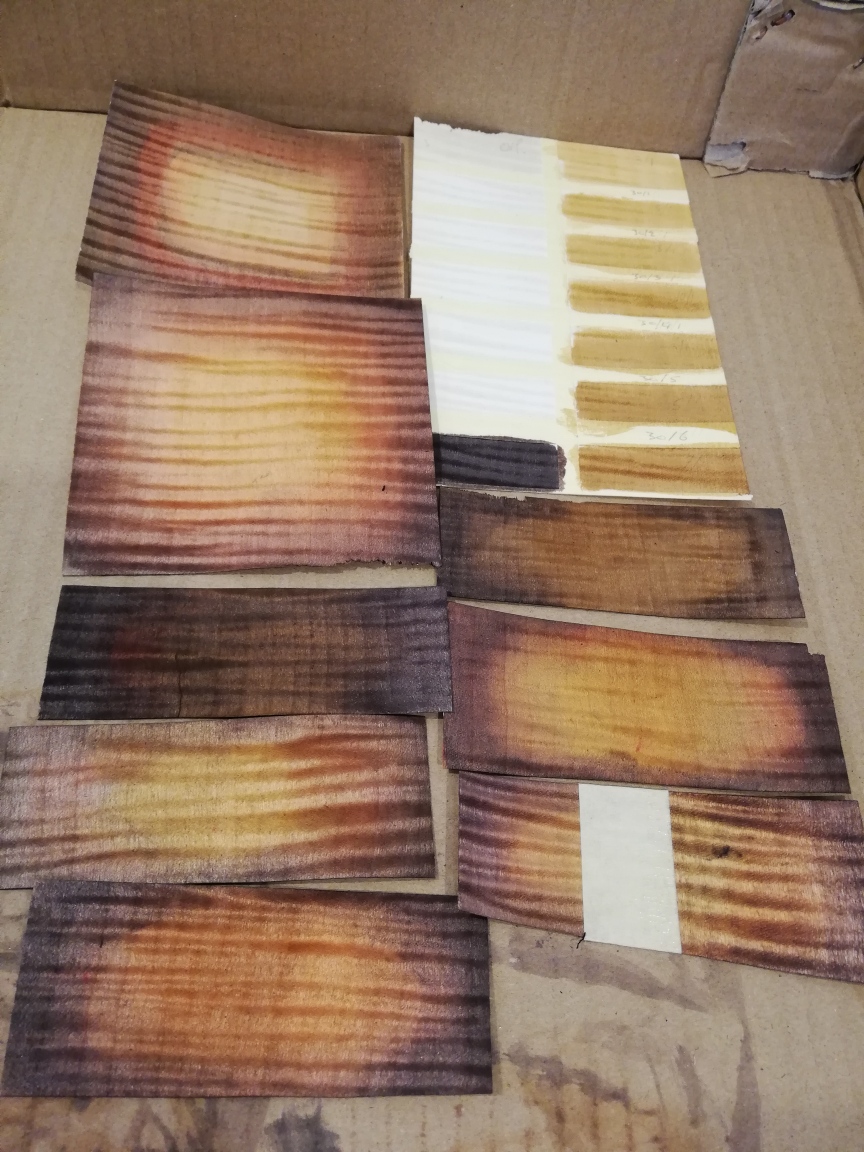

    I removed glue spots, slightly touched up the neck joint to make for a better connection. I decided to bolt down the neck for the bridge placement as it was so loose in the pocket that I did not want to risk the neck sliding in a different position and the strings running of the neck. Other than that, I have made some staining samples. I had ordered a couple of headstock veneers and Crimson stain shots. Because there is no description or reference on the mixing ratio痴 I went through it adding a drop at the time. See pictures for the samples, You see I am going to aim for a violin type of burst. After trying different methods I did find the grain pop best after using a light brown wash, lightly sanding it back and applying the burst. This goes against the advice, anyone with a positive result though?
